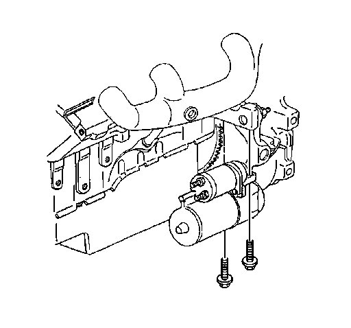

I turn the key and the engine makes a noise like it is about to turn over but then doesn't. I then hear the starter spinning (sounds like a vacuum/no grinding) which stops a second or two after I stop turning the key. From what I can tell from my research is that the Bendix is spinning but not engaging the fly wheel. I was able to get it to turn on after about 15 minutes by repeatedly turning it until it finally caught and barely turned over. Since the starter is spinning I don't know if my solenoid is bad because if it was I don't the the starter would spin or if the Bendix is just clogged up and not fully engaging. So do I need a whole new starter or is there an easier fix?

Honestly, trying to fix starters anymore isn't worth the effort. By the time you get the parts, put it together, and pray it works, you could have gotten a new one.
Based on your description, it does sound like the Bendix isn't engaging. Since it turned slow when it did finally engage, I suspect the starter itself is going bad.
Here are a couple links that explain how one works and in general how one is replaced:

Removal Procedure
pic 1
1. Disconnect the negative battery cable.
2. Raise the vehicle. Refer to Vehicle Lifting.
3. Remove the flywheel inspection cover bolts.
4. Remove the flywheel inspection cover.

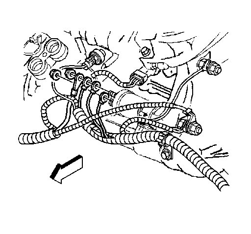

5. Remove the electrical connections from the starter motor.
pic 2
6. Remove the starter motor mounting bolts.
7. Remove the starter motor.
