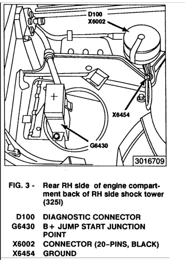

There is a port (below) that a BMW scan tool can connect to to read any codes the car will have. It sounds like we have a sensor or a injector that is shorted but to tell whats going on we must read the codes.
Here is the post I am talking about
Here is the tool adapter
https://www.amazon.com/ASSEM-BMW-Round-Diagnostic-Scanner-Adapter/dp/B00VACZMRI/ref=sr_1_5?ie=UTF8&qid=1502903910&sr=8-5&keywords=bmw+obd+1+code+tool
then we can read the codes like a normal OBD2 car

So I attached my OBD scanner tool to the plug inside the engine compartment - by the left side (passenger side). I turned the key to the on position (to the position just before engaging the starter) and a Communication error was all I got on the OBD unit.
BUT the other big thing that occurred, which I didn't pick up on right away, was fuel was pouring out of the front of the mass air flow sensor (I knew it was fuel because I put my finger in it and smelt it) - right where it joins the air box. Also the fan (I saw that the car has two) right behind the front grill (as opposed to the one coming off the engine) was on when the key was in the ignition, turned on but the engine not running. The fuel was pouring out of the location above with the key in this position (on, but no engine running so that the lights were on, dash board lights were on, etc). Having removed the air box and turned the engine on again I confirmed that fuel was coming out from inside the mass air flow sensor. I hope that doesn't mean that the entire intake manifold has been filled with fuel. I am somewhat puzzled as to how this occurred as I labeled all the items I had to disconnect, albeit with colored tape and nothing else - no notes on the tape. I didn't think that I would get anything mixed up!

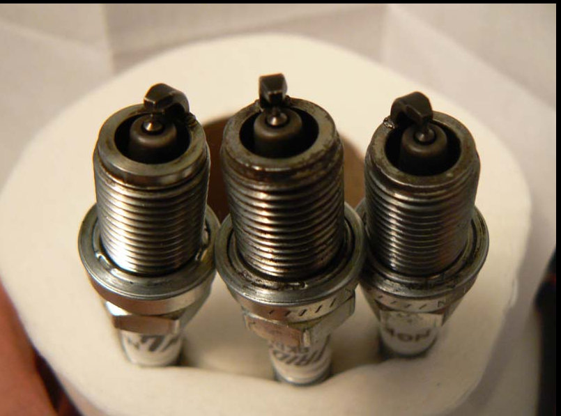

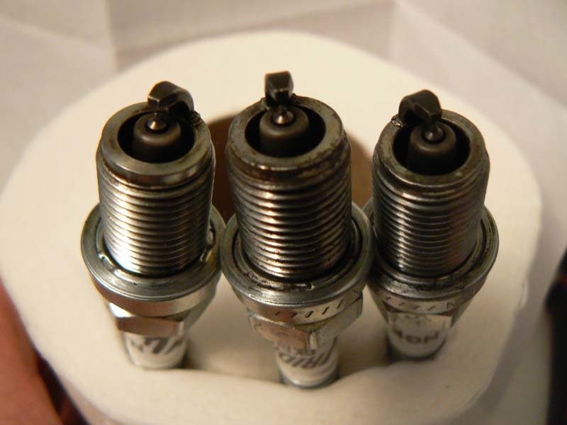

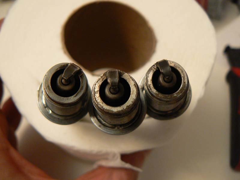

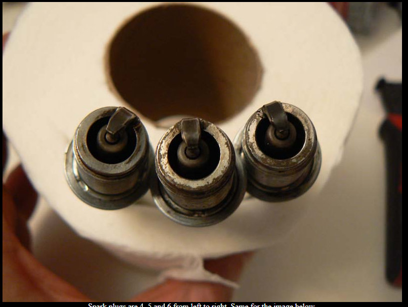

Before doing anything with the spark plugs I checked to see where the fuel was coming from (without the OBD scanner plugged in) and found that the fuel was coming out of the inlet manifold. Looking down through the butterfly valve I could see a lot of fuel just sitting there in a puddle. Also when just turning the ignition on, without turning over the engine, the fuel pump was pumping fuel and it was coming out of this area so fuel was going into the fuel rail and somehow making its way into the inlet manifold and out through where the throttle body attaches to the inlet manifold. There were no leaks anywhere else.
Well..... after taking out all the spark plugs I saw that 1, 2 and 3 were wet. 4, 5 and 6 were quite dry in comparison with 4 being the only 'clean' one. 5 and 6 had what looked like rust on the edge of the spark plug - which is strange as they were all cleaned with a scotch brite pad to the point of being nice and shiny (I have added images of spark plugs 5 and 6 compared to no. 4. Spark plug. 5 and 6 are the only ones to exhibit this 'rusting' characteristic).
After taking out the spark lugs I looked down into each cylinder with a bright LED flashlight and did not see any wetness - they 'looked' dry.
So next, I turned the engine over, after taking the fuse out for the fuel pump, to put the pistons in different positions to get a better view of them - this is when the real problem revealed itself. As soon as the engine turned over a very large plume/spray of fuel came out of one of the cylinders. I stopped immediately and went to have a look. ALL the cylinders had fuel in them - to the degree that when I moved the car I could see the fuel sloshing around in all the cylinders. I double-checked each cylinder again for this and found this to be the case.
I have checked the fuses and they all seem to be fine. But I will check more thoroughly. Does that mean that the ECU has gone??? That's the only thing I can think of.... as somehow the signal is not getting to the injectors and/or the spark plugs.
A word about the injectors - when cleaning them I rigged up a switch to activate them. I basically bought an injector socket that fit this particular type (EV1) and wired up a manually activated thumb switch. When the switch is connected to the battery and the button is pushed it opens the injectors. Each injector was operating fine - in that when the button was pushed it opened the injector and the cleaning fluid I was using (via a syringe, hoses and barb connectors) was able to come out. When the button was released the fluid stopped coming out of the injector. I could also hear the clicking of each injector I was cleaning opening and closing.
This is turning into something that is not very good for me. Mind you I am learning a lot!!!! Haha!
The spark plugs are placed 4, 5 and 6 from left to right
PS. Thinking more on this it seems that the injectors are working but the spark plugs are not getting current to them otherwise how can all that fuel have gotten into the cylinders? If I found that they worked when cleaning them there must be either a signal that is making them stay open or there is no current going to the spark plugs, or am I missing something?

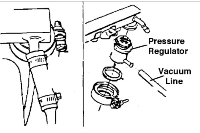

I don't know why I didn't think of this before but pull the vacuum line from the fuel pressure regulator to see if fuel is present. Here is a diagram (below).
PS I uploaded the images for you what format where you trying to load?
Sep 5, 2017 at 4:40 AM
CHRISTOPHER SA
  • 255 POSTS
Hi Ken,
Getting to that vacuum line is not going to be easy as it is right at the back of the fuel rail but I will see what I can do.
Check out the images below
Sep 5, 2017 at 5:41 AM
  • 55,748 POSTS
They look clean but I would go with new just to be safe and know they are not a problem. They can still short out down the electrode.

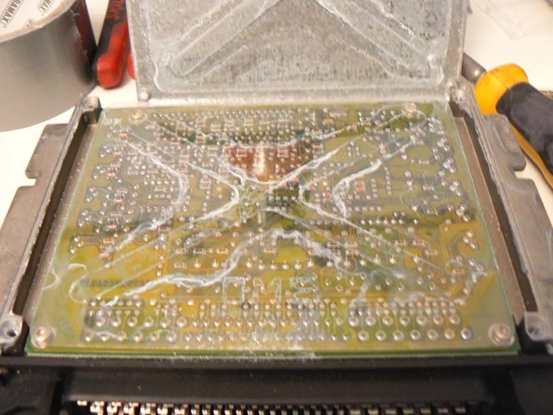

I suspect, as you do, that it is the ECM unit sending incorrect signals to the injectors and keeping them all open, as that is the only thing I can think of that is happening due to the large volume of fuel coming out at once.

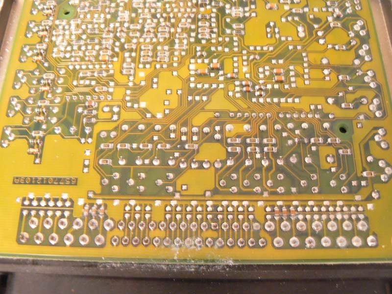

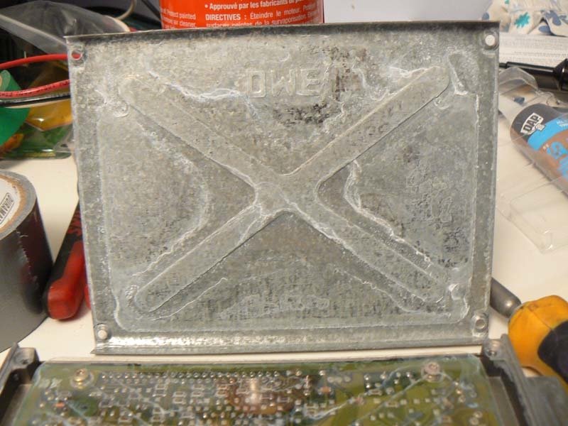

As we suspected all the injectors are open when the key is turned to the on, engine off, position and gushing out fuel. A note about the injectors.... all the injector pintle caps either came off and went into the engine cylinders or got stuck in the inlet manifold which is why you can see the bare metal of the injector ends. Which means more work for me to find out where they went. This should not have happened and I will be contacting the seller of the injector refurbishment kit. Also, I missed showing number 4 but that too was spraying out fuel.
I suppose the good news is that the spray of all the injectors looks very good and consistent across the board! So apart from the pintle caps coming off they look as good as new!! ;)
I have found a place in Illinois where they will refurbish my ECM/ECU for $218 or do you have a better suggestion?
One thing about the injectors I forgot to mention.... the black grounding wire that bolts to the front of the engine (engine block VANOS area - 13mm socket head bolt) that comes from the wiring loom for the injectors was not attached to the vehicle (so that I could raise the injector rail up). Would this have mattered? Thinking about it I don't think that would have but wanted to check with you.
I have lost about 15 gallons of fuel without driving anywhere since filling up my tank back in July and figuring this out just now. Amazing!
Just a quick question as this is puzzling me.... is a failure like this normal? Can an ECU/ECM fail in such a way and cause such problems? Or can it be due to an electrical short? I keep thinking about how this problem first started - it was raining very heavily and have been wondering if this somehow caused an electrical short to occur on the chassis somewhere and caused this problem.
Studying up a bit more on this here is a forum thread that talks about this issue that someone had on their car - it seemed to be a ground fault. Not sure where I would start with this on my car though. Here is the forum link: http://forums.nicoclub.com/injectors-spray-all-the-same-time-t553320.html

Hi Ken,
I tested each injector individually and each one by itself opened when the key was turned to the on, engine off, position, spurting more fuel out - just like before. I didn't bother testing the injectors electrically. I removed the ECU/DME and just prior to packing it up to ship to be repaired in Illinois I opened the unit up. I found some water damage on the bottom of the unit as can be seen in the pics below.
The first image is the inside of the bottom casing. The second image is the staining that has occurred on the plastic that sits between the casing and the circuit board. The third image shows the water damage to the circuit board which can be seen at the bottom of the image where there is white stuff on it.
There was probably a short of some sort and has blown one of the transistors in this area. The other side of this circuit board is where a lot of the chips are situated for this unit.
All this fits with the information I came across about what happens to this model of BMW when it rains very heavily. When rainfall is exceptionally heavy water gets into the computer compartment due to the drainage system (the lip) around the hood area not being high enough with the result that too much water flow can overwhelm the drainage system and enter the engine compartment, usually making its way to the computer compartment first. This is a known fault/problem by BMW. I will have to ring them up and find out if there is something they can do about it as I read that there is a kit that they can install.
And remember I mentioned way back in my first post that this problem occurred after a very heavy rainfall. By the time I came across this info and looked inside the computer compartment the water had evaporated (it did happen after all at the beginning of summer back in May)!

Two things, I would try connecting he ground wire because that can cause problems with the ECU and yes an ECU can short out causing all of the injectors to come on at the same time. The price is good do you need to send yours in, do they rebuild yours?

Hi Ken, I got an email today (26th Sept) saying that you had posted a response. There seems to be something wrong with the pages as the last post I can see is from the 17th September. This means that the post and pictures I put up about the DME/ECU is not able to be seen by me either (and I am logged in). Also most of the videos have disappeared and the only one left is the one from the 17th September. Can you correct this and let me know when it is fixed so I can see what you wrote?

Hi Ken, Thanks for that. I did try re-connecting the ground wire and that didn't help. I sent off the unit and, yes, they rebuild it, replacing any transistors that have gone bad and reflashing the system OS.

Hi Ken, I just got bad news from the repair place. They said it was so badly water damaged that they couldn't fix it. So I am looking at getting a new one that may set me back up to CDN$1700!
