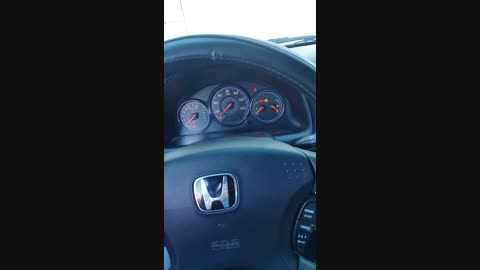

Hello, my car has new battery, starter, alternator and ignition switch. Yesterday i had the head gasket, timing belt and water pump replaced and started up fine.
I have attached video

Thanks for the video, sounds like it has good compression so we can rule that out. Can you turn the key to the on position without cranking engine over to see if you can hear the fuel pump in the tank kick on for five seconds? Here is a guide that will help us get started:

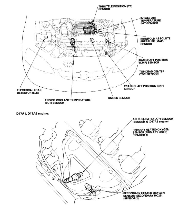

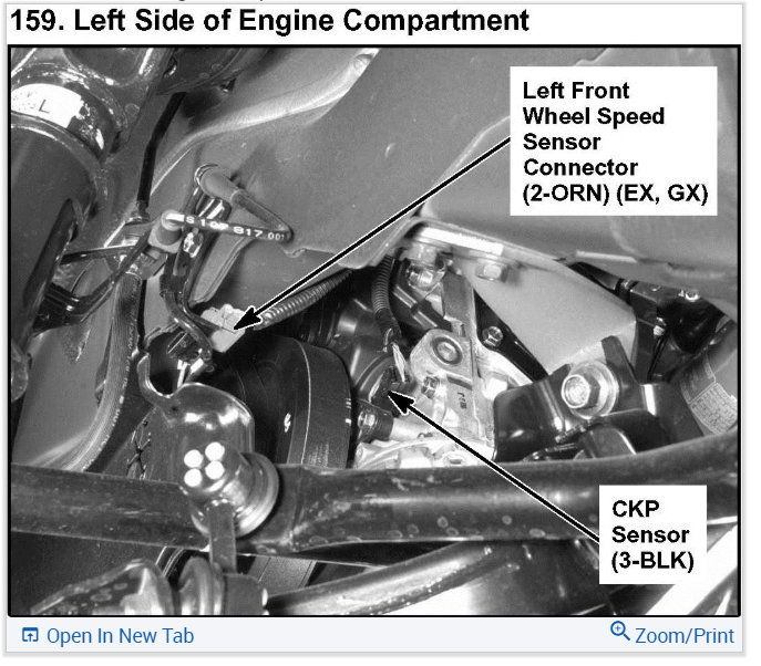

I have seen crankshaft angle sensor cause this issue. here is a guide that will walk you through the steps with diagrams below to show you the location for your car. When they fail they don't leave a trouble code BTW.
Check out the diagrams (below). Please let us know what you find.
