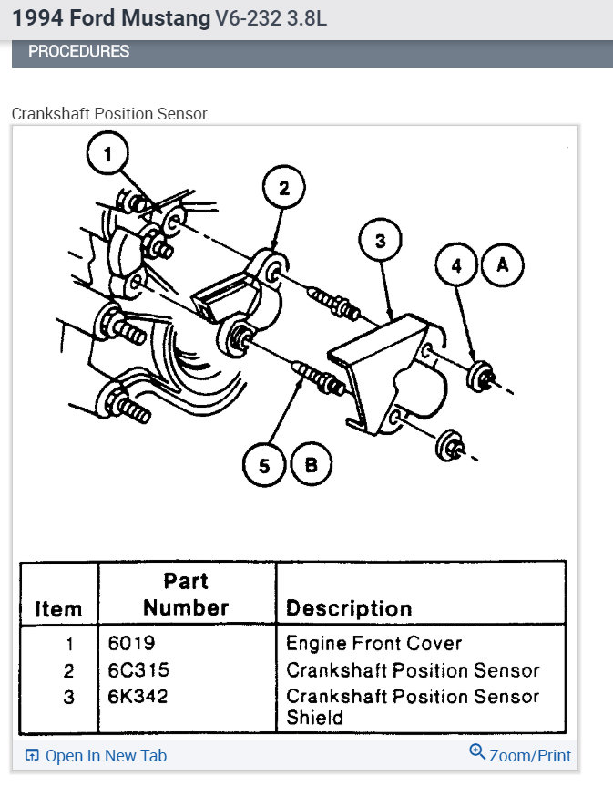

When i turn the car key on only the battery light pop's up. Fuel pump wont turn on. No spark from the spark plugs. And injectors wont pulse. I have already change the computer and the (CCRM). What can be the problem?

It sounds like the crankshaft angle sensor has gone out. here is a guide to help walk you through the steps and the location of the sensor for your car is in the diagram below:
This guide can help as well

I got it stared.
I run a hot direct wire to the PCM.
I guess there was a shortage in the hot wire somewhere.

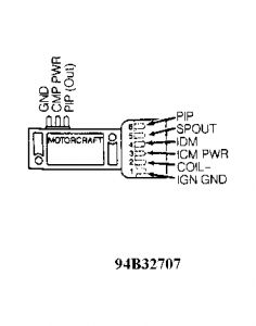

I have a 94 gt mustang car wont start , i changed the tps, iac ,eecm, ignition relay fuel pump and filter, fuel pressure reg, turns over strong but wont start if I take out the spout chip it starts but runs bad put the spout back in car dies and wont start back up, help me please.

Do u have an ignition control module mounted on the distributor I would check /change it

i have changed the ignition control module its new as i stated in my question, like i said it will run if you pull the spout put the spout back in car dies, My ignition control relay and the spout are located on the passanger fender well under the air filter.
