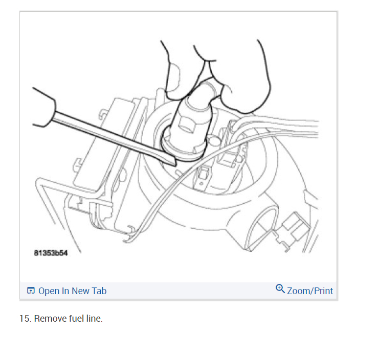

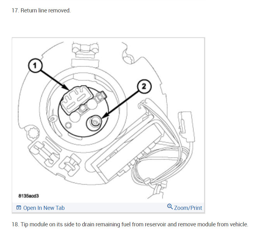

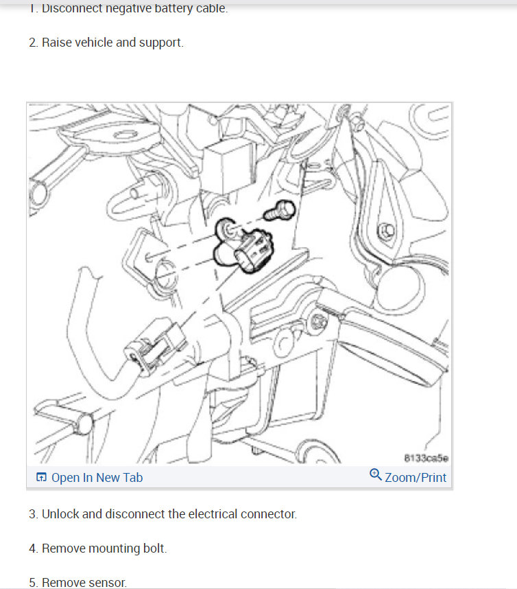

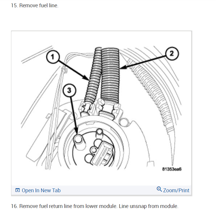

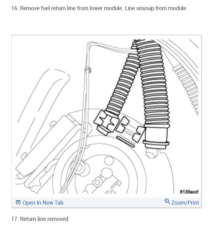

When you crank it over, does the tachometer show RPM while cranking? Trying to see if the crank sensor is working.
https://www.2carpros.com/articles/how-a-crank-shaft-angle-sensor-works
Can you hear the fuel run for 2 seconds with the key on?
I would also check the compression to be sure the timing did not change.
