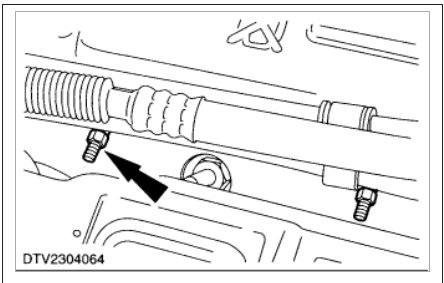

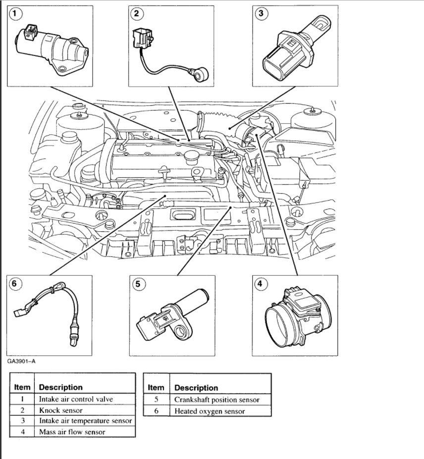

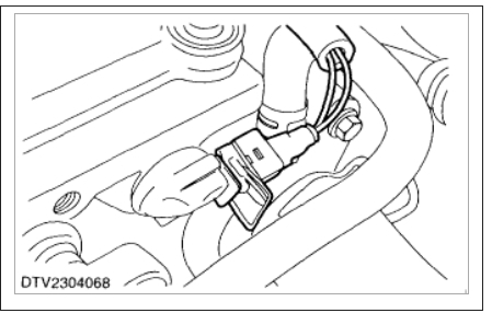

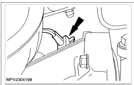

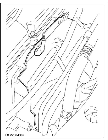

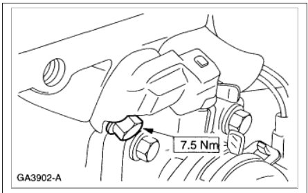

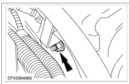

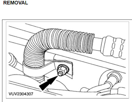

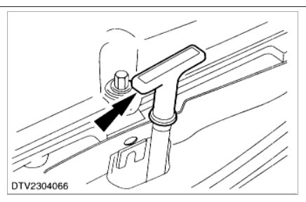

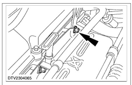

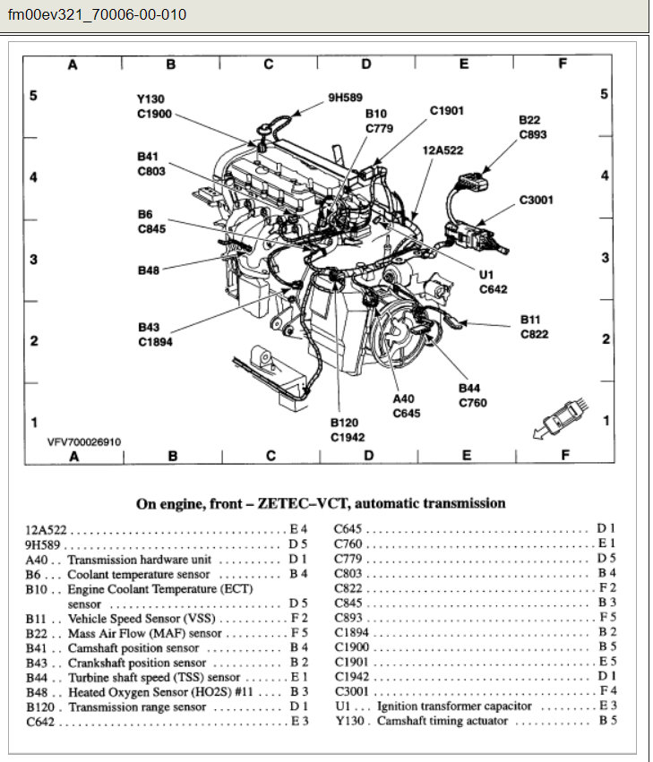

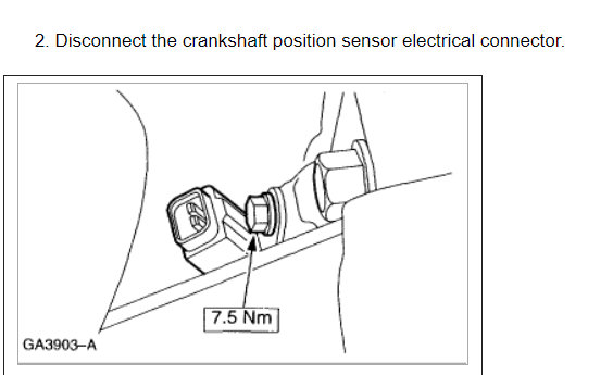

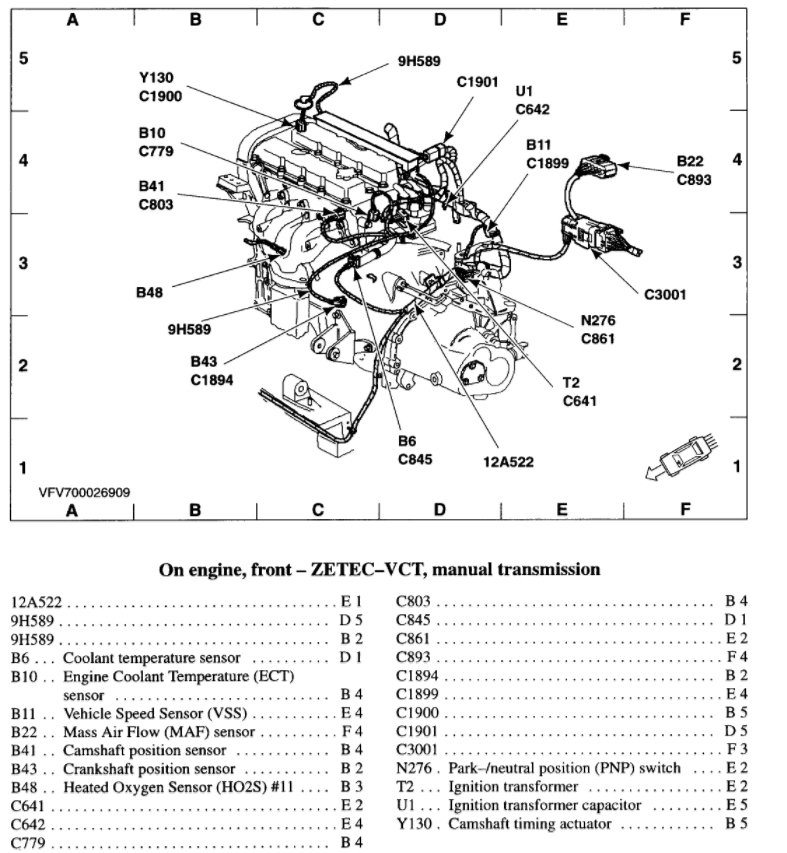

Where is the wires to the crankshaft sensor and cam sensor?
Feb 18, 2018 at 11:16 PM
  • 55,097 POSTS
Hey Mat!
How you been? Seen you on the site before.
Here are two guides to help you see what you are in for when doing the job and to get the problem fixed:
and
https://www.2carpros.com/articles/camshaft-angle-sensor-replacement
Here are the crankshaft and camshaft sensor locations for your car.
