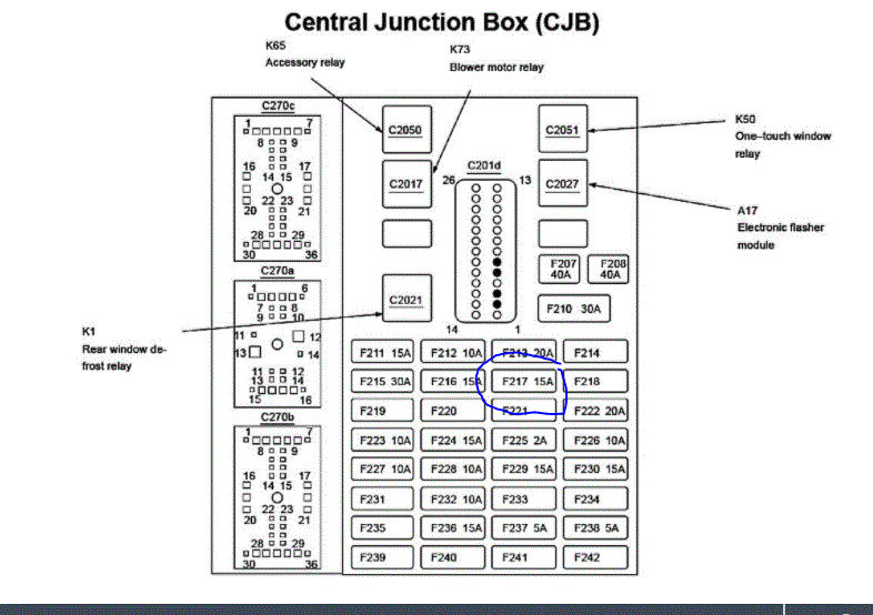

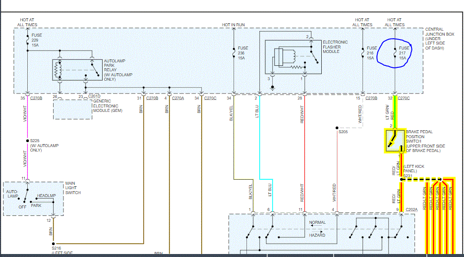

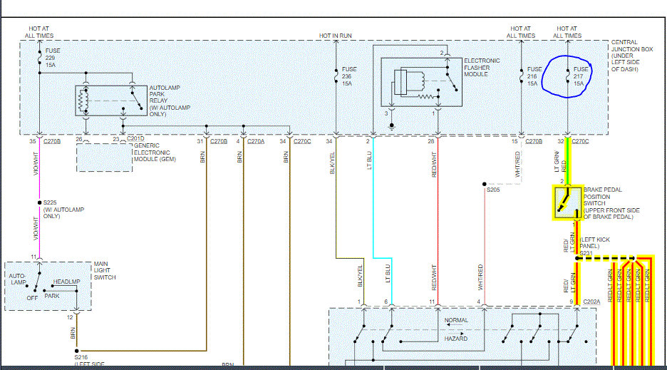

Good afternoon,
I attached the wiring diagram for you to view.
Fuse 217 is what controls the power to the brake light switch. Check for power at the fuse with your voltmeter.

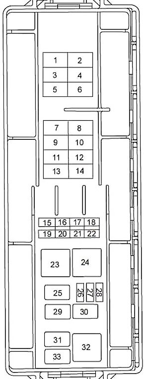

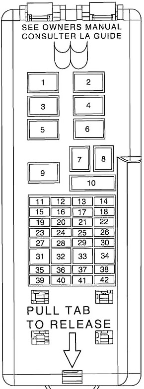

The pictures you send above don't look anything like fuse box on my car listed above. I have attached 3 pictures below (2 are the same).I'm not sure which off the fuses are for the brake switch.

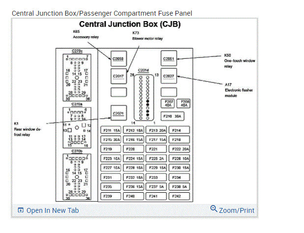

I attached a picture and the location of the fuse block.

Roy, the fuse box you show above does not match the fuse box I'm seeing on my car. There are pictures above of what my fuse boxes looks like, I just need to know what fuse controls the brake light switch.

You need 12 volts from the fuse number I listed that goes to the switch in order for the switch and the interlock system to work.

I agree. The diagram I sent you identifies te number fuse for the switch.
Once you get power to the switch and you step on the brake, the interlock solenoid will work and release the shifter.

See the attached diagram of the passenger and engine compartment fuses. These diagrams look nothing like the diagram you sent me??
I still don't know what fuse to look at that controls the Brake light switch, I checked most of the fuse in the attached diagram that sounded like they had anything to do with the Brake light switch and they were all okay.
So my problem is still; not getting any power to the brake light switch, and I think this is causing my brake lights not to come on and not being able to shift out of park.

I am doing my best to help you but you have not located the fuse box for the switch.
The fuse panel is located below and to the left of the steering wheel by the brake pedal. Remove the panel cover to access the fuses.
The picture I attached is the correct application for your car. Without being there, this is the best we can do. If you have your owners manual, chck for the location and a picture in the manual.
