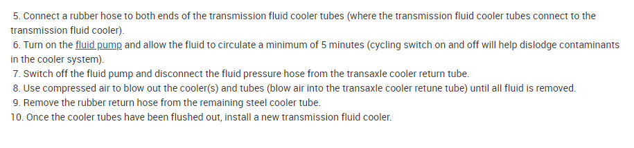

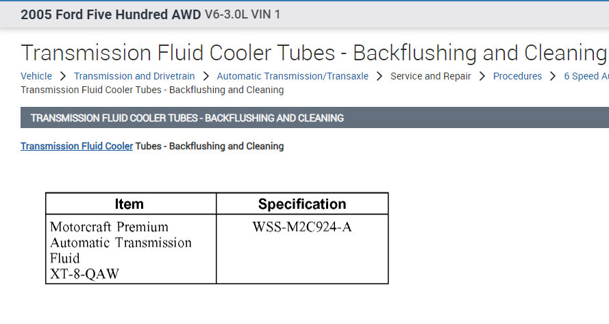

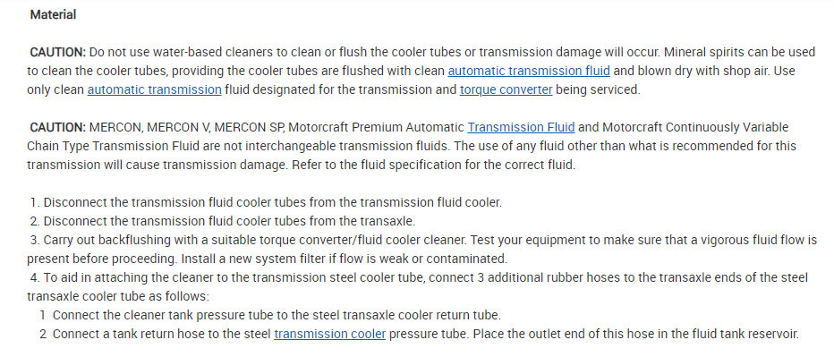

If there is a brake caliper issue, the RPMs wouldn't jump. I suspect what you could be smelling is the transmission (clutch plates).
Have you checked the fluid condition and level? If the fluid is clean and full, then I suspect (based on your description) that you have a transmission cooler that is plugging and causing line pressure to drop.
If the pressure drops, the clutch packs/clutches will slip causing that smell.
If you feel it is a brake issue, after driving the vehicle, walk around it to see if there is excessive heat coming from any of the wheels.
Here is a link that explains in general how to check transmission fluid:
https://www.2carpros.com/articles/how-to-check-and-add-transmission-fluid
I attached the cooler back flush procedure below. Let me know if that is something you are comfortable performing.
Take care and let me know what you find.
