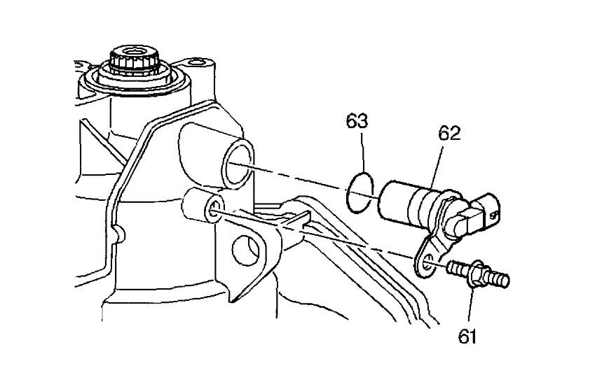

I took my car to for a routine oil change and as soon as I pulled out of the parking lot, my car wouldn't shift gears. The car was running/shifting perfectly fine before I took it there. Now it won't shift out if high gear. My boyfriend has added four quarts of transmission fluid and it still won't shift properly. Is it possible that the mechanic mistakenly drained the transmission fluid?

He added four quarts so far. And yes, I did return to the oil change place. They told me there was no way to get to the transmission fluid without going to the dealership, which was obviously a lie. Then they told me the transmission fluid was burnt and black. They told me because the transmission fluid was never changed, my transmission fluid had burnt up. The check engine light is on, but we would have to check the code.

Definitely. By they way, the speedometer doesn't work now either.
Dec 25, 2018 at 1:28 PM
Okay, that is most likely the reason it will not shift. without the speedometer working, the PCM will not know the car is moving and cannot tell the transmission to shift.
Have them check the vehicle speed sensor to see if it is connected. when they changed the oil filter, they were right at this sensor.
