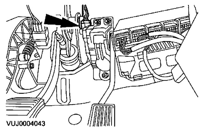

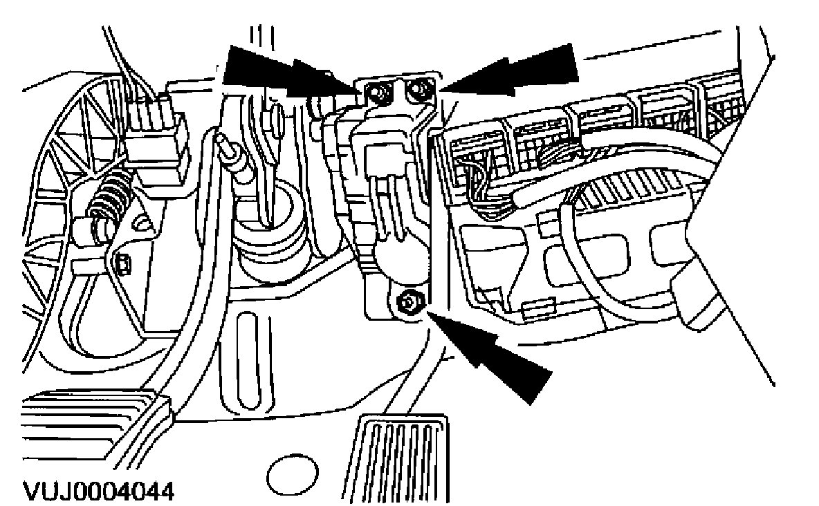

There is also a sensor on the gas pedal. Here are the directions for testing it. Let me know if you have the tools needed.

B2 : CARRY OUT AN ACCELERATOR PEDAL POSITION SENSOR COMPONENT CHECK
1. Remove the accelerator pedal.
2. Measure the resistance between pin 1 and pin 6 of the accelerator pedal.
3. Measure the resistance between pin 2 and pin 3 of the accelerator pedal.
Is the resistance between pin 1 and pin 6 between 546 and 1134 ohms, and between pin 2 and pin 3 between 975 and 2025 ohms?
Goto B3
INSTALL a new accelerator pedal. For additional information, refer to . CLEAR the DTC. TEST the system for normal operation.

I attached two pics so you can see which sensor I am referring to. Let me know if this helps or if you have other questions.
