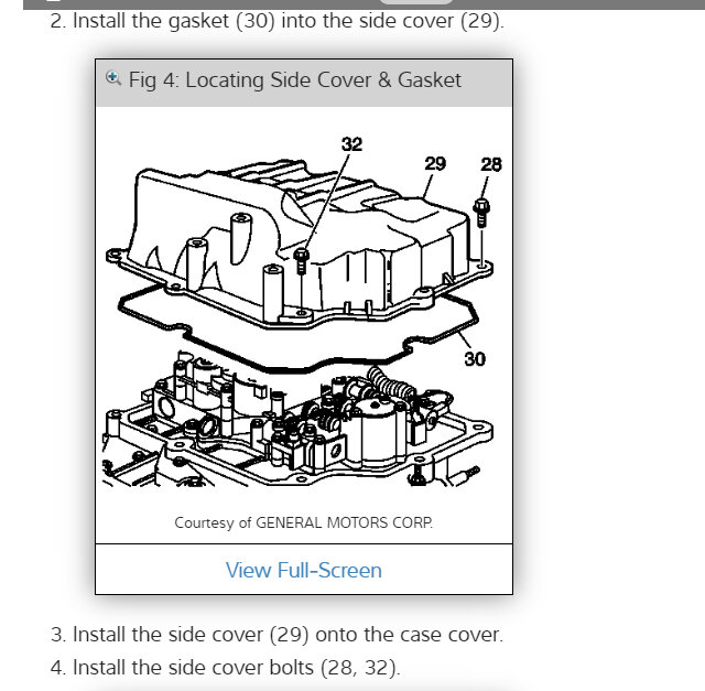

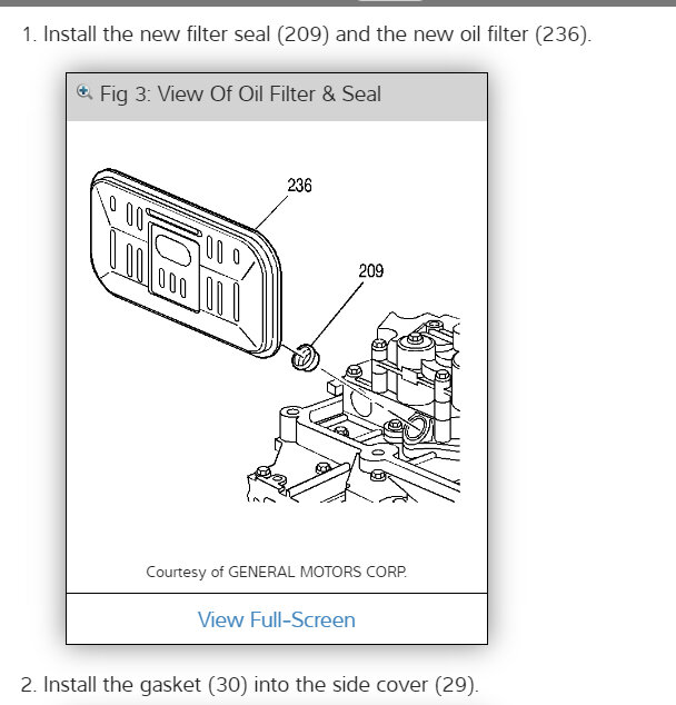

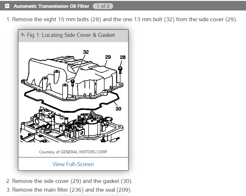

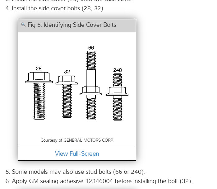

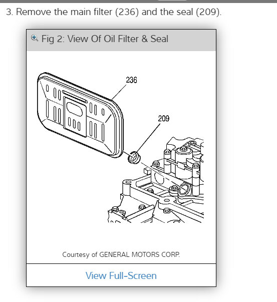

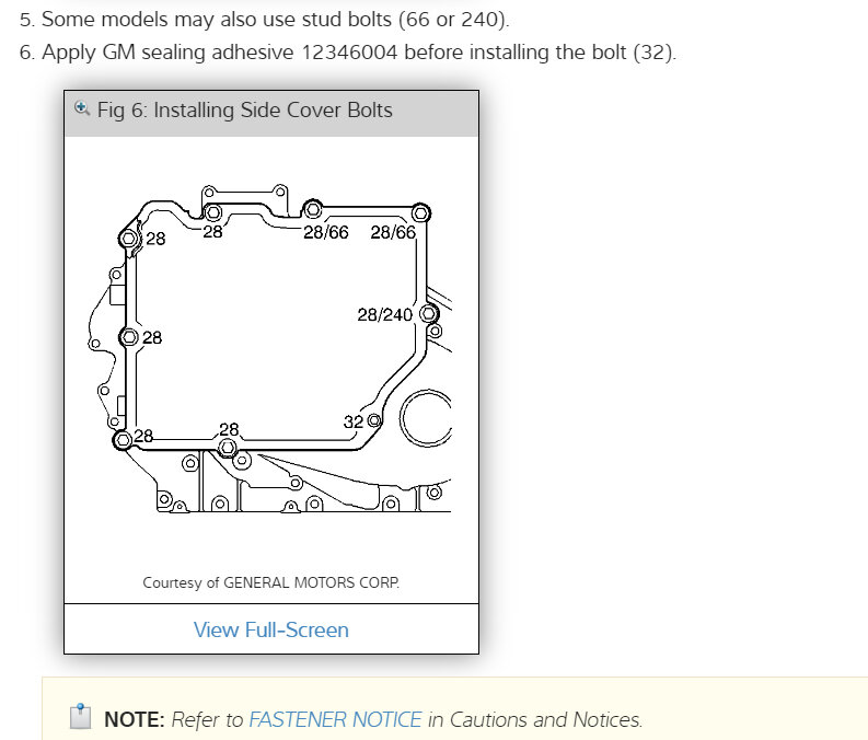

This sounds like the transmission filter is plugged up, I would drop the pan and replace the filter. Here is a generic guide to help you step by step with instructions in the diagrams below to show you how on your car:
This guide may help as well:
Also make sure the fluid level is good, this kind of thing can happen when the fluid gets foamed up due to low fluid.
