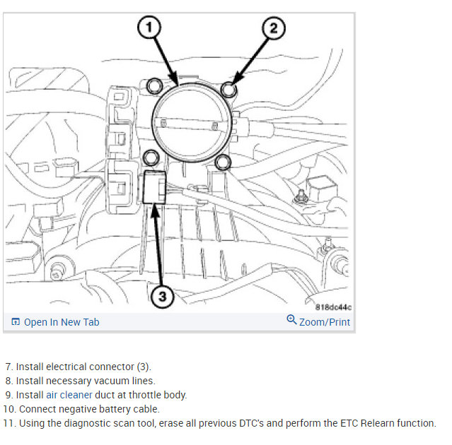

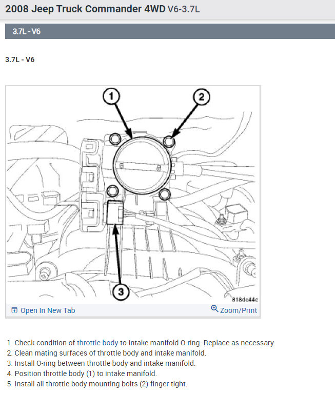

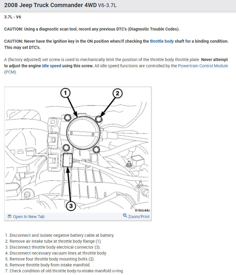

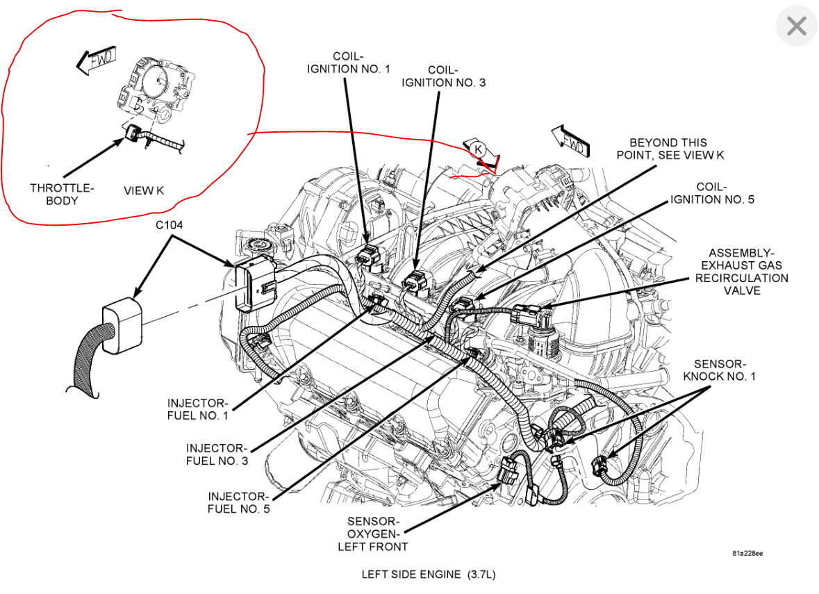

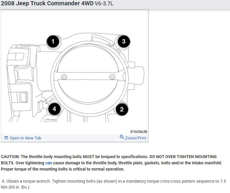

This vehicle is equipped with a throttle actuator, so when you press the throttle it sends signal to the actuator to amount of throttle that you have input. When this actuator gets dirty it can have a delayed reaction to the throttle input.
Keep in mind that many of these vehicles have delayed throttle input by design. It could be a slight delay, not so long that you start to wonder if it's going to move or not.
Here is a guide of how to clean the actuator:
Please let me know little more information of what you have been experiencing.
