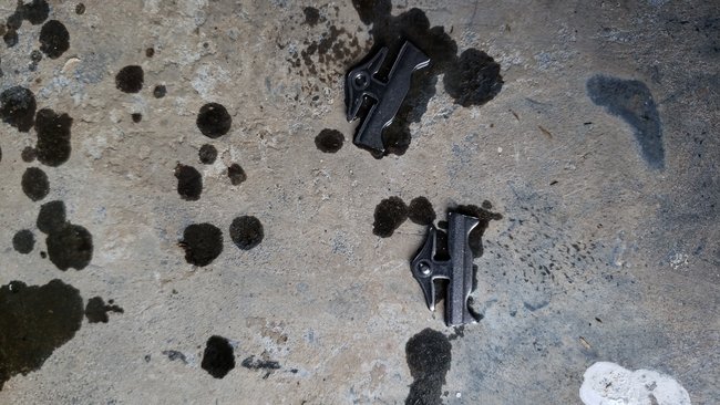

Drained my fluid but found these in there. What are they?
Saturday, December 29th, 2018 AT 1:57 PM
  • 109,872 POSTS
Welcome back:
Can you tell me what they are made of? Also, were they in the pan or where did you find them?

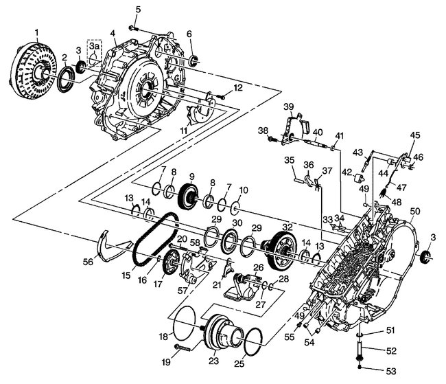

I attached an exploded picture of the transmission and components. Take a look.
Saturday, December 29th, 2018 AT 6:59 PM
IONREDLINEGUY
  • 9 POSTS
They are very thin metal, as soon as I removed the bolt to drain the transmission fluid they fell out.
Saturday, December 29th, 2018 AT 7:51 PM
  • 109,872 POSTS
They appear (I can't be 100% sure) to be from the filter mount assembly. Have you removed the pan?

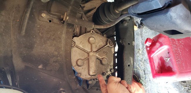

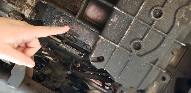

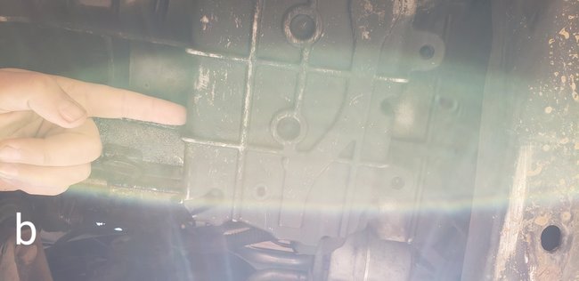

Hey Joe, is this what I need to remove?
Tuesday, January 1st, 2019 AT 3:30 PM
  • 109,872 POSTS

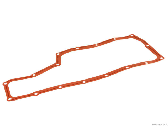

Hi and welcome back:

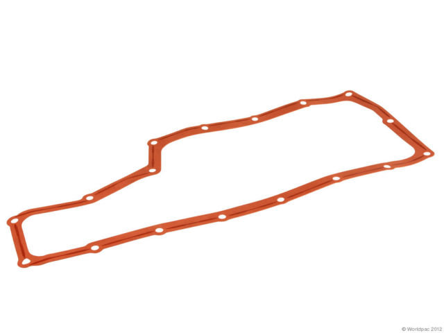

No, that's not the pan. The pan will be on the bottom. I attached a picture of the pan gasket so you can see the shape of the pan.
Let me know if this helps.
Tuesday, January 1st, 2019 AT 9:13 PM

Which one Joe?
Thursday, January 3rd, 2019 AT 12:50 PM
IONREDLINEGUY
  • 9 POSTS
Or A.
Thursday, January 3rd, 2019 AT 12:51 PM
  • 109,872 POSTS
Hi again:
I can't see the entire first picture, but that looks like it. The pan should be shaped like the gasket picture I attached.
Thursday, January 3rd, 2019 AT 4:02 PM
IONREDLINEGUY
  • 9 POSTS
I am having trouble finding anything shaped like that gasket from underneath the engine bay. But ill give it a try.
Thursday, January 3rd, 2019 AT 6:22 PM
  • 109,872 POSTS
The transmission should be a VT25-E CVT transmission. That's the shape it should be.
