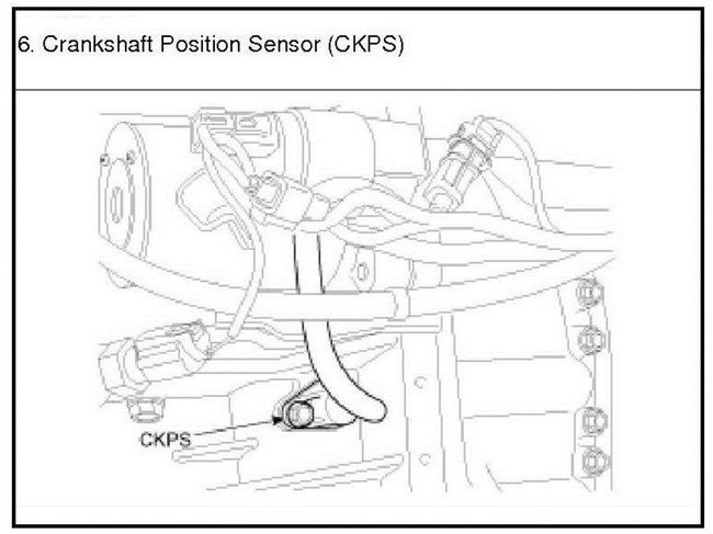

Car is turned on, but drive or reverse won't engage. Now this will only sometimes. Maybe not one day then one a day or maybe a few times a day. Very sporadic but after starting turn on and then off waiting a few minutes it goes into gear without a problem.

Thanks Joe, for the quick reply. Today a code P0335 popped up on the scanner. You mentioned the crankshaft monitor sensor.
Would replacing that first be the start? All systems match my problems with the car. Hope that makes sense.
Jun 3, 2022 at 4:41 PM
  • 110,244 POSTS

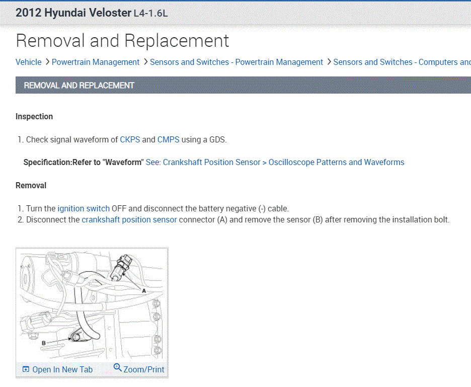

That is where I would start. From what I have read, that is one of the possible causes. As far as replacing the sensor, since the code indicates an issue, there must be a problem related to it.
The sensor is right below the starter motor. When you remove it take your time. If there is evidence of corrosion, spray it with something like PB Blaster or WD-40. Let it soak a bit and then gently turn it back and forth while removing it.

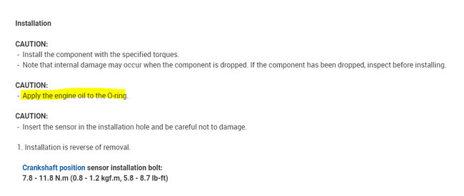

When you reinstall it, make sure where it is seated is clean. Otherwise, damage to the new o-ring will likely result and you'll have a leak. Make sure to coat the new o-ring with engine oil before reinstalling it.
If you look below, the first picture shows the location of the sensor. The remaining pics are the directions for the removal and replacement of the part.
Let me know if this helps and how things turn out for you.
