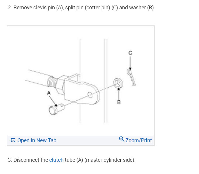

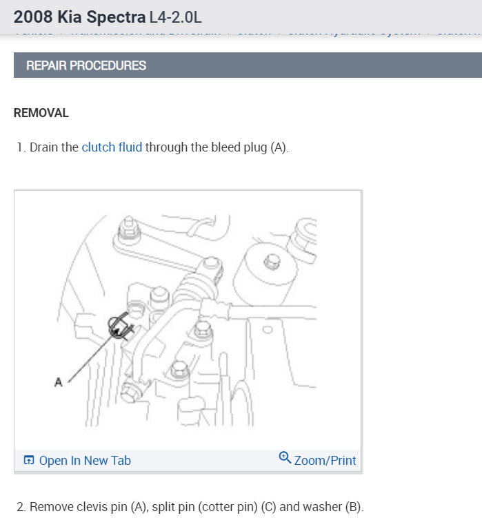

car starts but it won't go into any gear and the slave drive doesn't move like it should.
May 30, 2023 at 12:51 PM
  • 55,797 POSTS

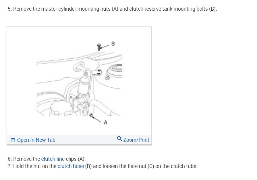

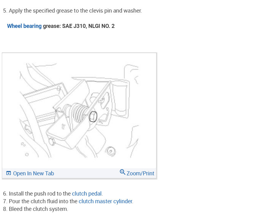

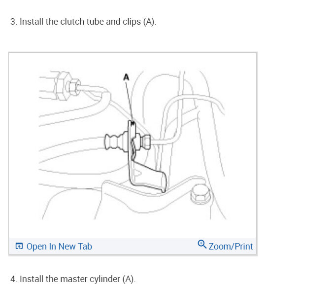

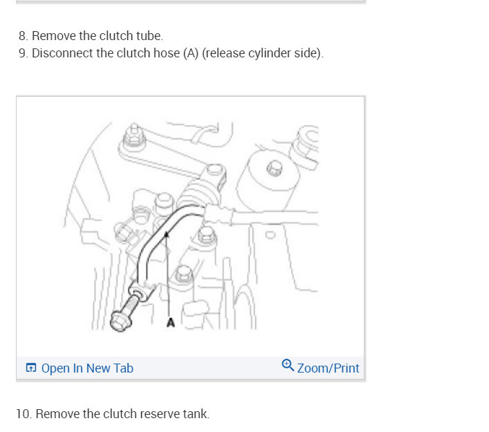

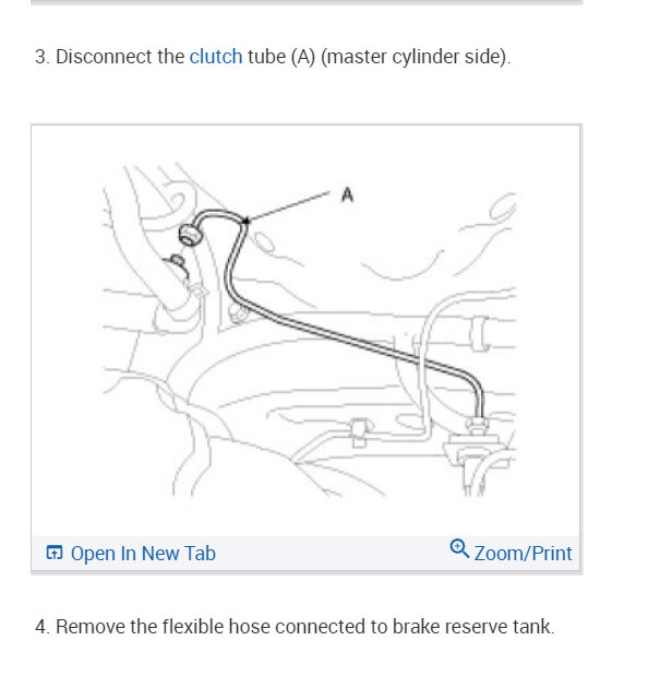

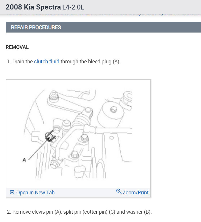

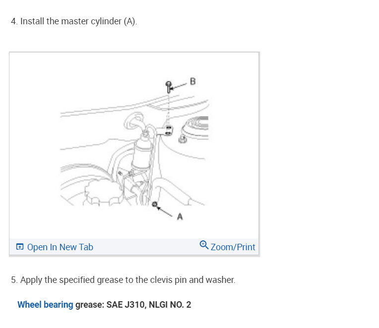

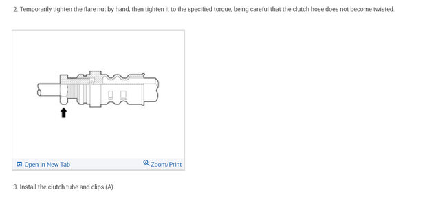

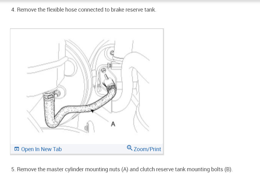

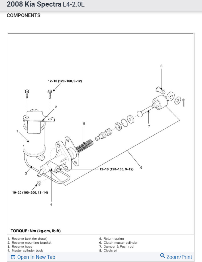

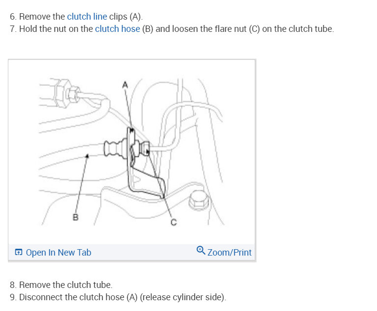

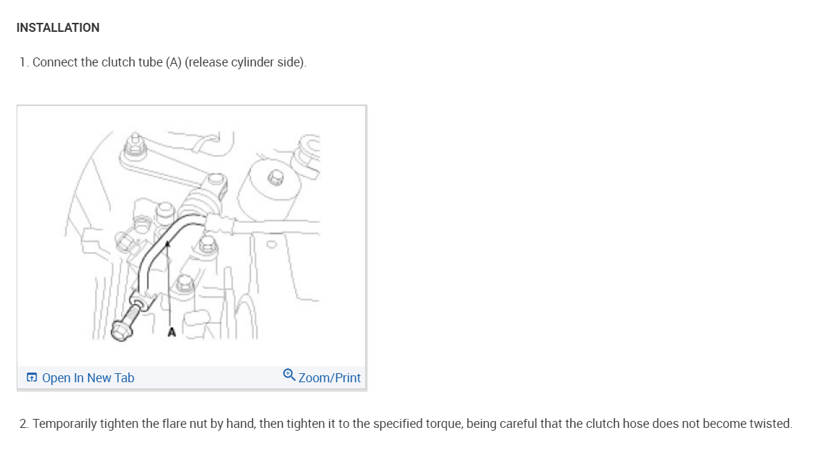

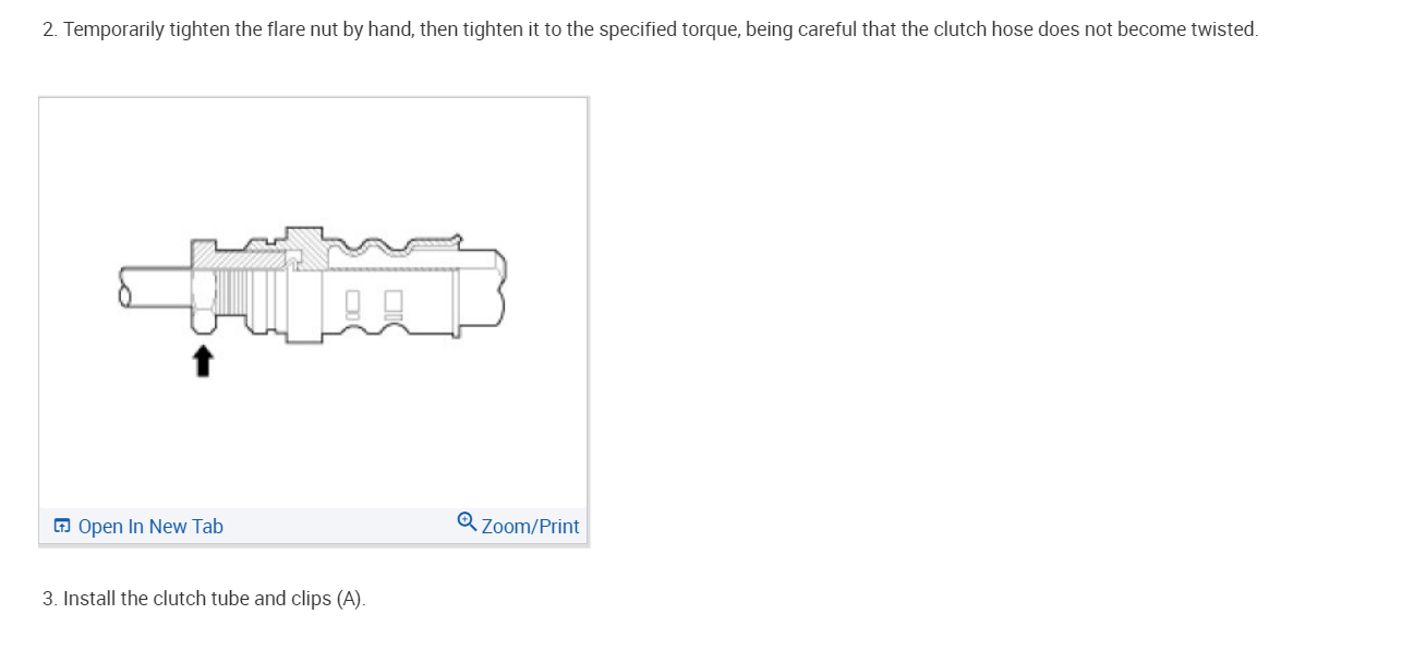

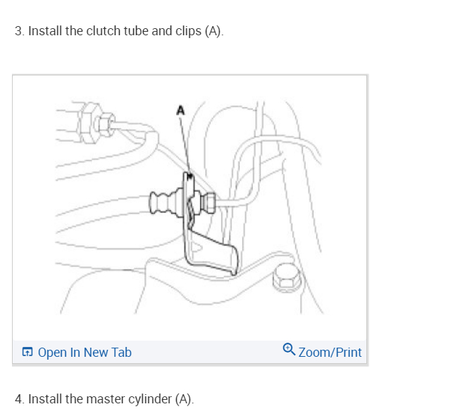

How does the clutch pedal feel does it seem normal or mushy? I would start by checking the clutch fluid level and if down check the master and secondary cylinder for leaks.
Here is a guide and video to help:
https://youtu.be/EpBMj5ZY_bo
and
https://www.2carpros.com/articles/clutch-doesnt-work-sometimes-or-not-at-all
Here is how to change out the master in case you need it. Check out the images (below). Let us know what happens and please upload pictures or videos of the problem so we can see what's going on.
