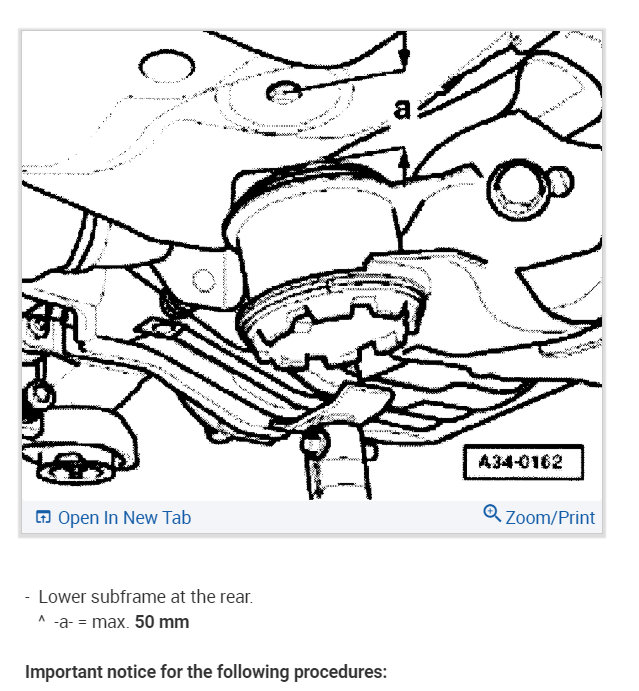

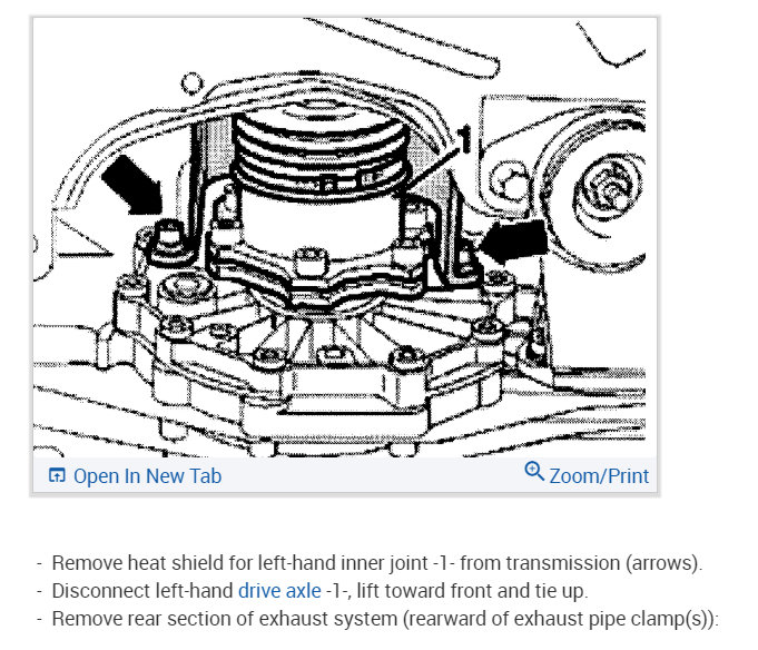

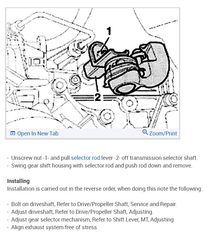

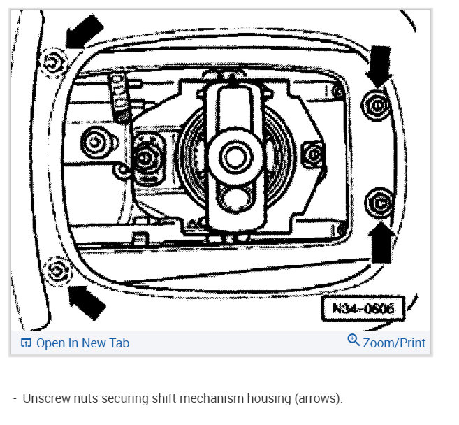

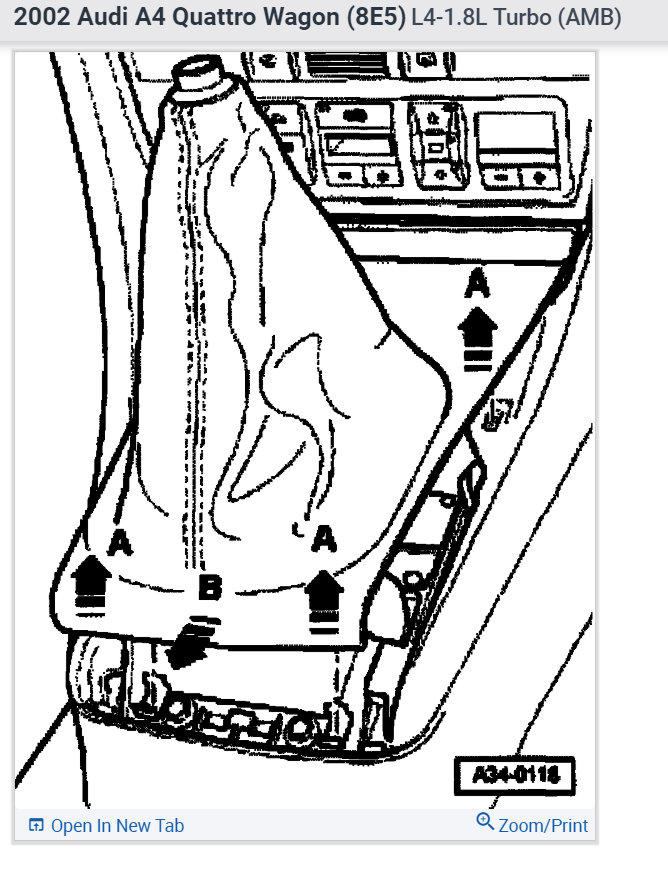

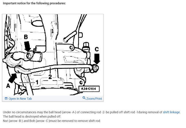

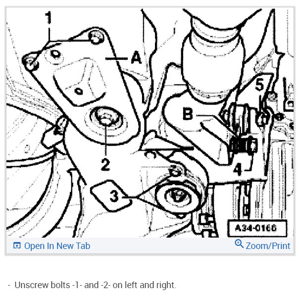

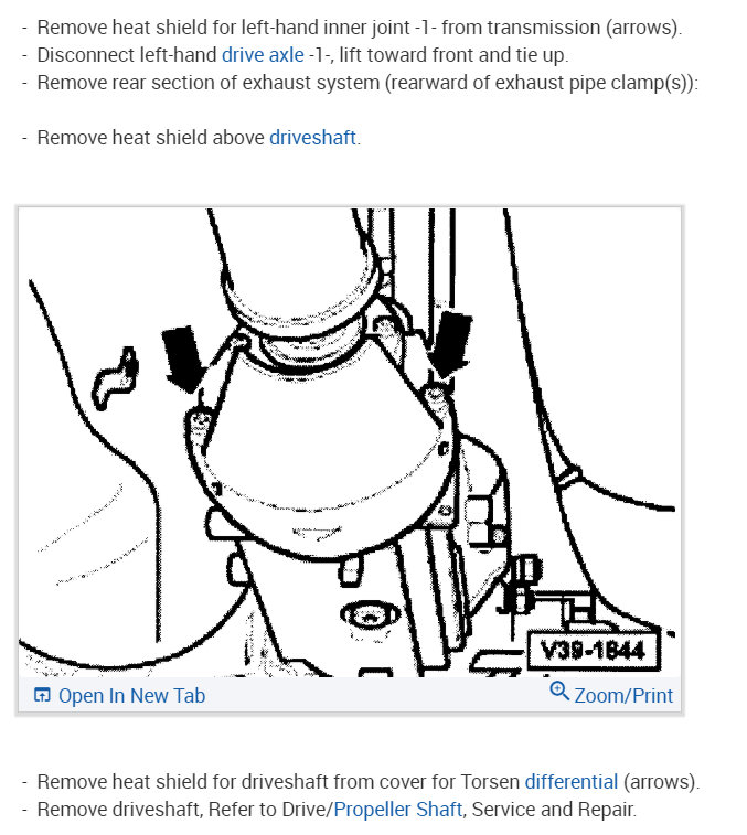

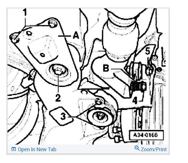

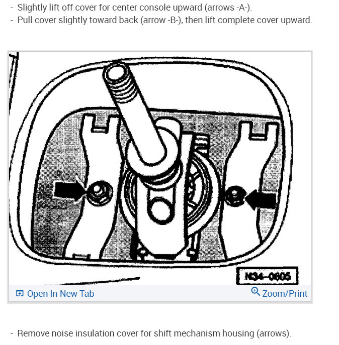

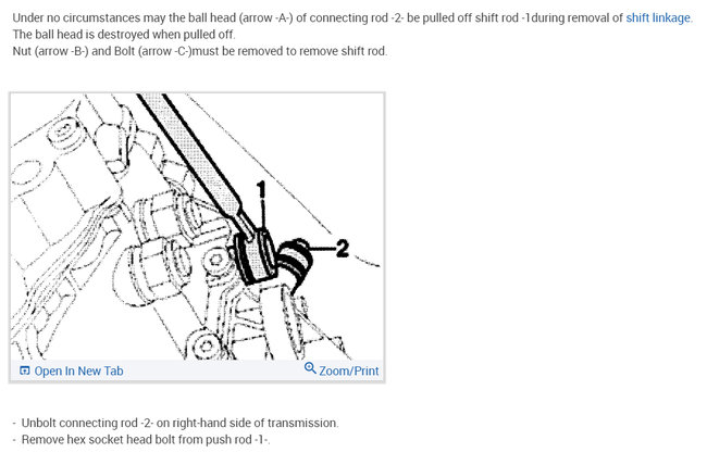

It sounds like the transmission is having an issue or the shift linkage is worn/broken. To be sure can you please shoot a quick video with your phone so we can hear the noise? that would be great. You can upload it here with your response. Check out the diagrams (below). Please let us know what you find. We are interested to see what it is.

It sounds like the 1st gear syncro is worn out you may need to rebuild the transmission. Here is a video that shows the transmission being removed in a similar car.
