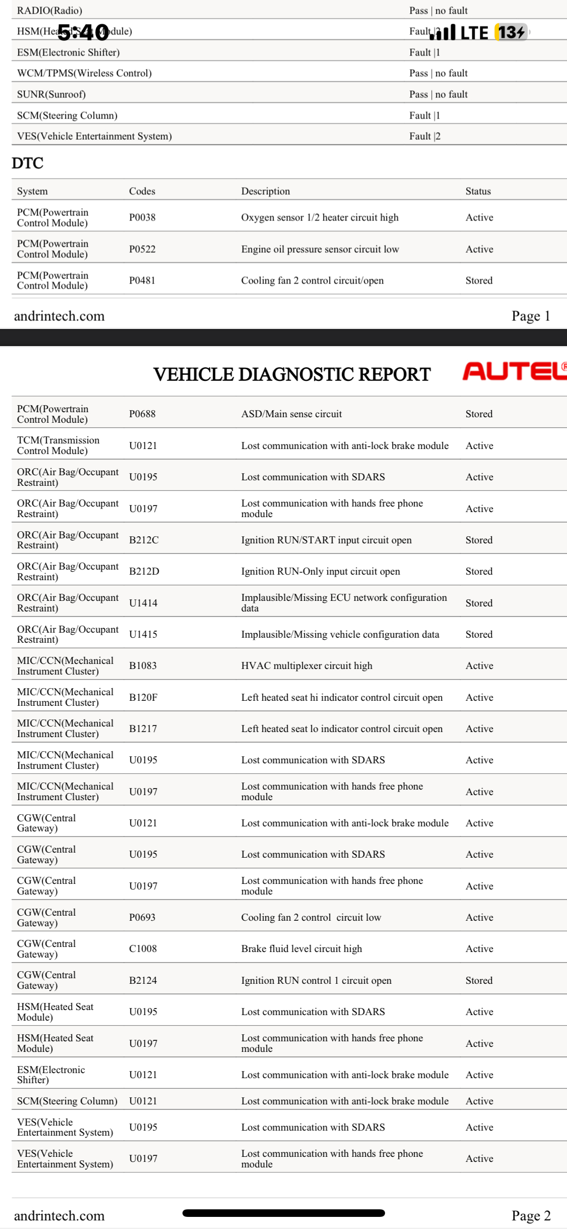

May I as well get the can bus for the ABS, could be a short or open circuit in the wires. I have attached image of the codes below.

Yep, this looks like it might be the CAN BUS system, but the image with the codes is too small, I cant read it, can you please reload a more viewable version?

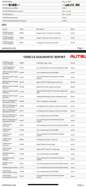

AUTEL
PCM(Powertrain
Control Module)
P0688
ASD/Main sense circuit
Stored
U0121
Lost communication with anti-lock brake module
Active

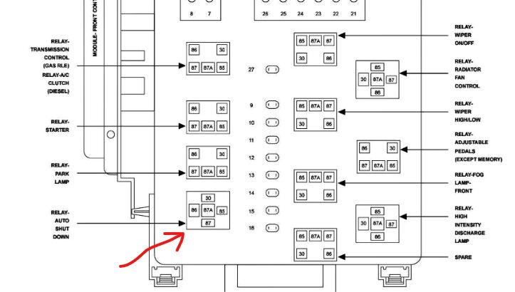

Cool, thanks, I would swap out eh ASD relay. here is the location. Check out the images (below). Let us know how it goes
