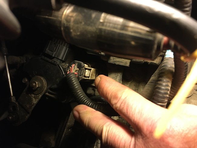

Update: We borrowed a code reader, a really nice Snap On one, and it didn’t pick up anything. Then, when my dad was messing around with it, he unplugged a piece on the top of the transmission, and the transmission engages in all the gears. When he plugged it back in same problem as before. Picture is of piece he unplugged. The piece with the wires coming from it.
Jan 19, 2020 at 1:30 PM
  • 110,251 POSTS
I see the range sensor. The connection near it is for the transmission control circuits. I think that is what was unplugged. Take a look at the pic below. Are those the color wires which you are seeing in the harness? I can't tell from the pic. If they are, my first suspect is a problem with the EPC solenoid on the valve body. EPC stands for electronic pressure control. It may be stuck closed when power is applied.
