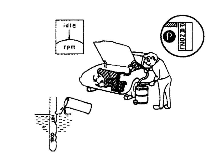

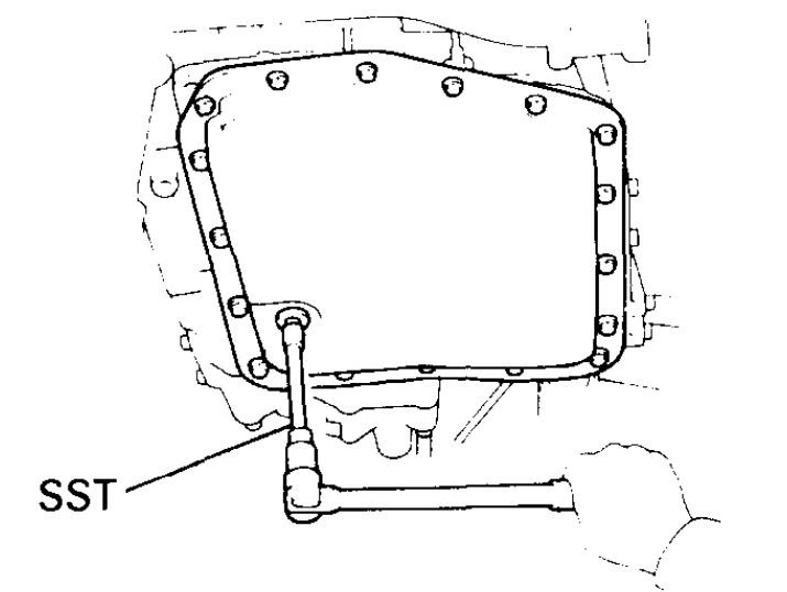

REPLACE ATF
(1)Remove the drain plug and drain the fluid.
(2)Reinstall the drain plug securely.
(3)With the engine OFF add new fluid through the oil filler pipe.
Fluid type: ATF Type T-IV or equivalent.
Capacity:
U140E: 3.5 liters (3.7 US qts, 3.1 Imp. qts)
U140F: 4.1 liters (4.3 US qts, 3.6 Imp. qts)
(4)Start the engine and shift the shift lever into all positions from P to L position and then shift into P position.

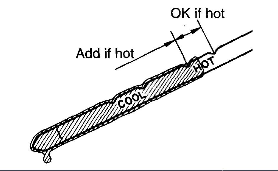

(5)With the engine idling, check the fluid level. Add fluid up to the COOL level on the dipstick.
(6)Check the fluid level at the normal operating temperature, 70 - 80 °C (158 - 176 °F), and add as necessary.
NOTE: Do not overfill.
