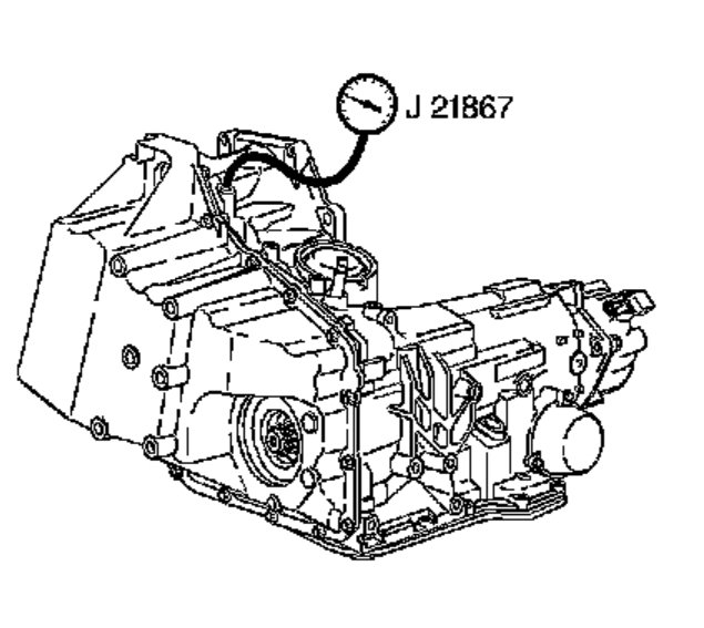

So it all started when I stopped at a stop sign and went to drive and the car wouldn't move. It started no problem but would not drive in any gear or reverse and there was no abnormal noises. Had it towed home and started researching the issue. Low fluid was the first check. Fluid was coming out of the test hole. Drained all fluid out and only about 3.5 liters came out so clearly it was low. It was really dark like oil. After more research we ended up changing the filter and flushing the fluid then filling with new fluid. Once finished I was able to drive it out of the garage. Cycled the fluid through the gears. Took it for a drive for about fifteen blocks. After stopping it was very delayed in first gear but once in second it drove fine. Got it home and now it won't drive again. Does anyone know what the issue Is? I Don't want to put anymore money into fixing it if it is going to end up being a bad transmission. Someone told me it could possibly be the torque converter? Any help is greatly appreciated. thank you.

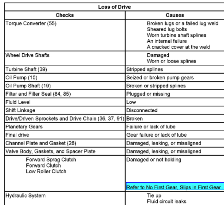

This does sound like a torque converter or fluid pump issue. You can perform a line pressure test to confirm this. If line pressure is low the transmission would need to be pulled to replace these items. I'd recommend a good salvage yard unit or reman transmission if so. I'll post the test info below. Most parts stores have the gauge in their loan a tool program.

8. Remove the oil pressure test hole plug and install the J-21867-65 adapter (5.3L only) and the J 21867.
9. Put the gear selector in PARK range and set the parking brake.
10. Start the engine and allow the engine to warm up at idle.

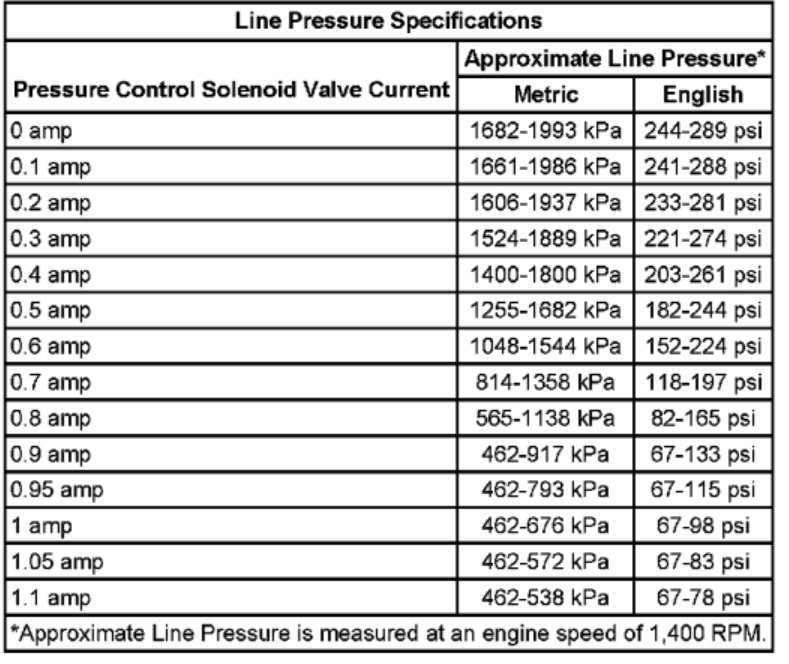

12. Increase the PC solenoid actual current from 0 to 1 amps in 0.1 amp increments. Allow the pressure to stabilize for five seconds after each
pressure change. Read the corresponding line pressure on the J 21867.
13. Refer to the Line Pressure specification table. Compare the data to the table.
14. If pressure readings differ greatly from the table, refer to Incorrect Line Pressure. See: Symptom Related Diagnostic Procedures/4T65-E
Automatic Transaxle/Incorrect Line Pressure
