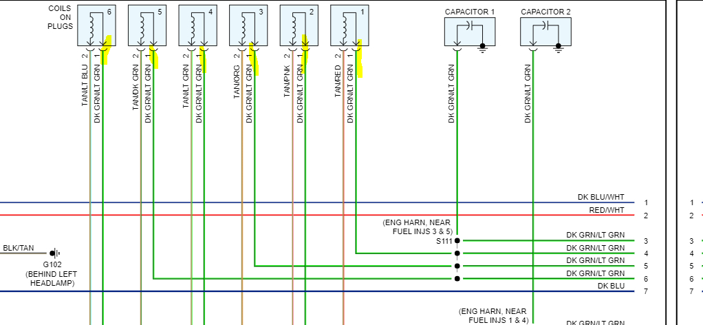

I parked the car after work. Got up next morning wouldn't crank. Not turning over. Went bought a new battery and a starter relay. Will turn over like it trying to crank. Someone told me it could be the crankshaft senor, so I replaced it and the camshaft senor. Still no crank then replaced the MAP senor. I hear the fuel pump coming on. The car will turn over but will not crank. Please help

We checked the plugs and there was no spark. We also tried the starting fluid and no crank. The computer is not pulling any codes. We checked all the fuses and relays. Is there anyway somehow that it might have jumped time? If so, how?

Also, I need you to check for power to the ignition coils. If you look at the connectors, you'll notice that each coil will have a dark green wire with a light green tracer. (see pic below) That is the power supply to each coil. With the key on, that should have power. I need you to check to make sure there is power present.
See pic below.
