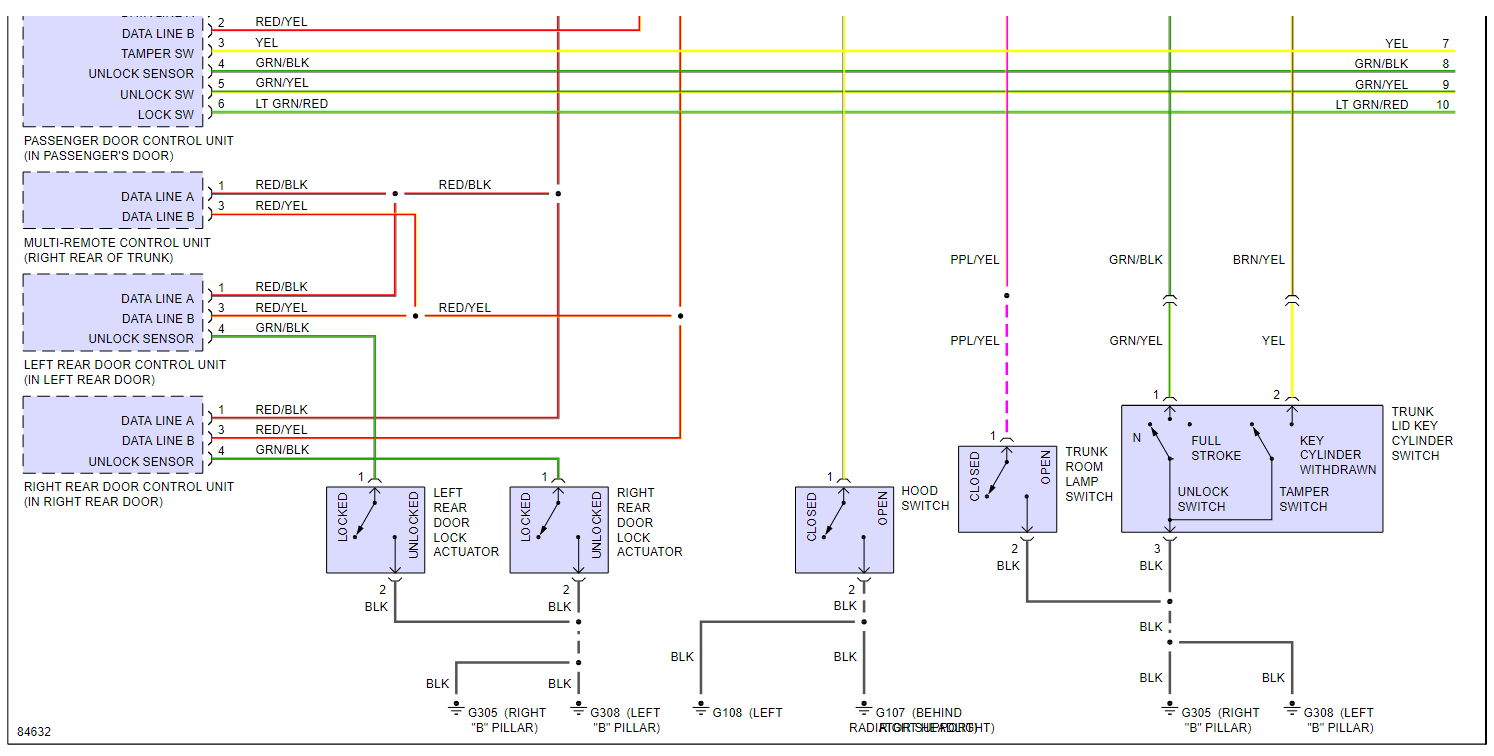

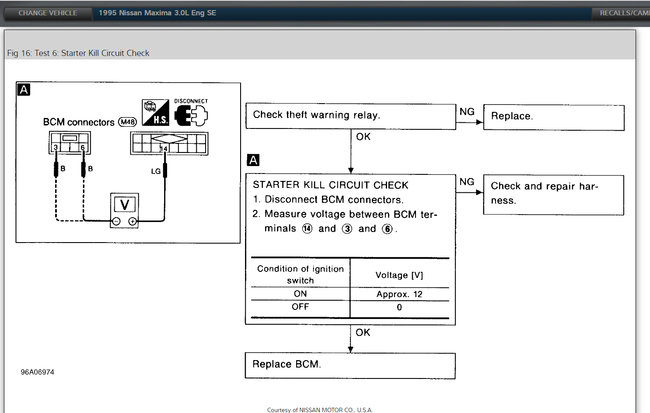

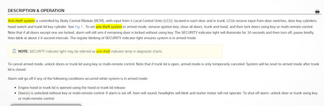

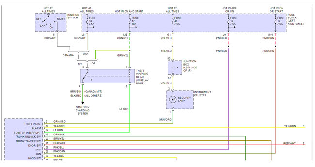

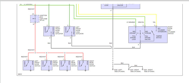

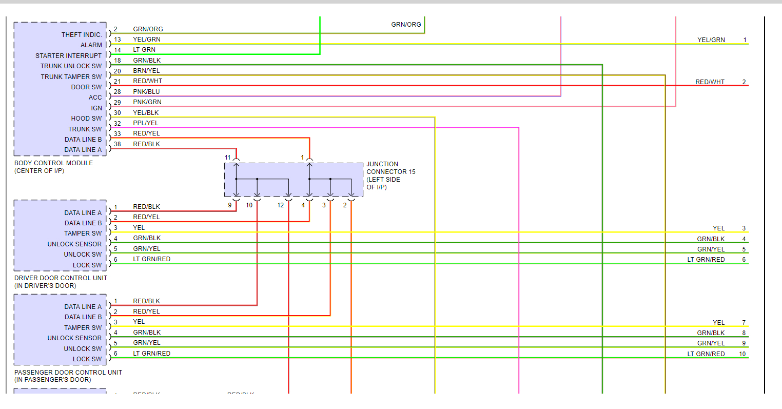

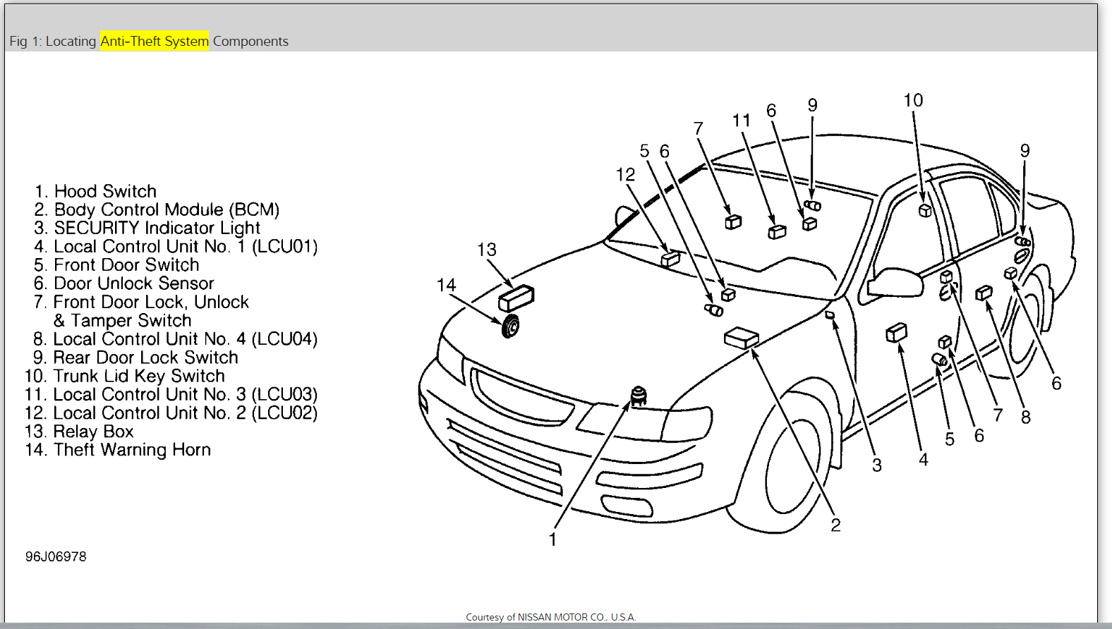

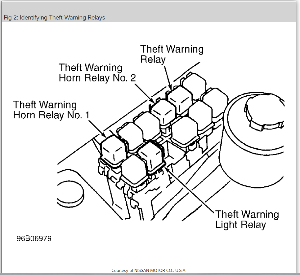

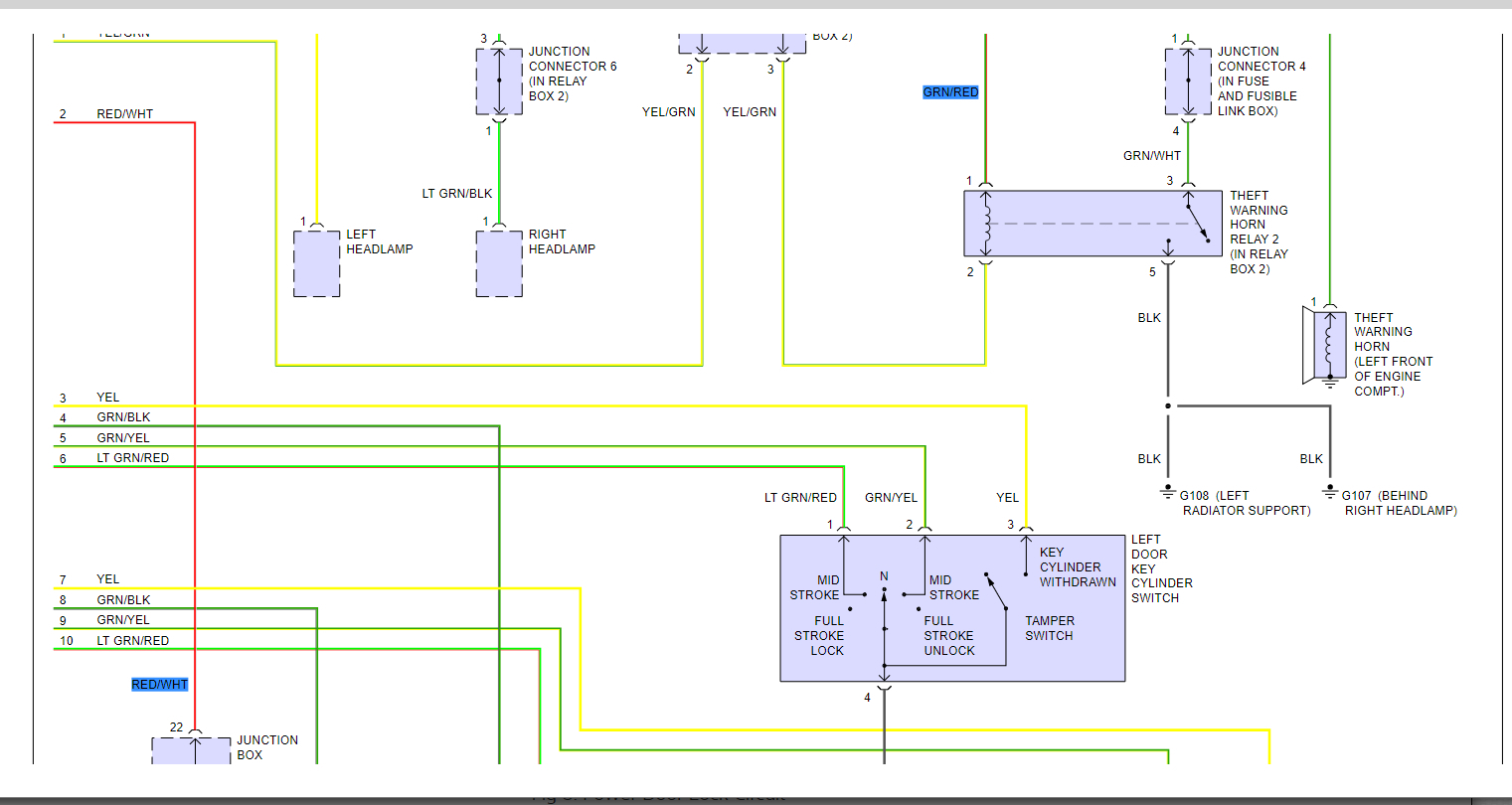

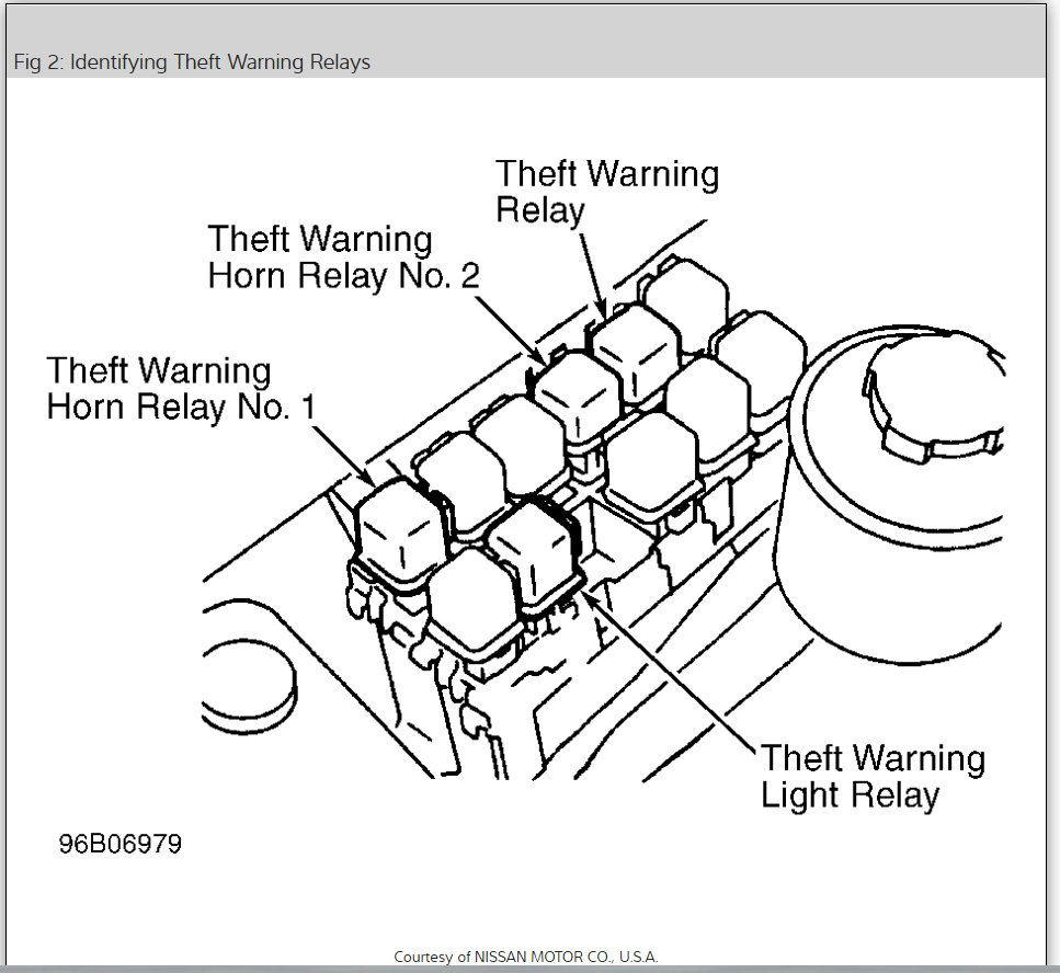

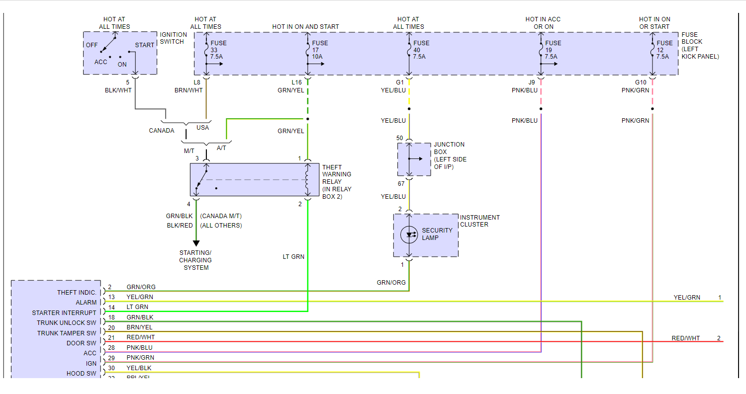

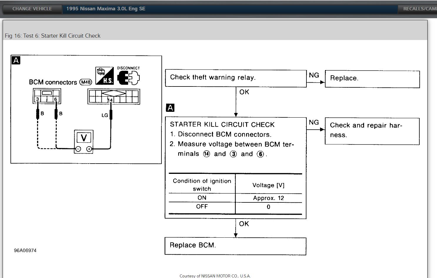

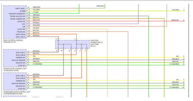

Security light flashing, battery when dead, car wont crank, tried jumping didn't work. First time I drove car, just bought it.
Monday, March 4th, 2019 AT 9:27 PM
SCGRANTURISMO
MECHANIC
4,897 POSTS

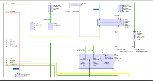

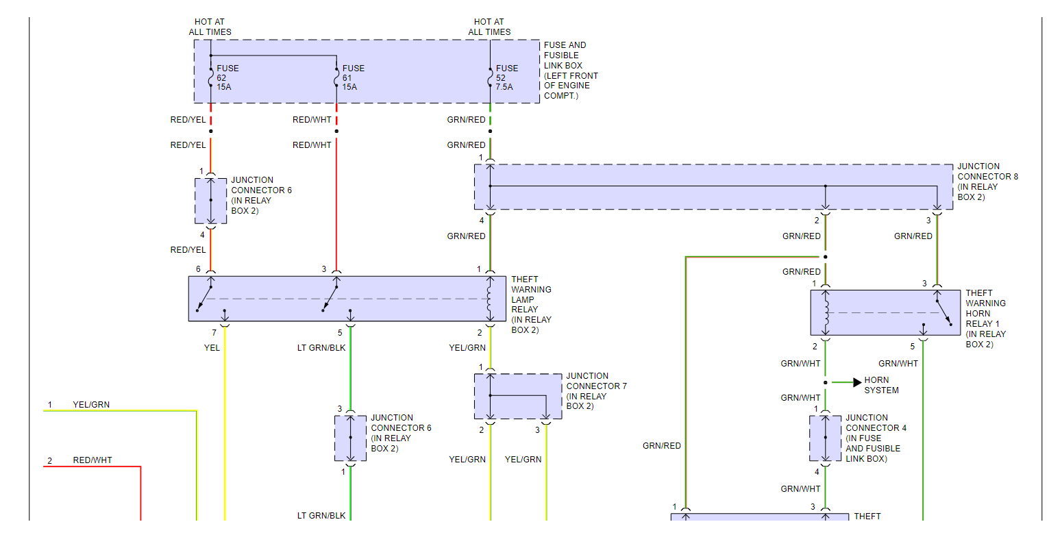

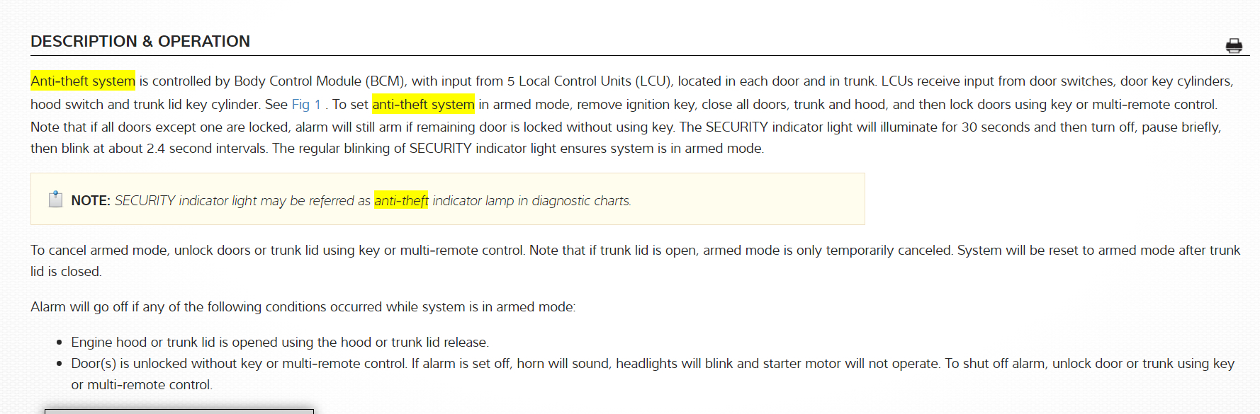

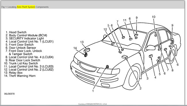

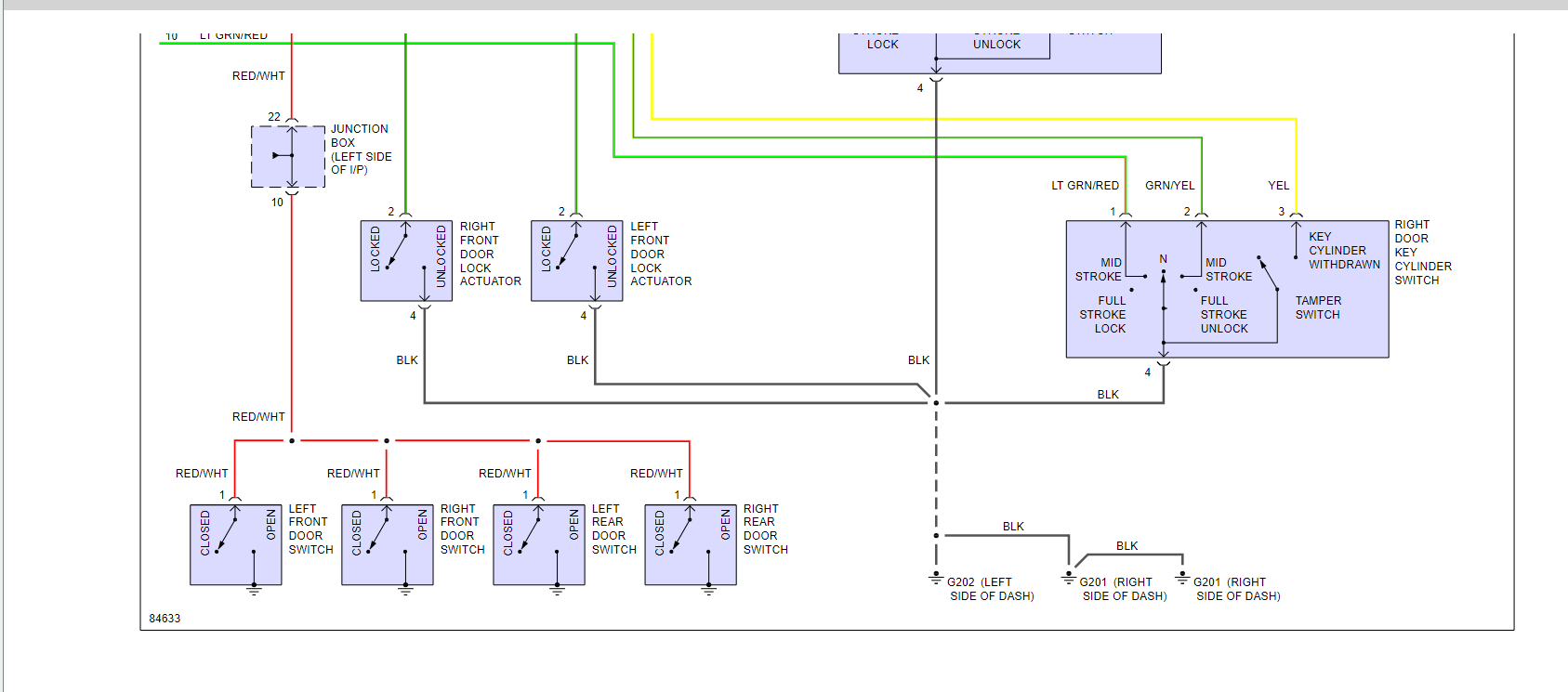

This could be a problem with your vehicle's Body Control Module (BCM). I have included a link down below for you to go to.
https://www.2carpros.com/articles/how-to-reset-a-security-system
Please go through this guide. I have also included vehicle specific information in the diagrams down below. Please go through all the material and let us know what you find out.
