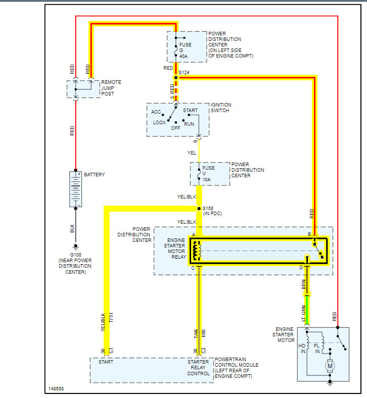

I got my battery tested, my starter tested and my alternator also. but my car still won’t crank. does anyone know what the problem could be?

Good evening,
I attached a wiring diagram of the starter circuit for you to view. There are a couple of fuses you need to test as well as a relay.

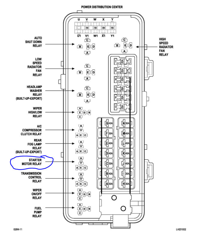

I attached the location of the relay. When you can, let me know and I can help guide you through the diagnostics.
