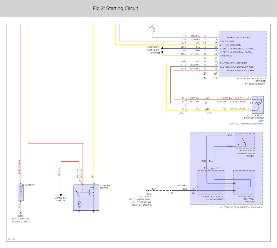

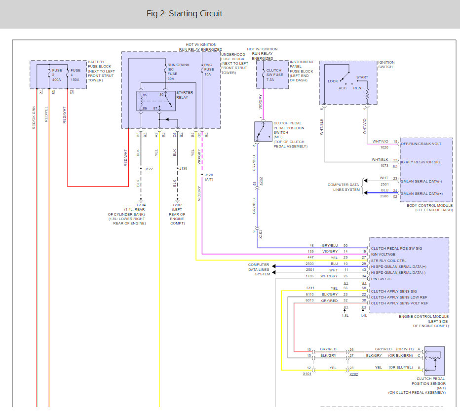

Does the starter get power at the trigger wire?
Here is a guide to help you find out. Check out toward the bottom of the guide.
https://www.2carpros.com/articles/car-engine-will-not-crank-over
You might need to jack the car up as well.

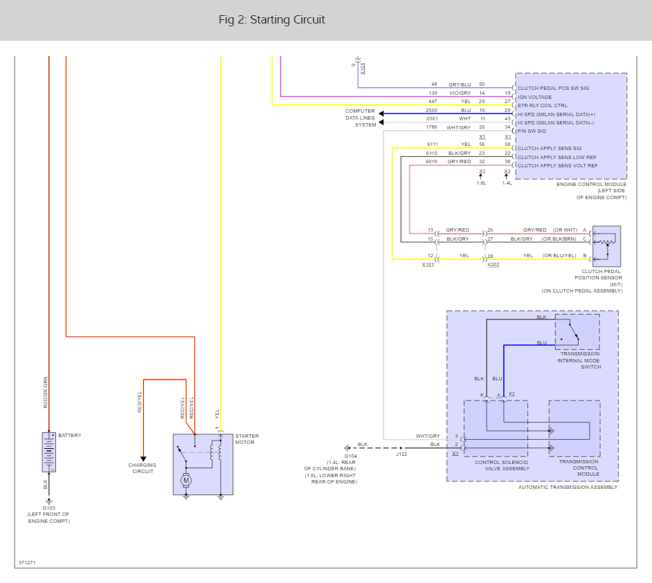

Yes the starter is getting power. I have crossed out the wires to the starter and the car will try to crank.
Jul 26, 2017 at 11:25 AM
  • 55,433 POSTS

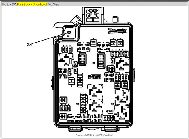

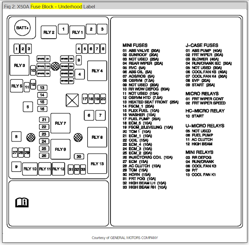

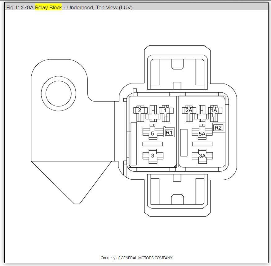

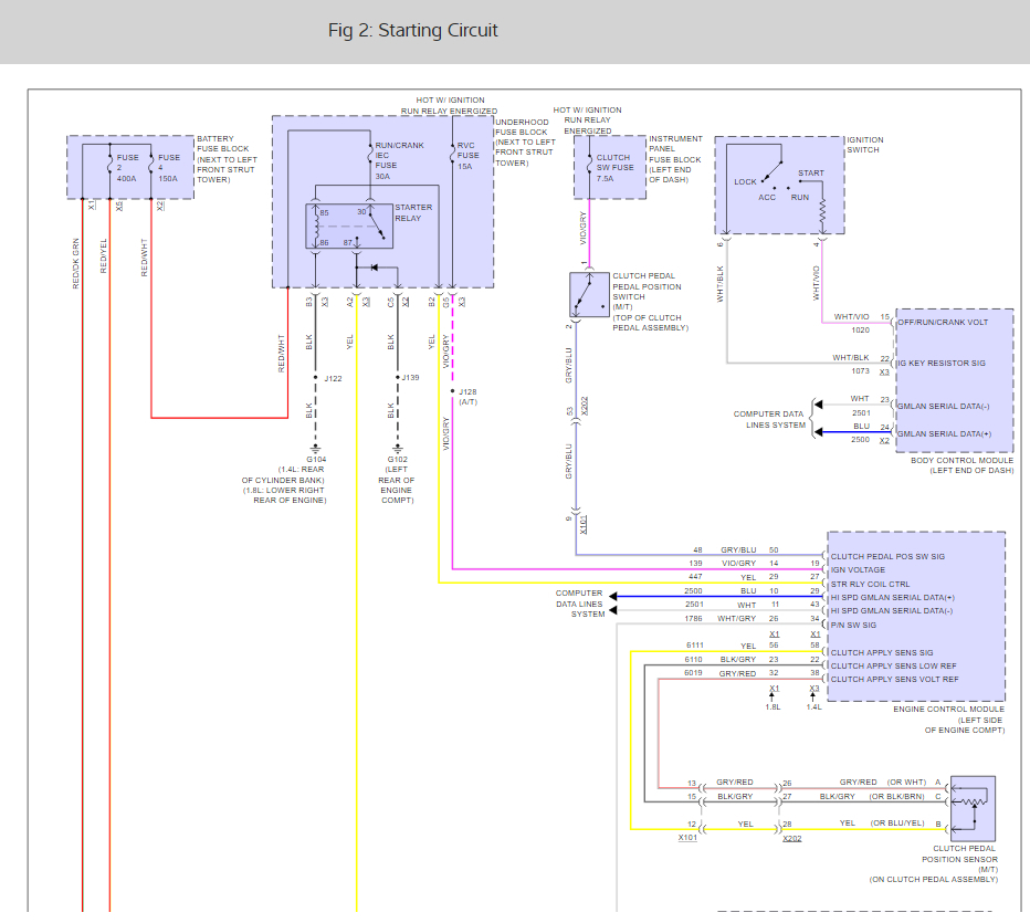

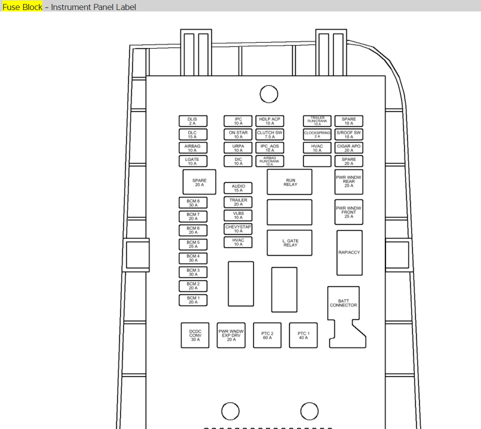

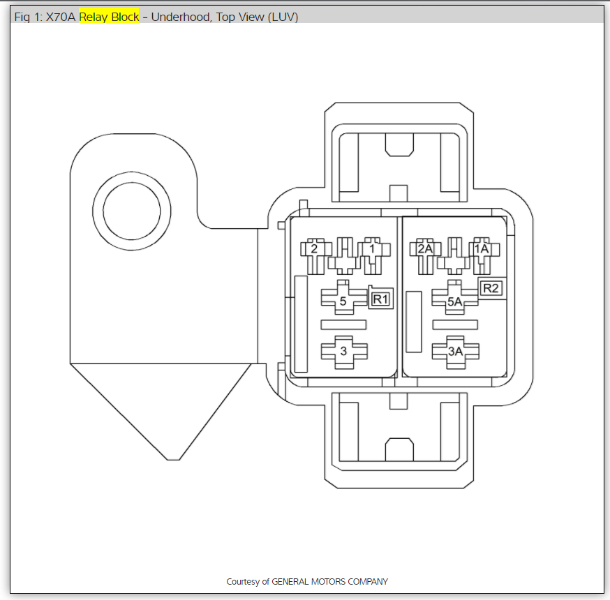

Okay then it must not be getting a trigger signal. There is a starter relay that can be causing the trouble. Also is the security light flashing?
Here is a guide and a wiring diagram and fuse and relay location (below) so you can run so tests.
and
and
Please run some tests and get back to us we are interested to see what it is.
