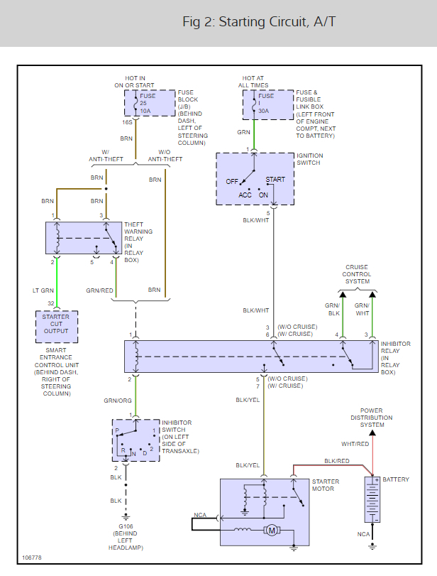

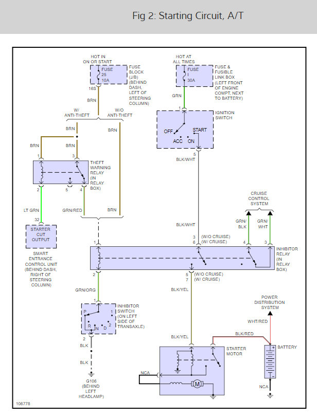

All the lights come on. I replaced the starter, battery and the ignition switch and it still will not crank. The fuses and relays works fine.
Dec 12, 2018 at 7:42 AM
  • 55,746 POSTS

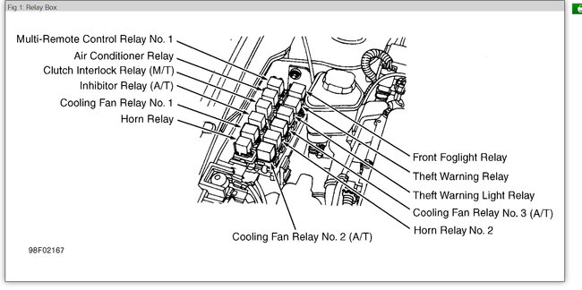

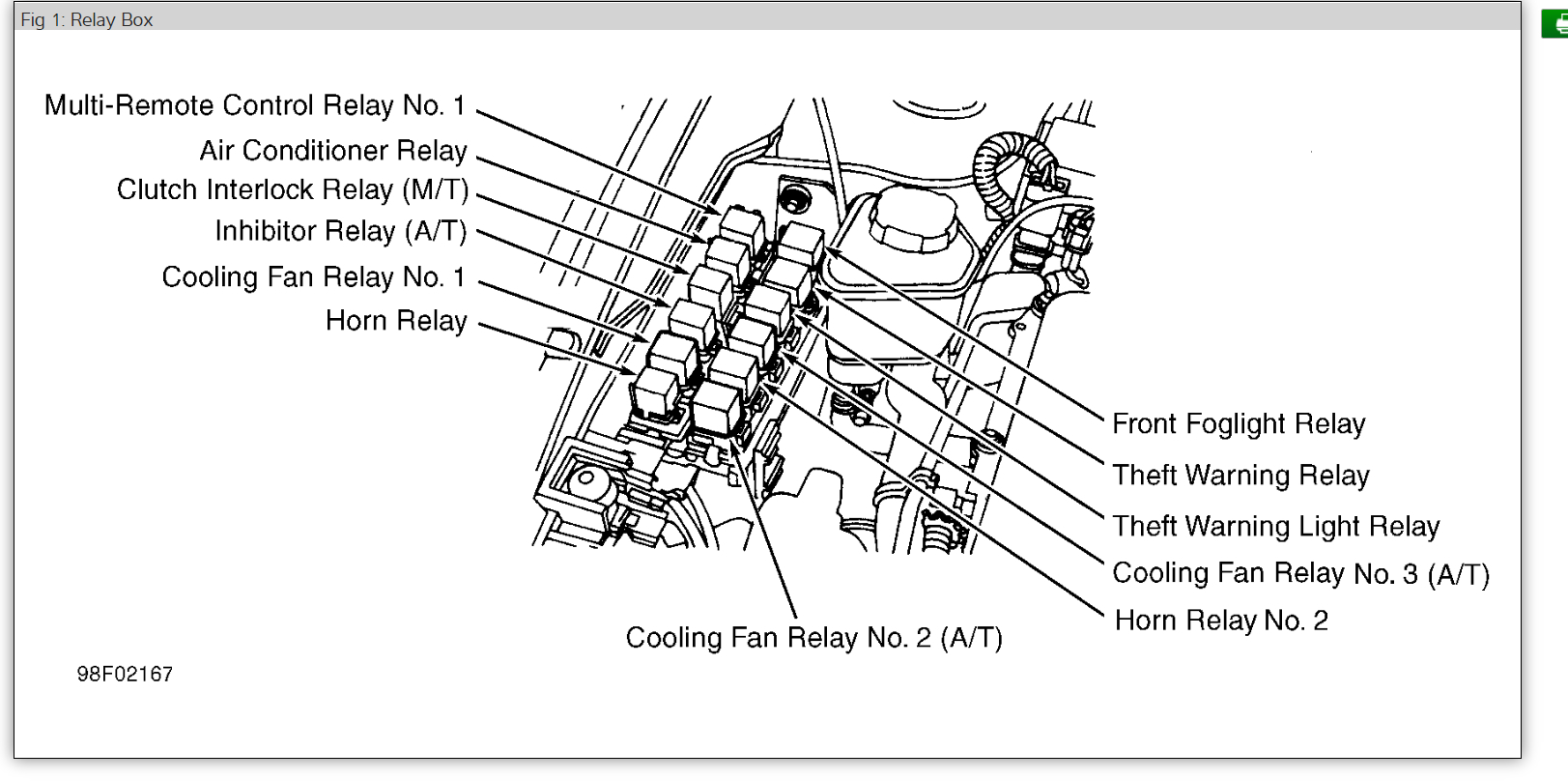

Is the security light flashing? If not here is wiring diagram of how the starter circuit works and a guide tso you can test it. Did you try starting it in neutral? If it cranks the neutral safety switch is bad. Also did you check the inhibitor relay?
