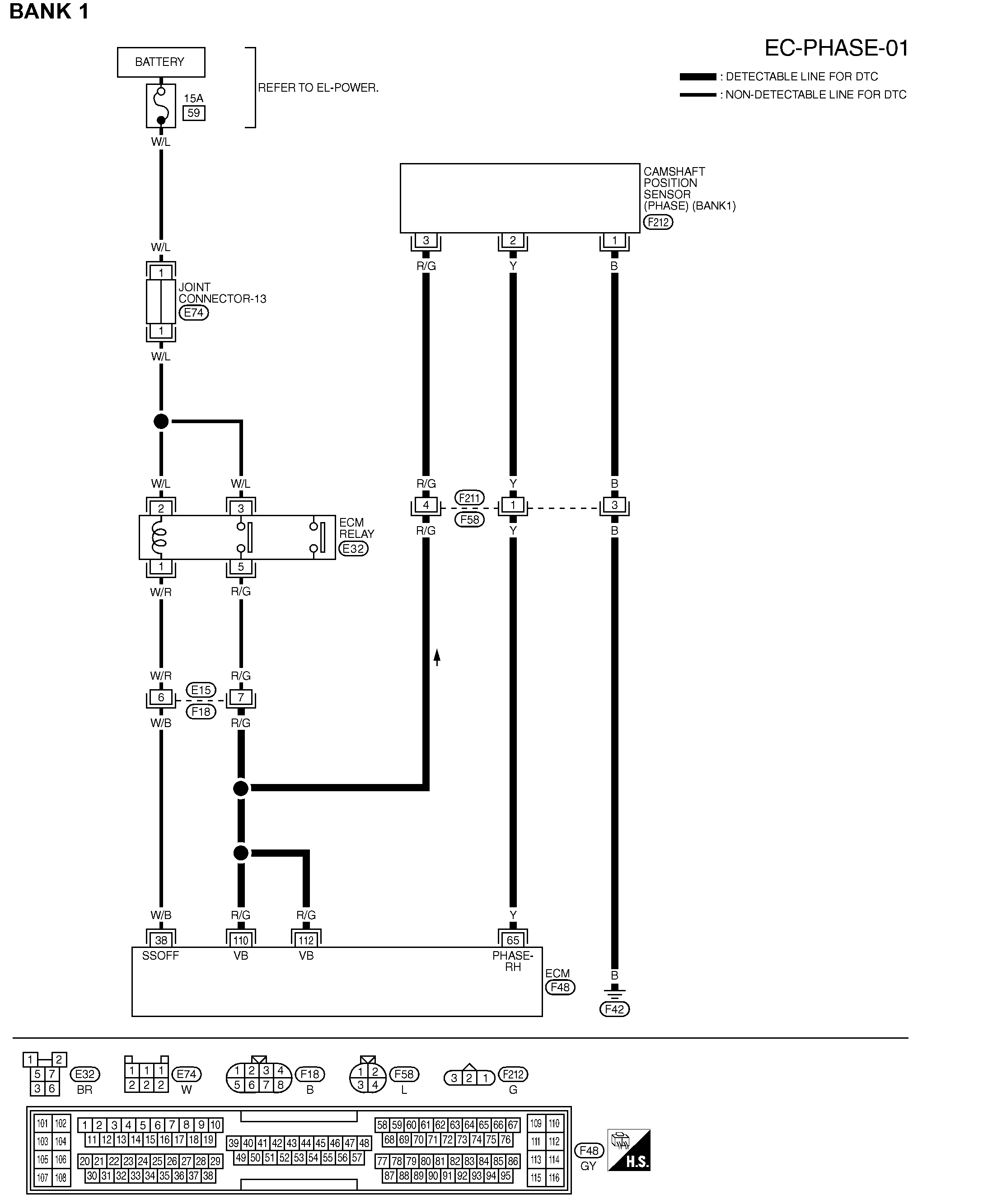

The P0340 is related to the camshaft position sensor. I'm suspecting it has something to do with the camshaft phaser. Here are the diagnostics. Take a look through them and let me know if you are comfortable doing it. The attached pics correlate with the directions.
___________________________

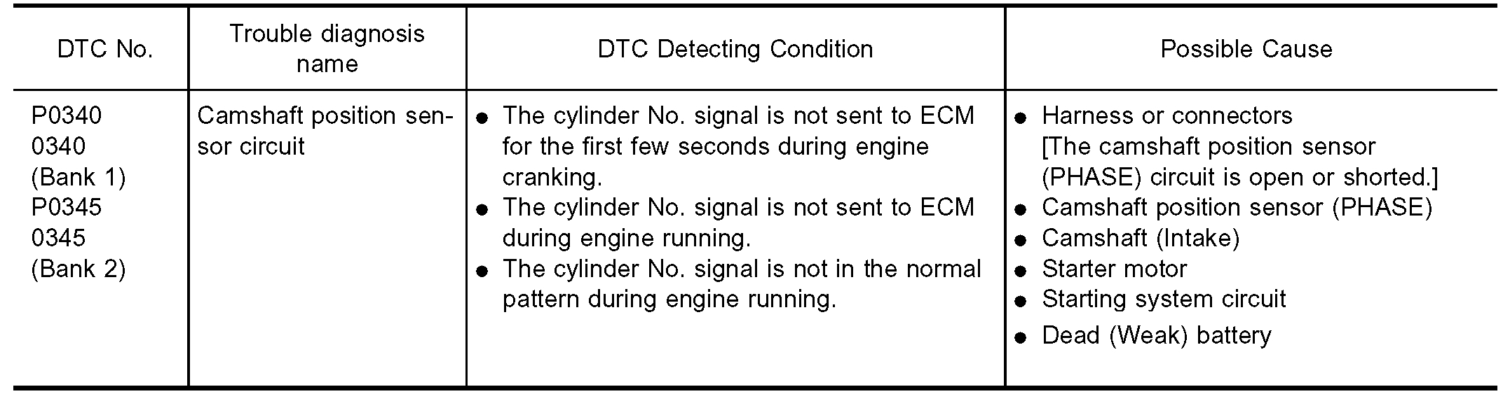

On Board Diagnosis Logic
pic 2

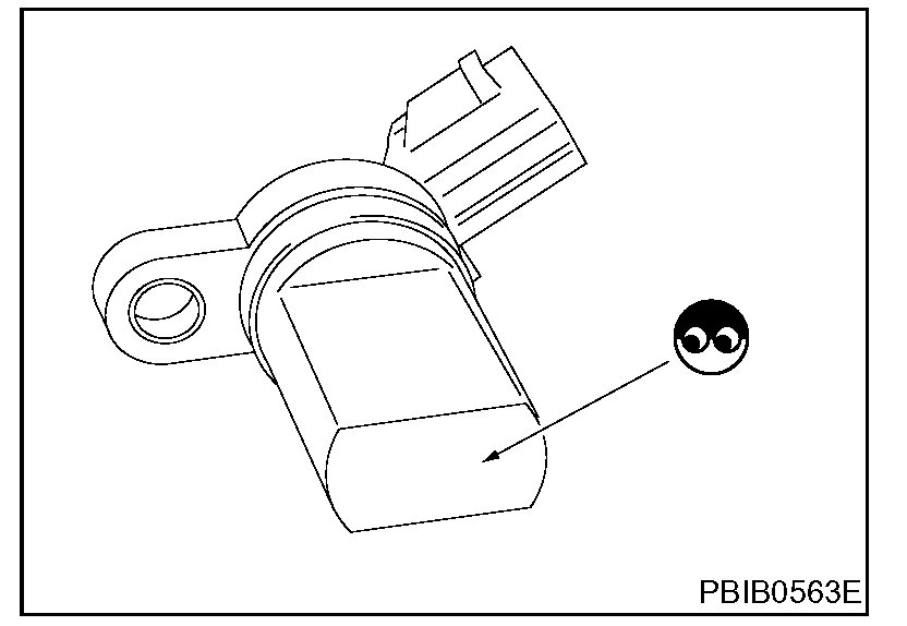

1. Turn ignition switch "ON".
pic 3

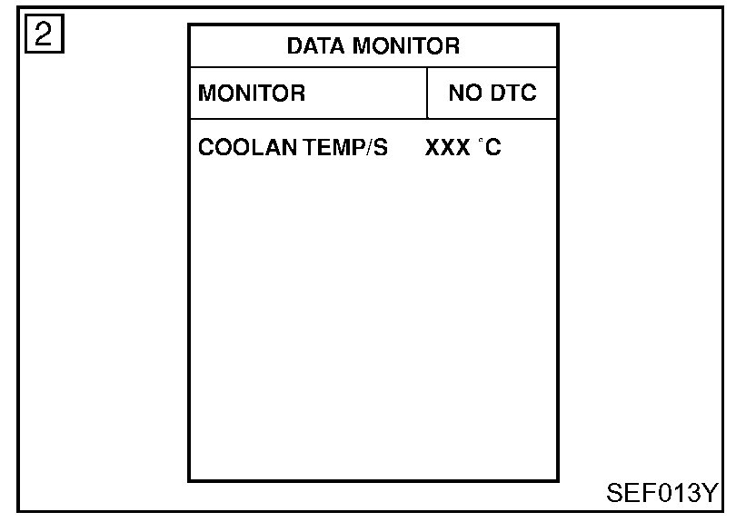

2. Select "DATA MONITOR" mode with CONSULT-II.
3. Crank engine for at least 2 seconds and run it for at least 5 seconds at idle speed.
4. If 1st trip DTC is detected, go to "Diagnostic Procedure". If 1st trip DTC is not detected, go to next step.
5. Maintaining engine speed at more than 1,000 rpm for at least 5 seconds.
6. If 1st trip DTC is detected, go to "Diagnostic Procedure".

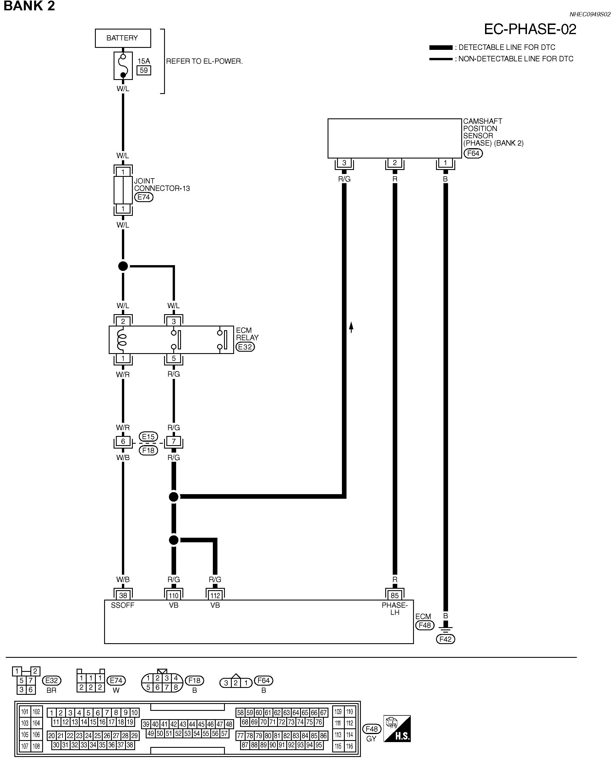

EC-PHASE-02
pic 5

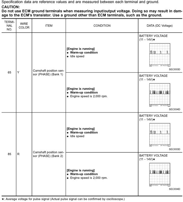

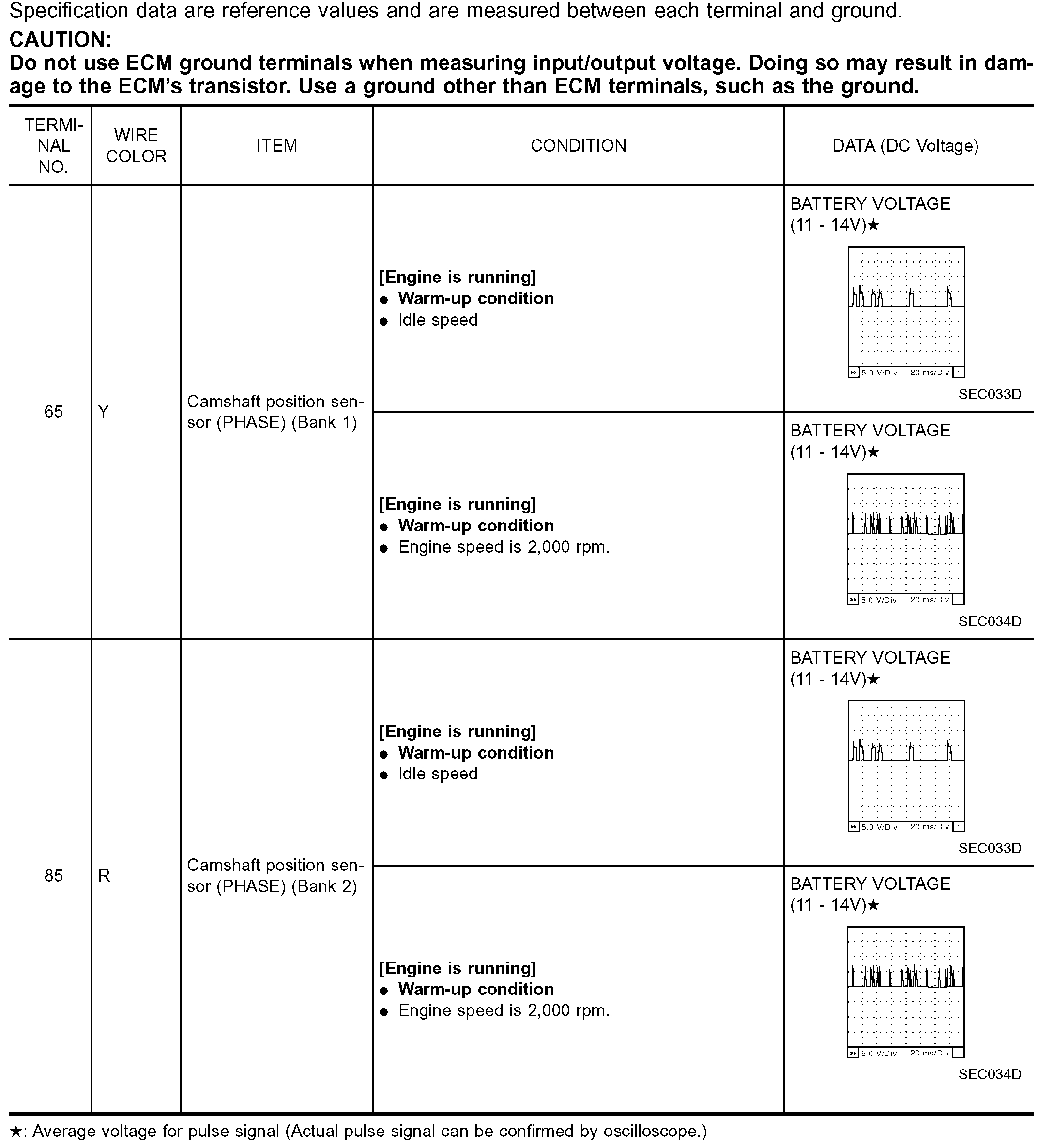

ECM Terminals And Reference Values
pic 6

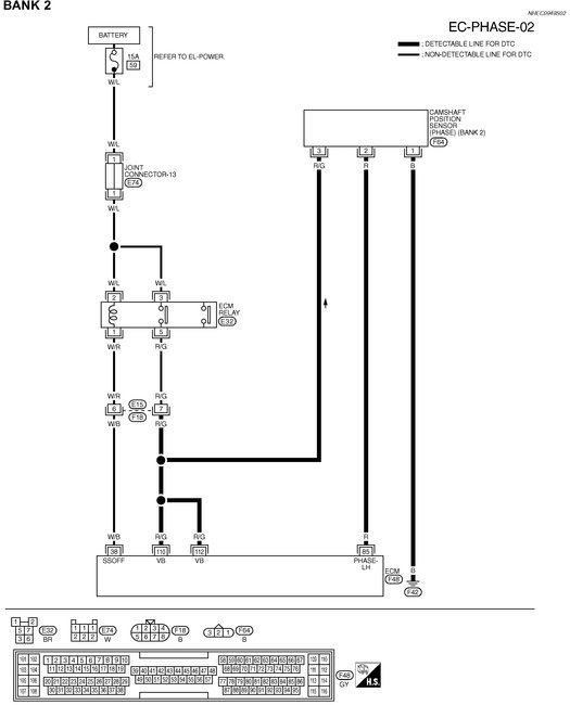

Wiring Diagram

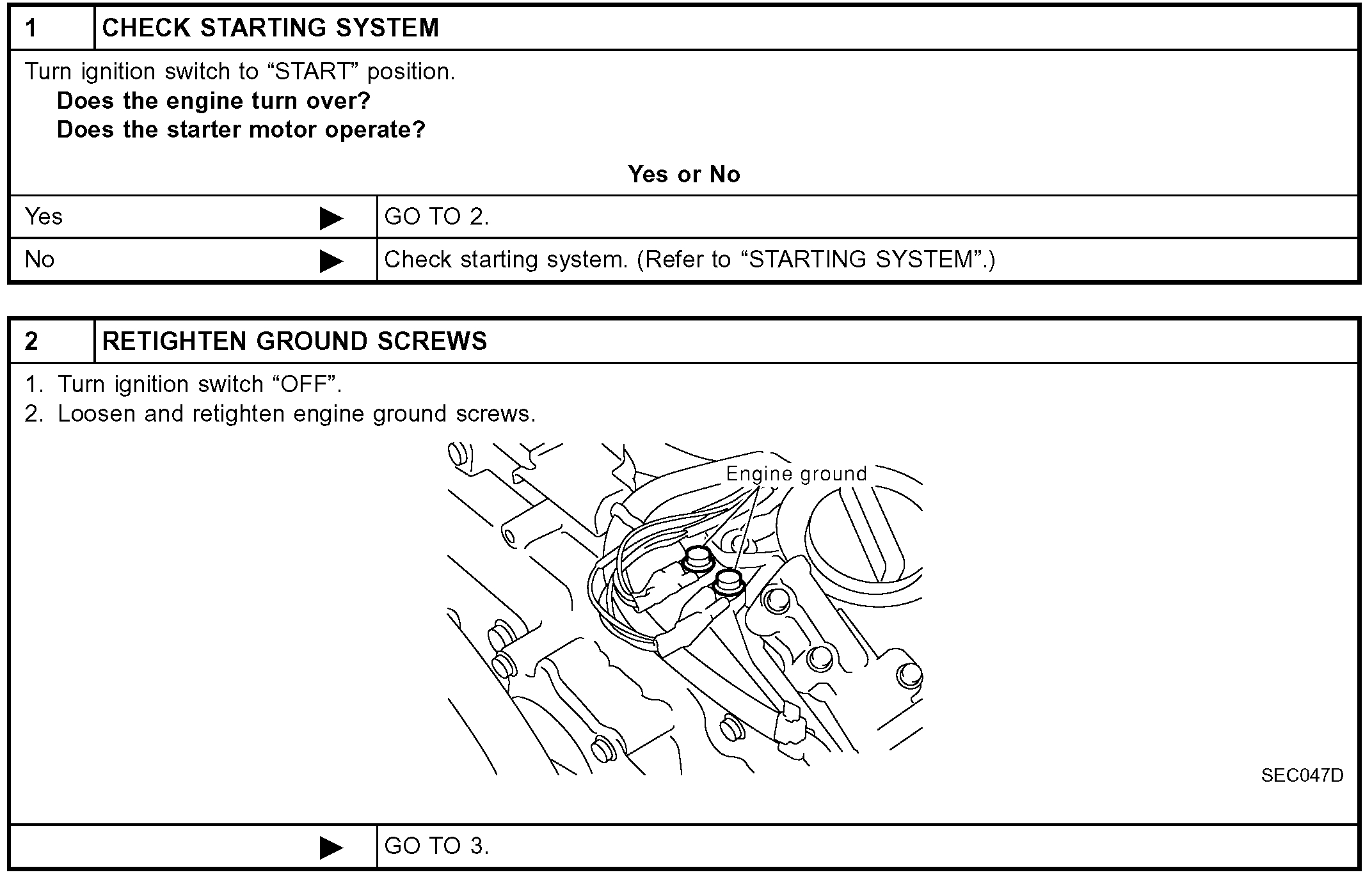

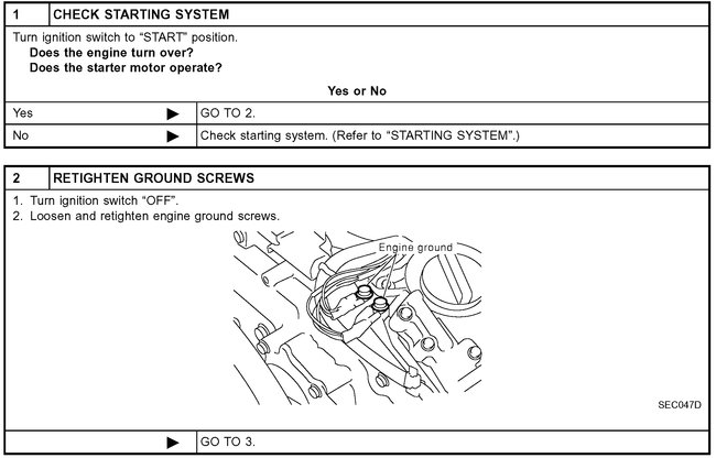

Step 1 - 2
pic 7

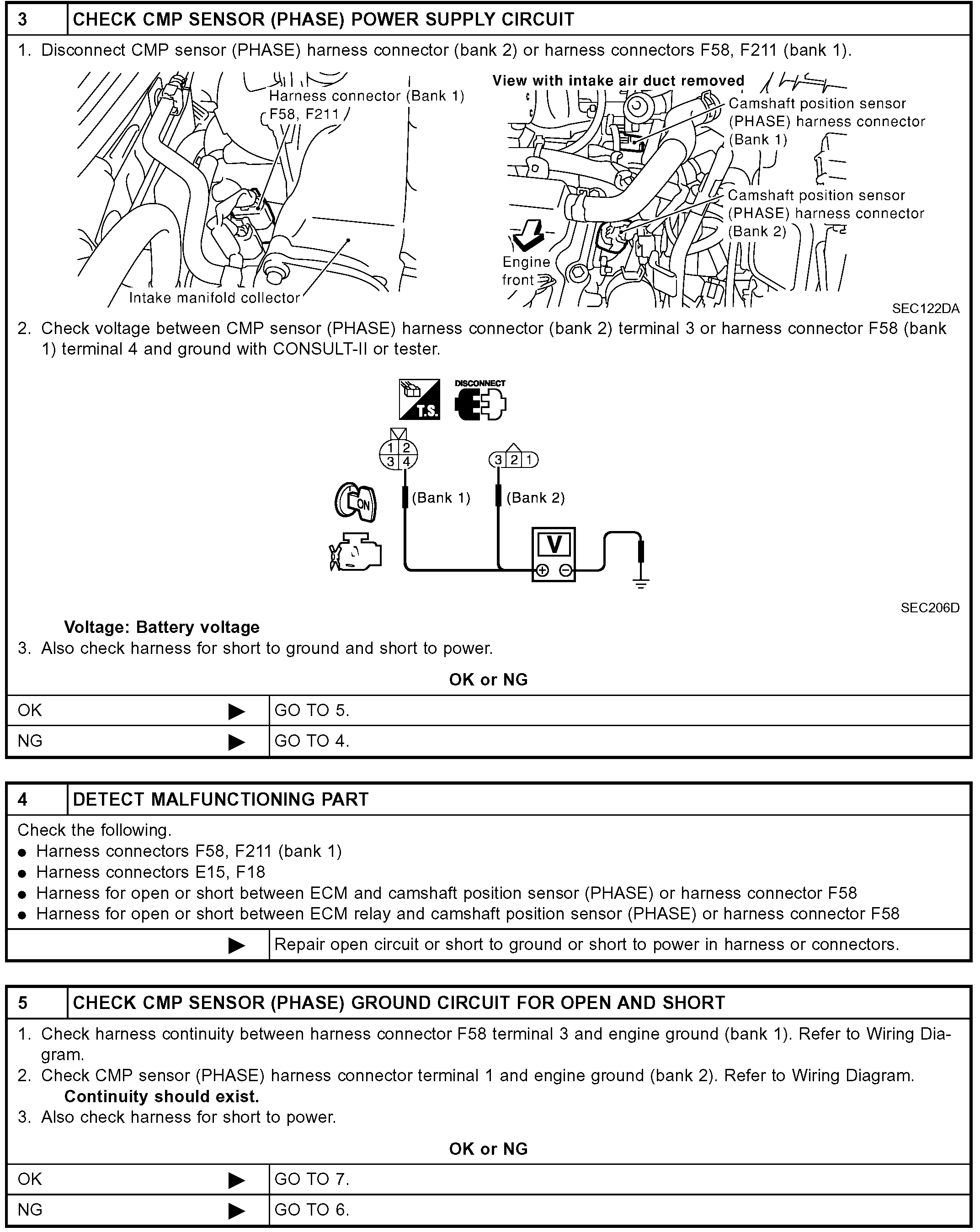

Step 3 - 5

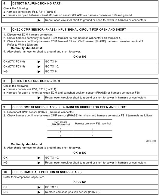

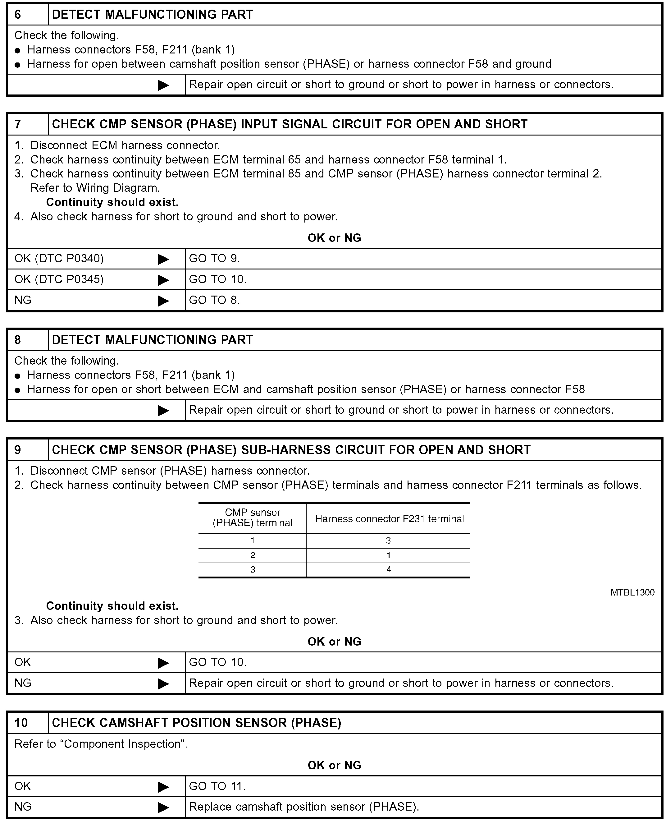

Step 6 - 10
pic 9

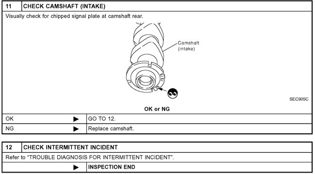

Step 11 - 12
pic 10

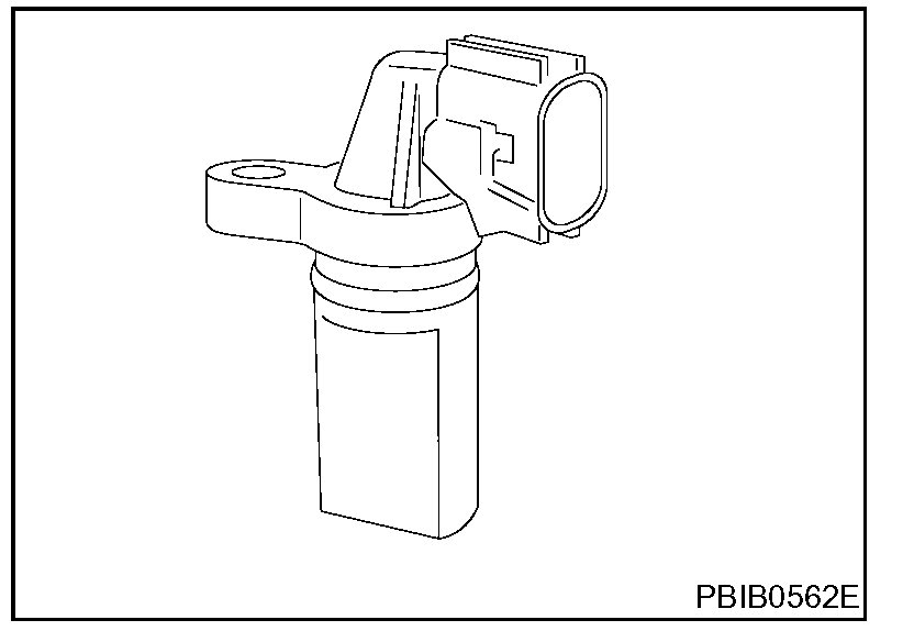

CAMSHAFT POSITION SENSOR (PHASE)
1. Loosen the fixing bolt of the sensor.
2. Disconnect camshaft position sensor (PHASE) harness connector.
3. Remove the sensor.

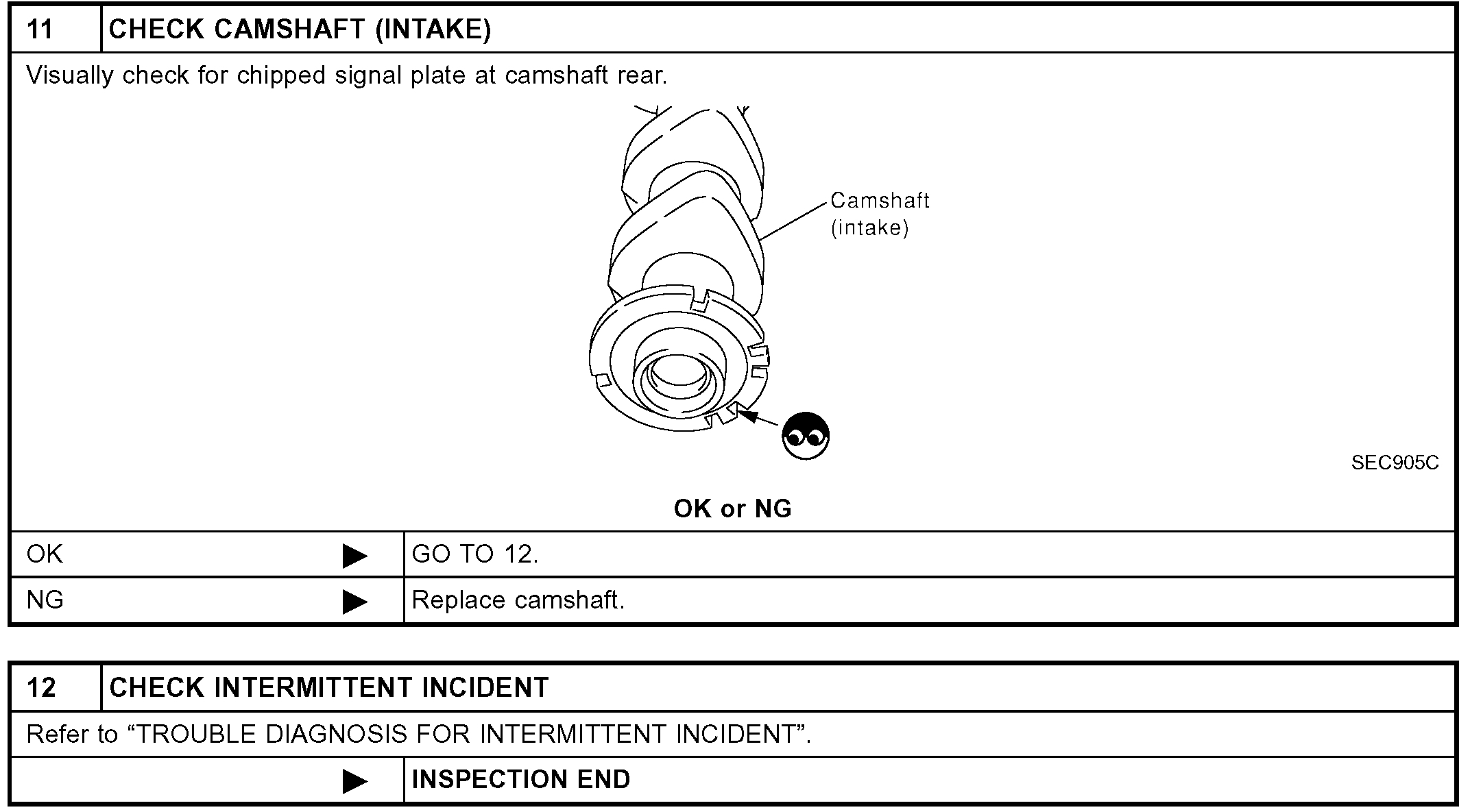

4. Visually check the sensor for chipping.
pic 12
pic 13

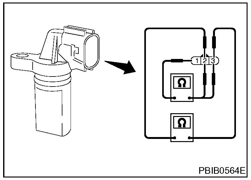

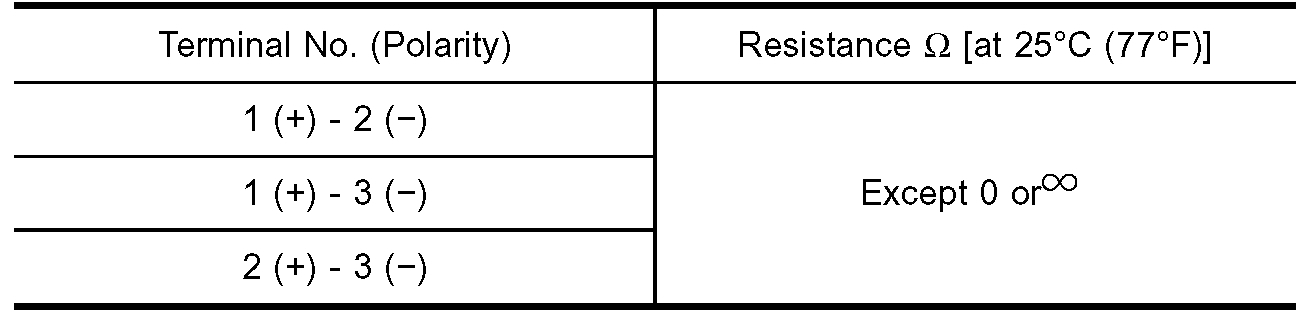

5. Check resistance as shown in the figure.
