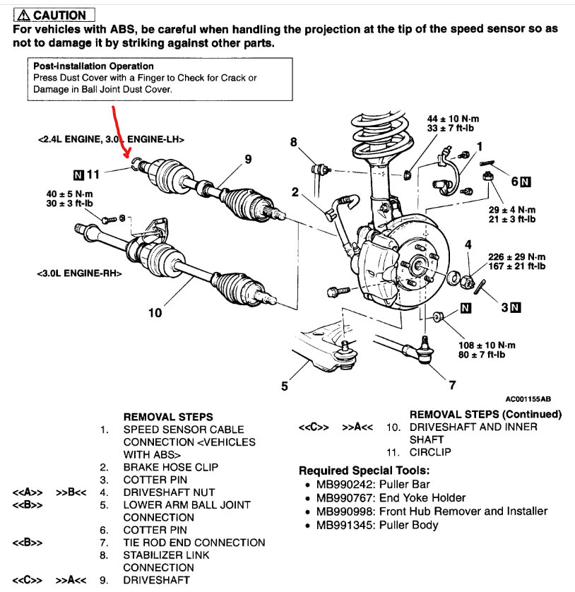

I was driving and went across a drain and my axle fell off had the lower control arm replaced but now car will not move out of gear it will shift gear but it will not move
Feb 26, 2015 at 8:35 AM
HMAC300
  • 48,601 POSTS
if the CV axle fell out then it probably didn't get reseated all the way back to transmission if it's reseated all the way then it should fix the problem. Also make sure teh "C" clip is installed on the axle. Check out the images (below). Please let us know what happens.
