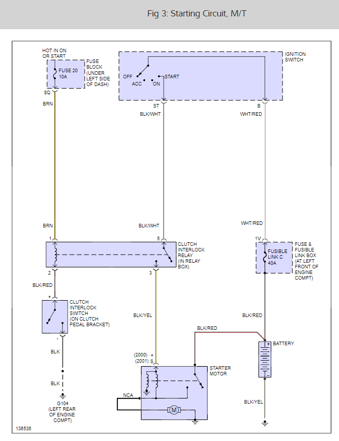

car will not turn over when you turn the key
160,000 MILES • 2.0L • 4 CYL • 2WD • MANUAL
MENTHOMAN48
Battery is good, all dash lights come on when keys is turned on but then nothing when you try to start it. I have jumped the starter so the starter is fine. But when the key is turned then nothing happens.

Check for twelve volts at the small solenoid wire on the starter with the key on crank, if nothing check that the ignition switch is actually switching, start here.

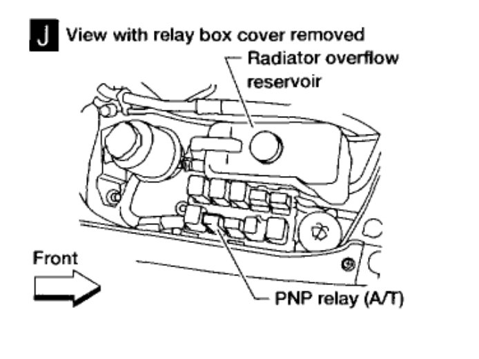

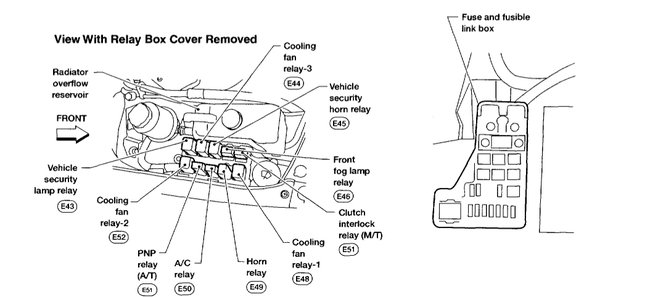

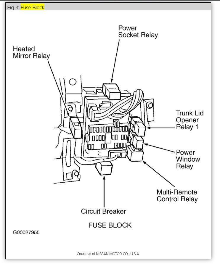

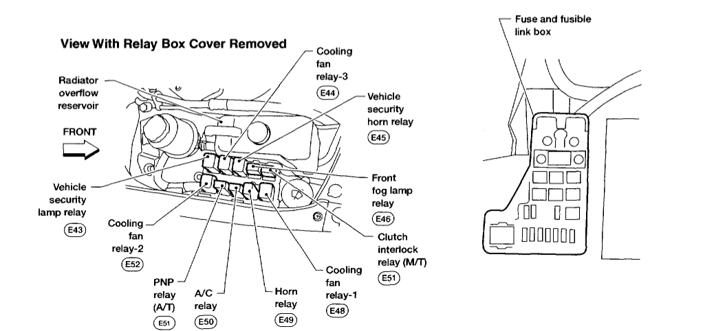

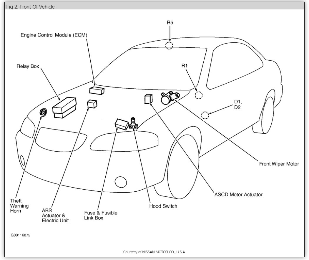

Also, you may want to check the starter relay for issues. In the relay box, locate the starter relay. Find another relay with the same part number and switch them to see if that is the issue.

Check the relay first and see if you get switched power there as well.

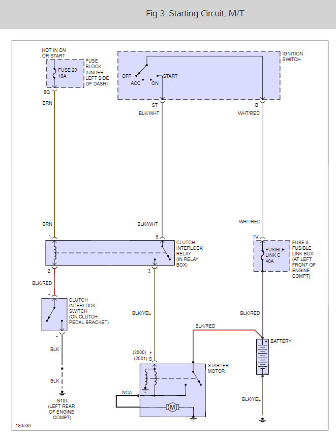

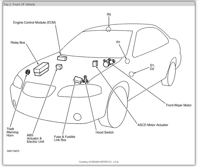

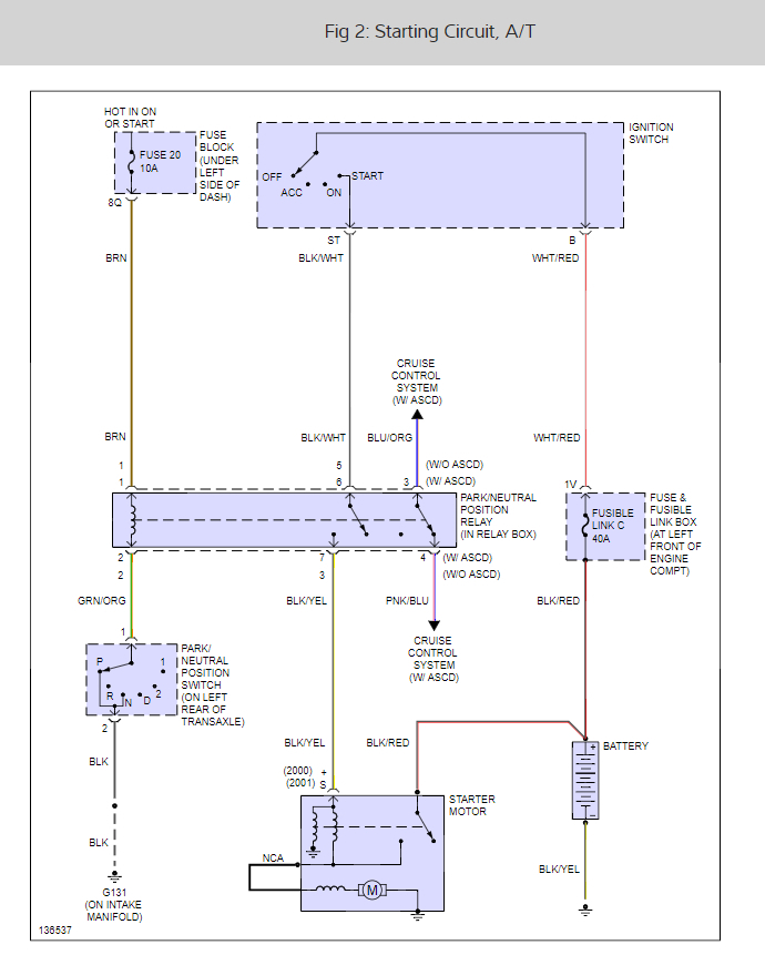

Here are some starter wiring diagrams and a couple of guides to help you run a few simple tests to figure out what the problem is:
and
Both auto and standard transmission featured.
Please let us know what you find. I am interested to see what it is.
