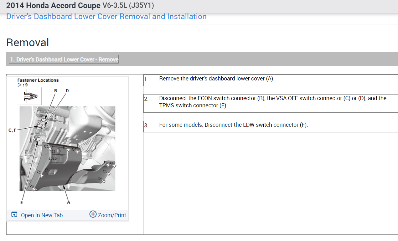

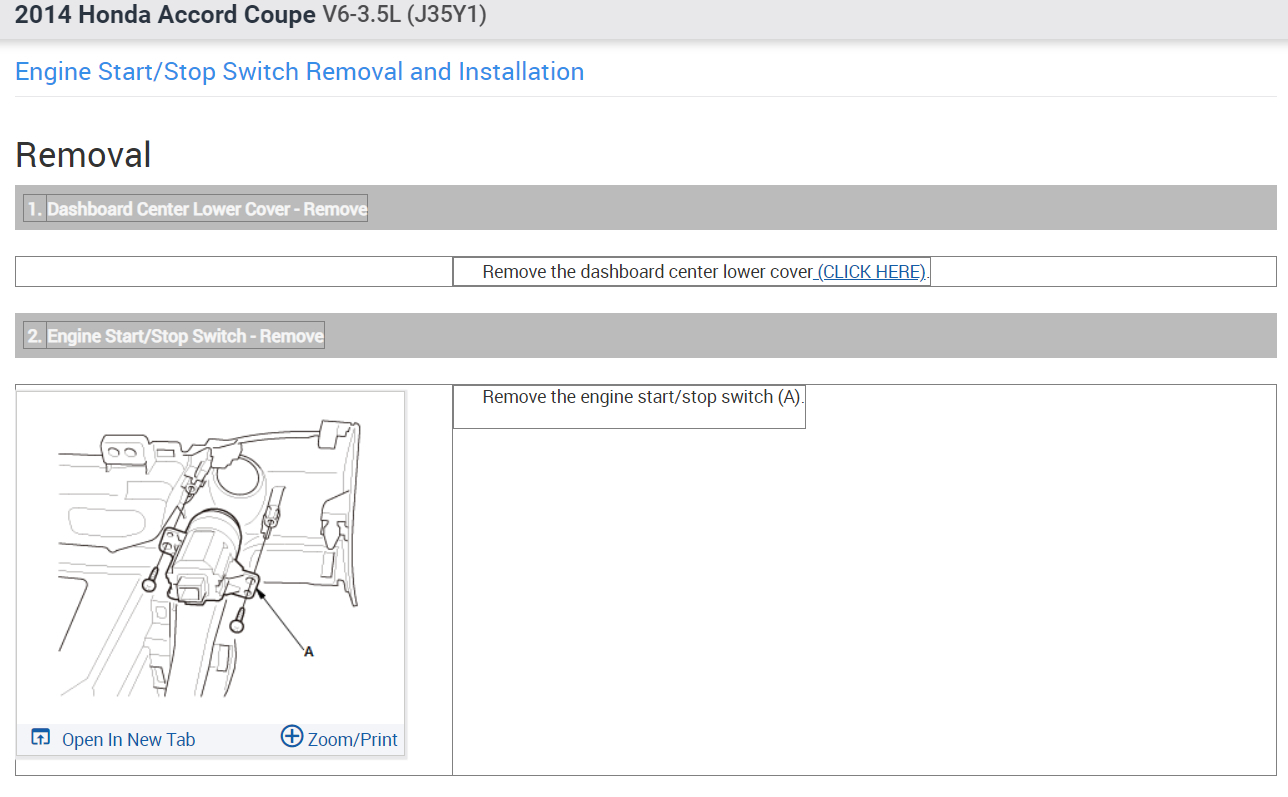

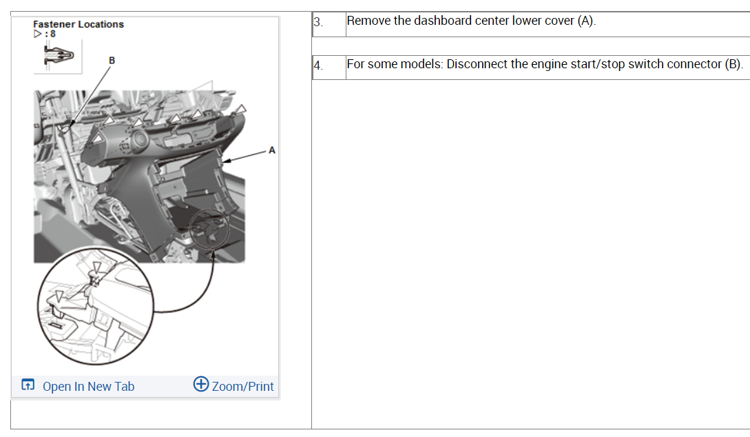

Vehicle will not shut off by push button. I disconnected the battery hoping it would reset itself, and that didn’t work.
Dec 21, 2023 at 1:08 AM
  • 55,845 POSTS

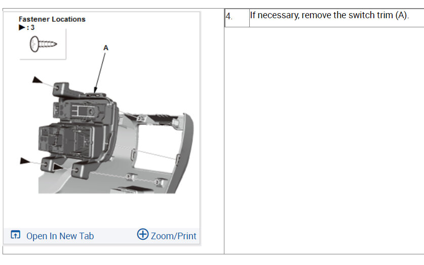

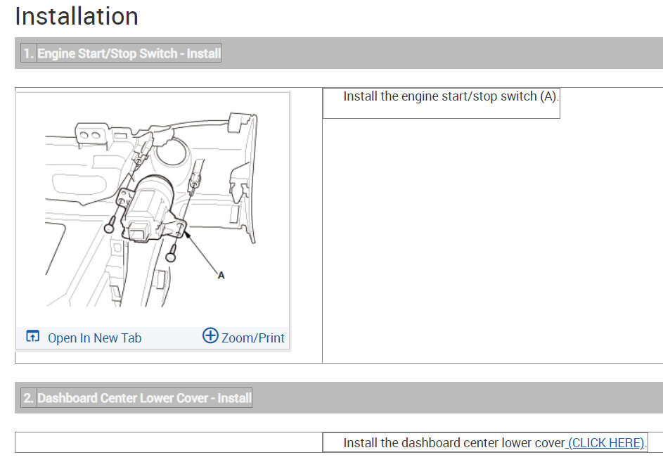

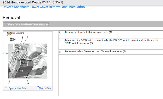

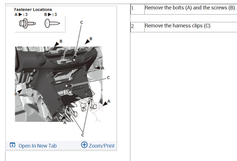

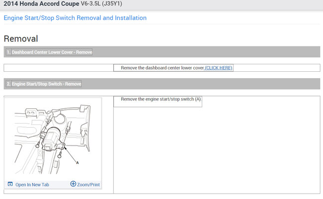

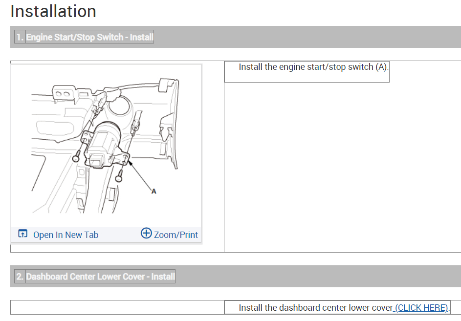

So, is the car still running? If so please pull out the PGM-FI relay in the main fuse panel under the hood, this will make the engine stop running. Here is how to change the start/stop switch out. Check out the images (below). Please let us know what happens.
