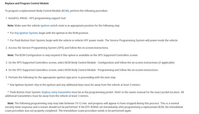

When put the car in park turn the keys off and then still runs.
Nov 21, 2022 at 3:37 PM
  • 55,412 POSTS

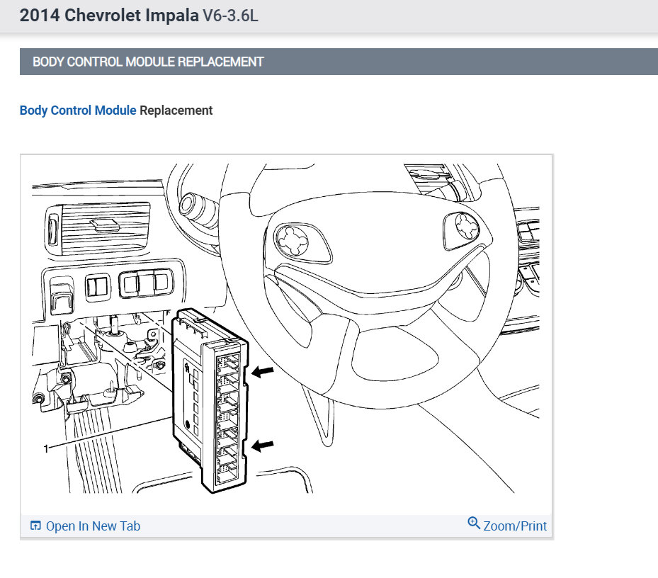

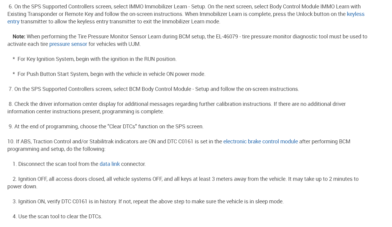

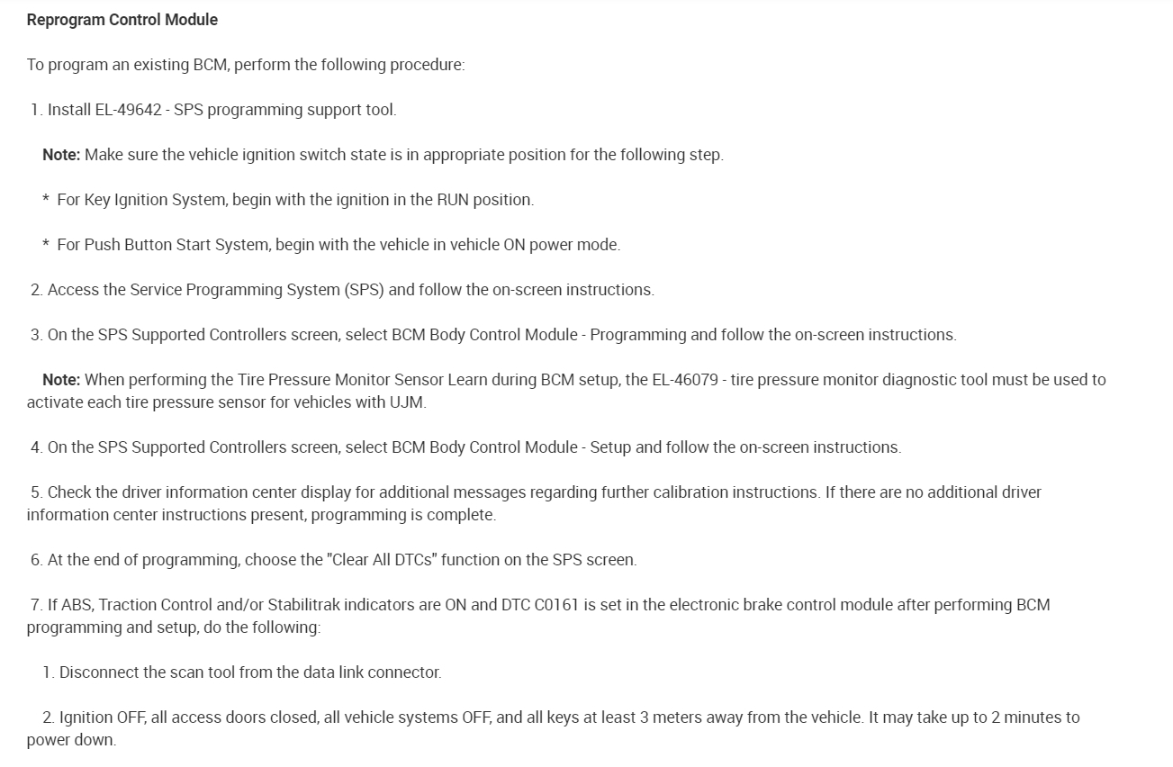

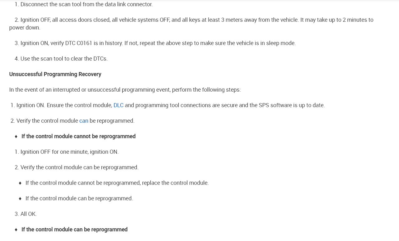

This happens when the BCM goes out, (body control module) but to be sure we should do a CAN scan, you can get a CAN scanner (Controller Area Network) from Amazon from about $32.00.
https://youtu.be/u-4syLc-ifQ
and
Amazon CAN scanner link:
https://amzn.to/3sX8MCX

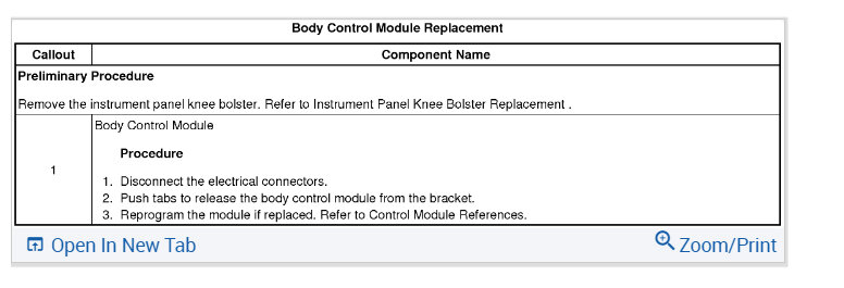

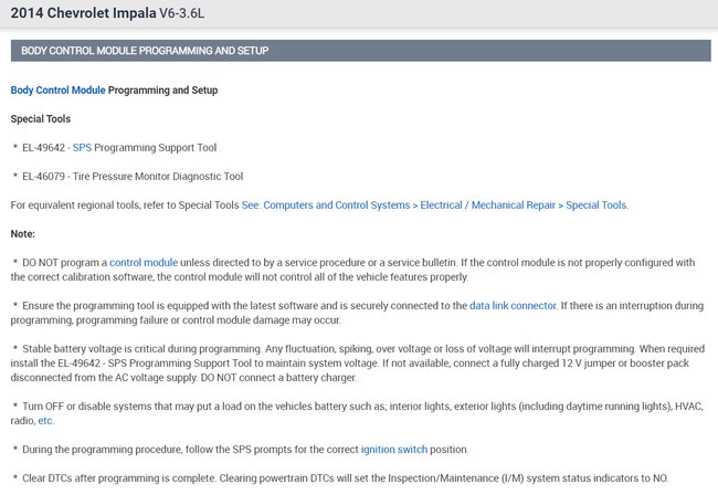

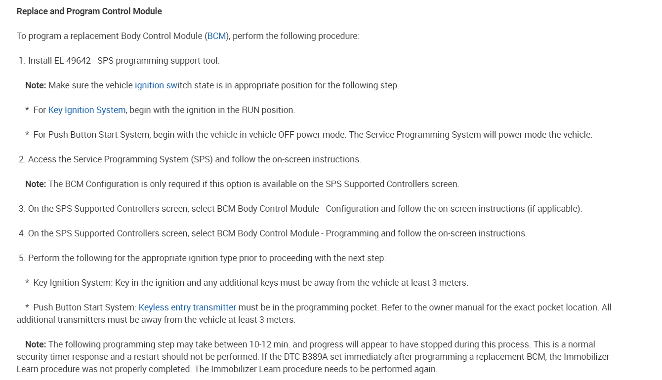

Here is how to change the BCM out which includes the location as well. You can find a rebuilt unit by searching Google or Ebay which the programming is already done and ready for installation, have your VIN number ready. Check out the images (below). Please let us know what happens.
