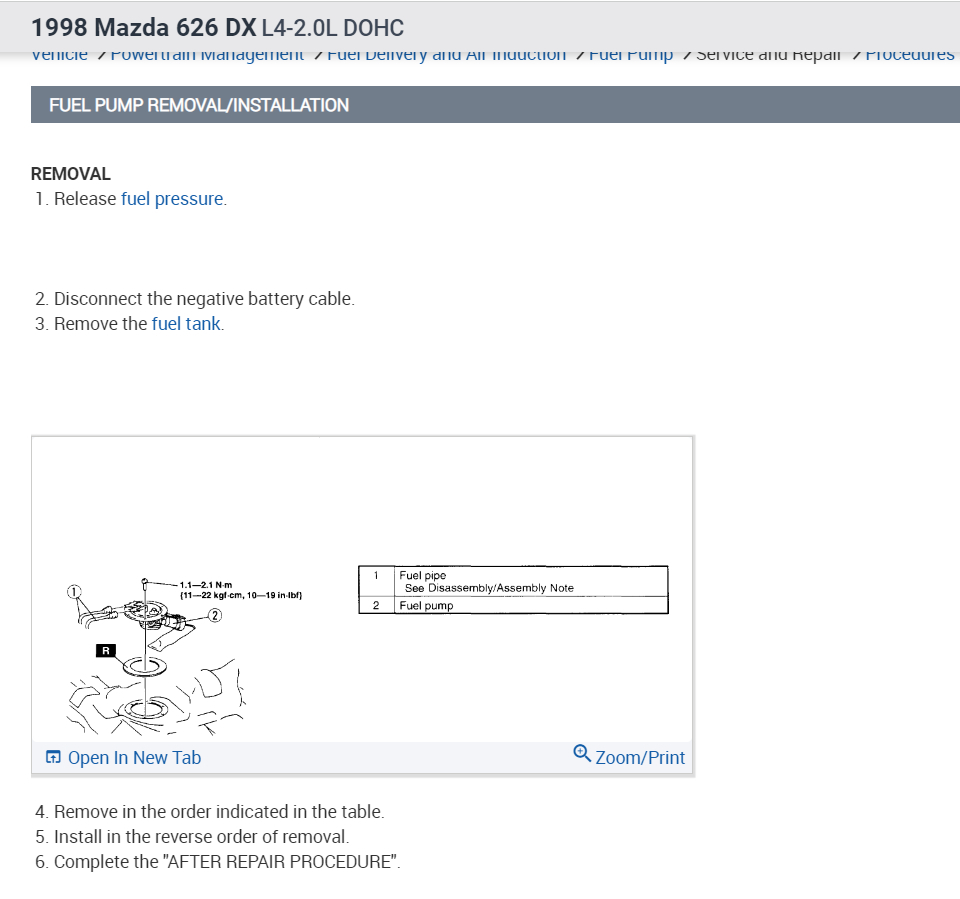

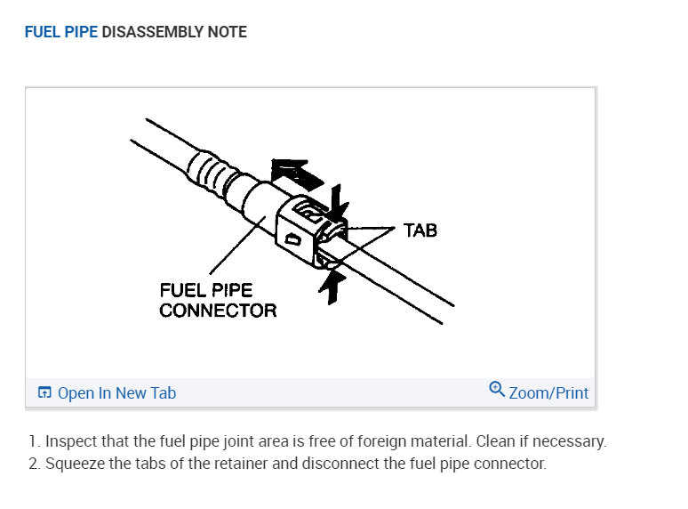

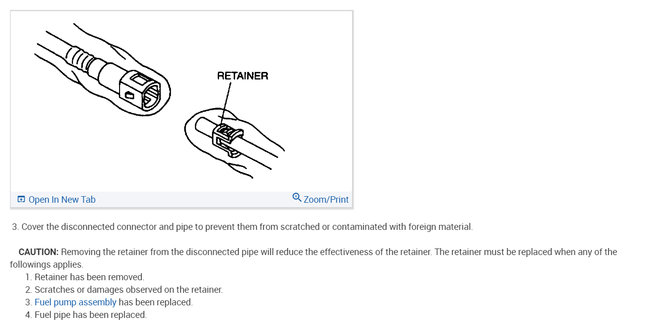

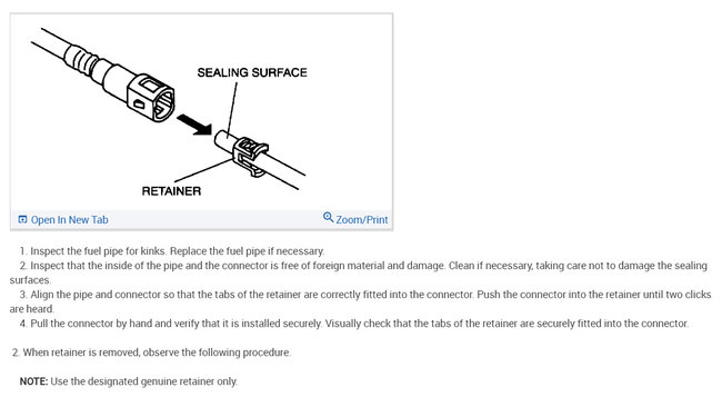

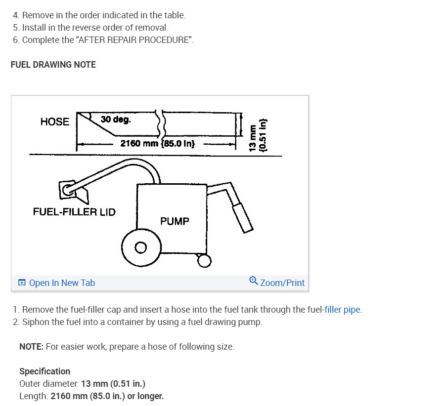

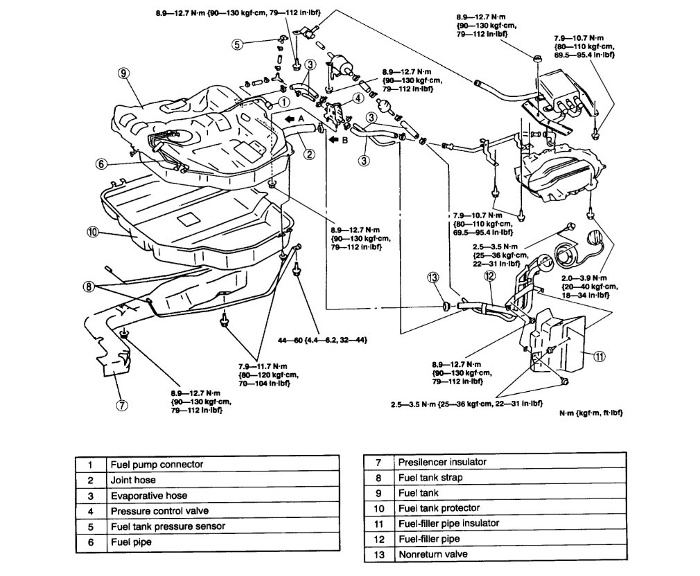

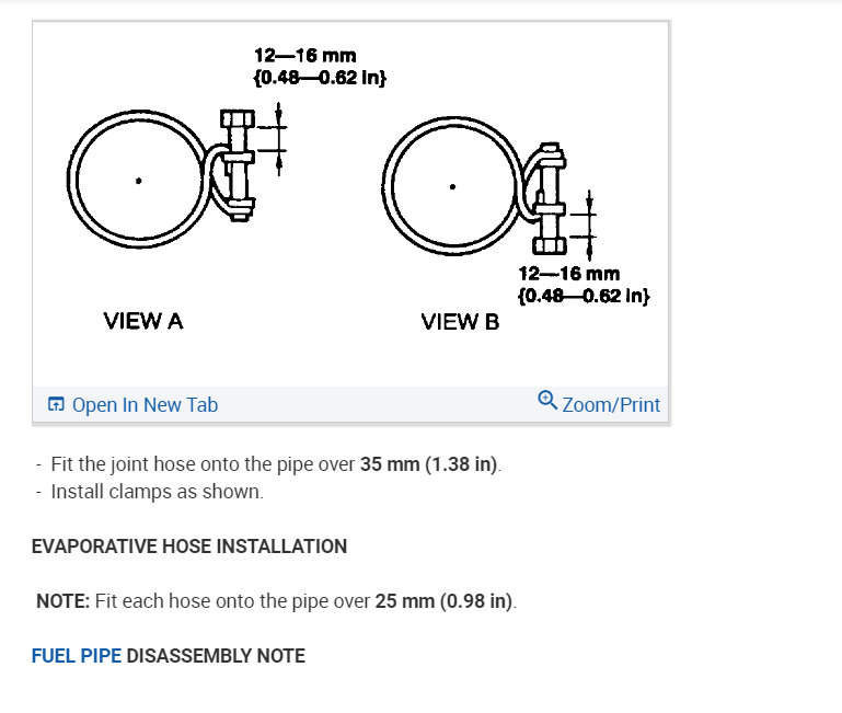

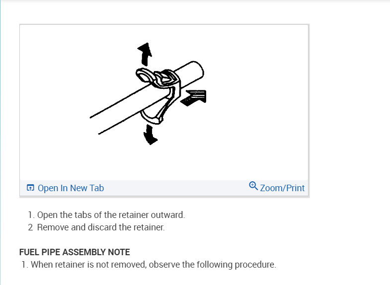

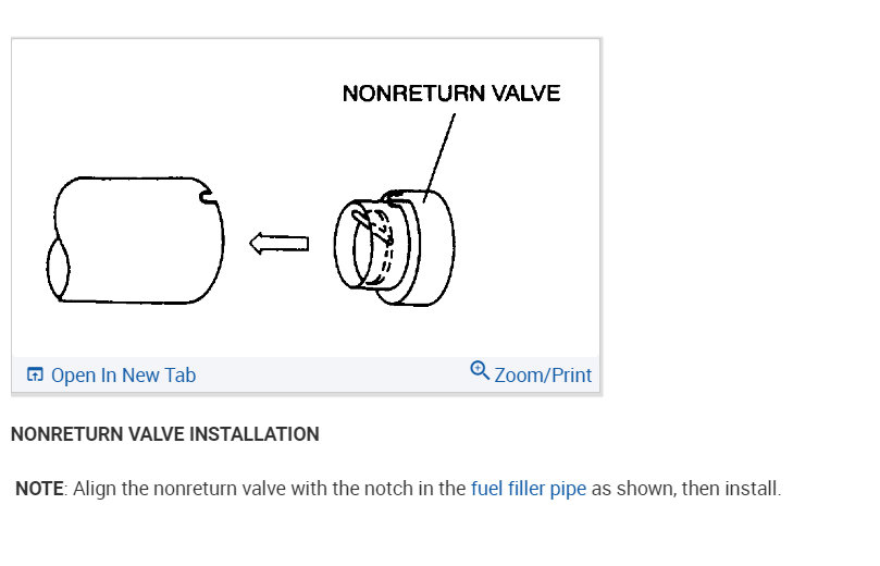

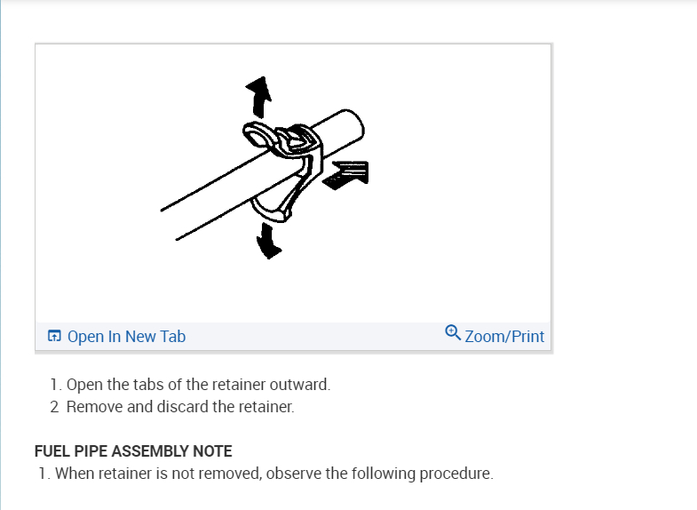

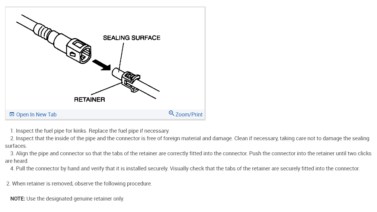

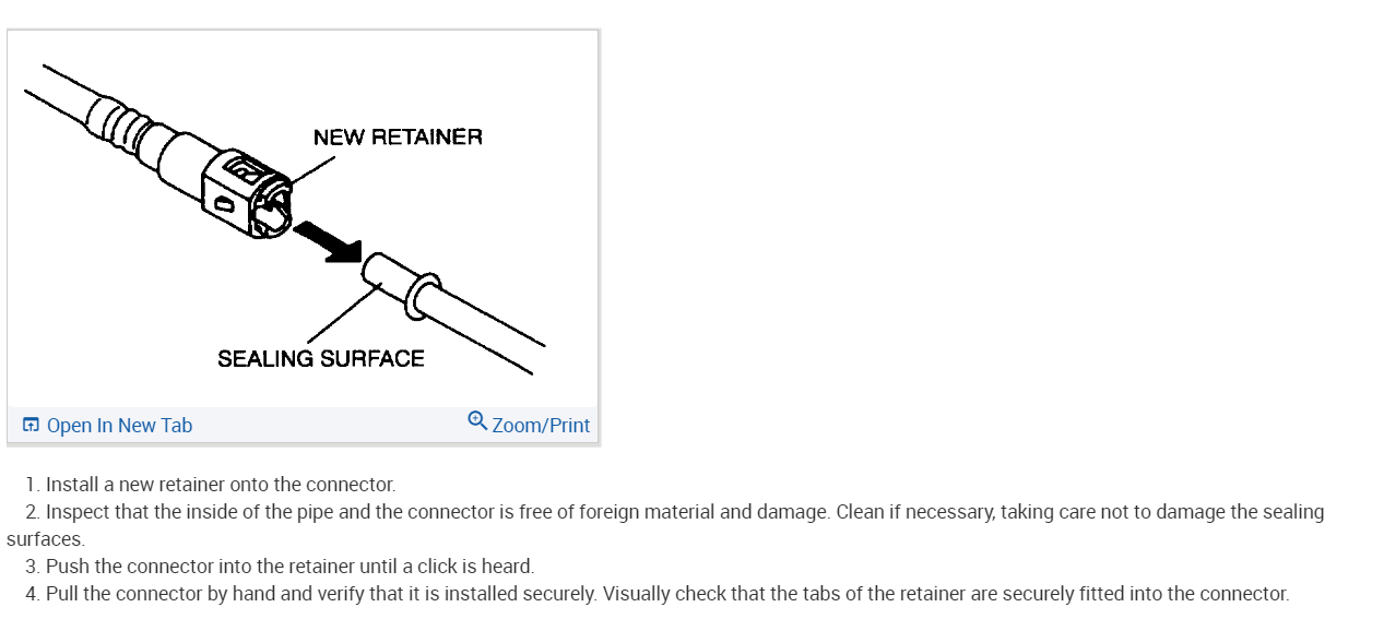

Yep, you should hear the fuel pump in the tank when the key is turned on. here is how you can replace the fuel pump in the diagrams below. This is a generic guide below to show you what you are in for when doing the job. Also, have you run the codes?

I installed the fuel pump, and I can hear it running when I turn the key on and stops. I then crank it and tries to start for a moment. Then it keeps cranking without start. I primed it twice and ran for a few seconds. What do you advise?

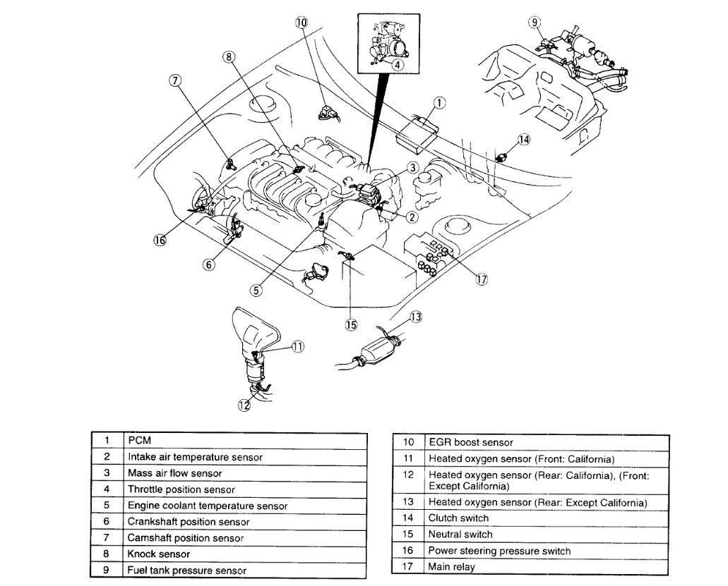

The problem with the engine not starting happened after I replaced the intake manifold gasket because of a vacuum leak. I had to remove several pieces of hardware from the intake manifold and I wonder if I didn't connect something correctly or damaged something.
Jul 27, 2022 at 11:21 PM
  • 55,500 POSTS
Yep, that is what it sounds like there are ground wires that you need to make sure are connected to the engine. Were there any codes? We should check for spark as well.

Ground cables are okay. Strange that even when the car was running recently, I could not get any codes even when I pulled some sensor cables off on purpose. The engine still wants to start after some rest. Could the ECM be bad?
Jul 29, 2022 at 9:58 AM
  • 55,500 POSTS

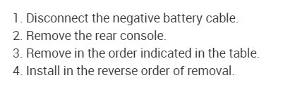

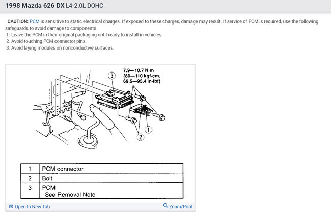

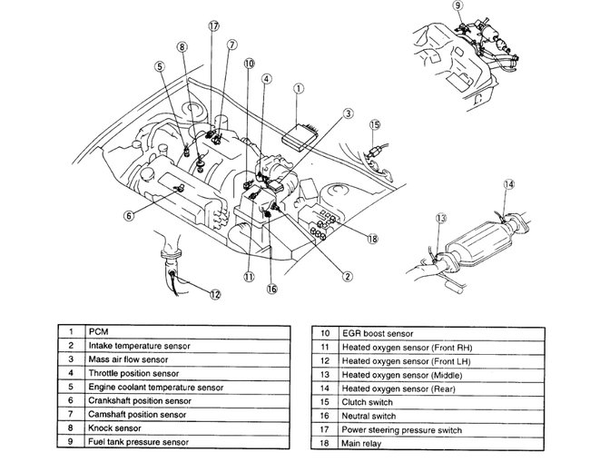

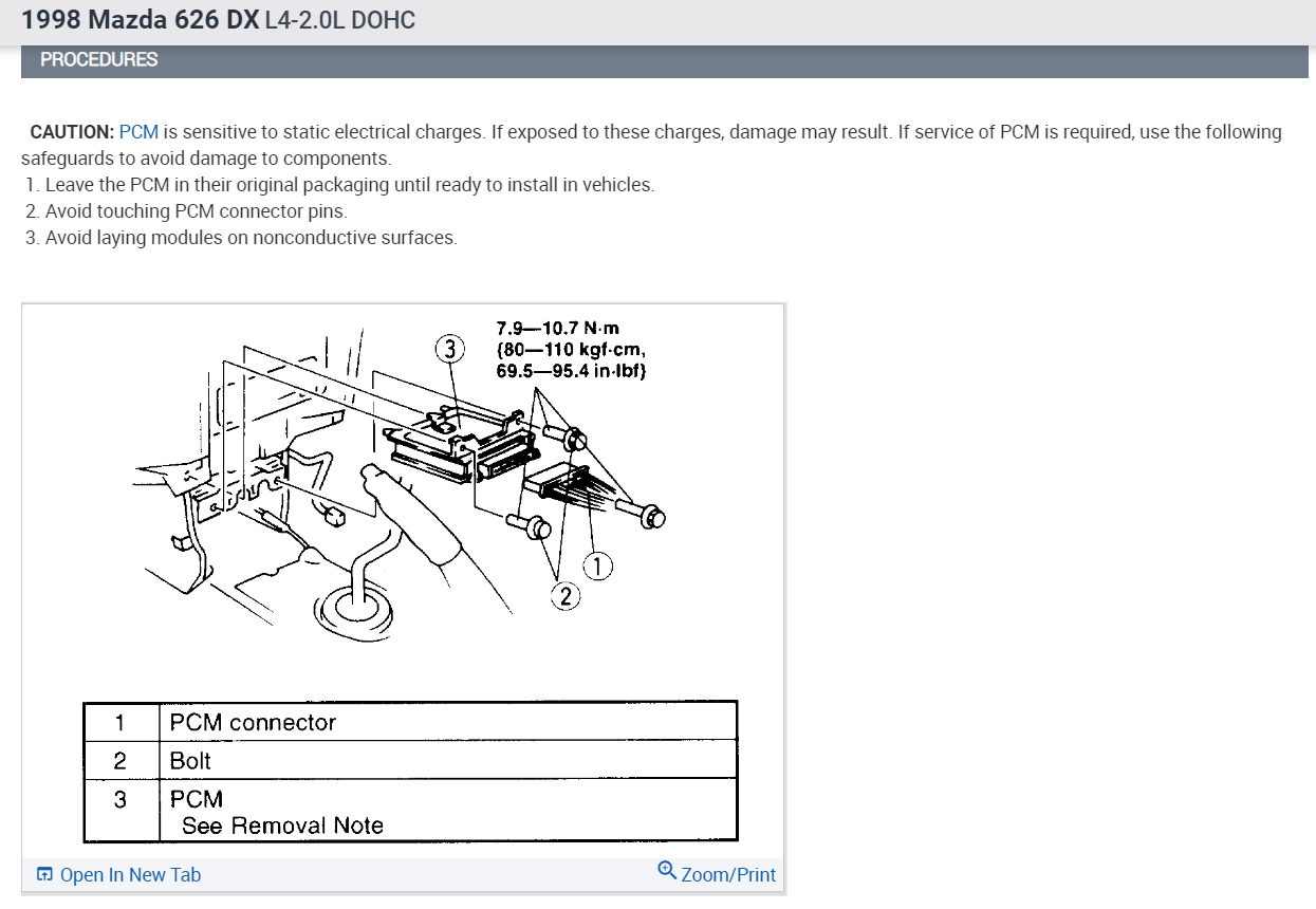

That was my next suggestion, here is the location and how to change it out. Disconnect the battery first.

Okay, you might be able to find a used ECM on Ebay. Also, I would change out the fuel pump relay again, it could be overloads from the bad pump. Here is how you can change the PCM out in the diagrams below. The ECM is plug and play.

I ordered a used ECM from eBay. Will update you after I install it.

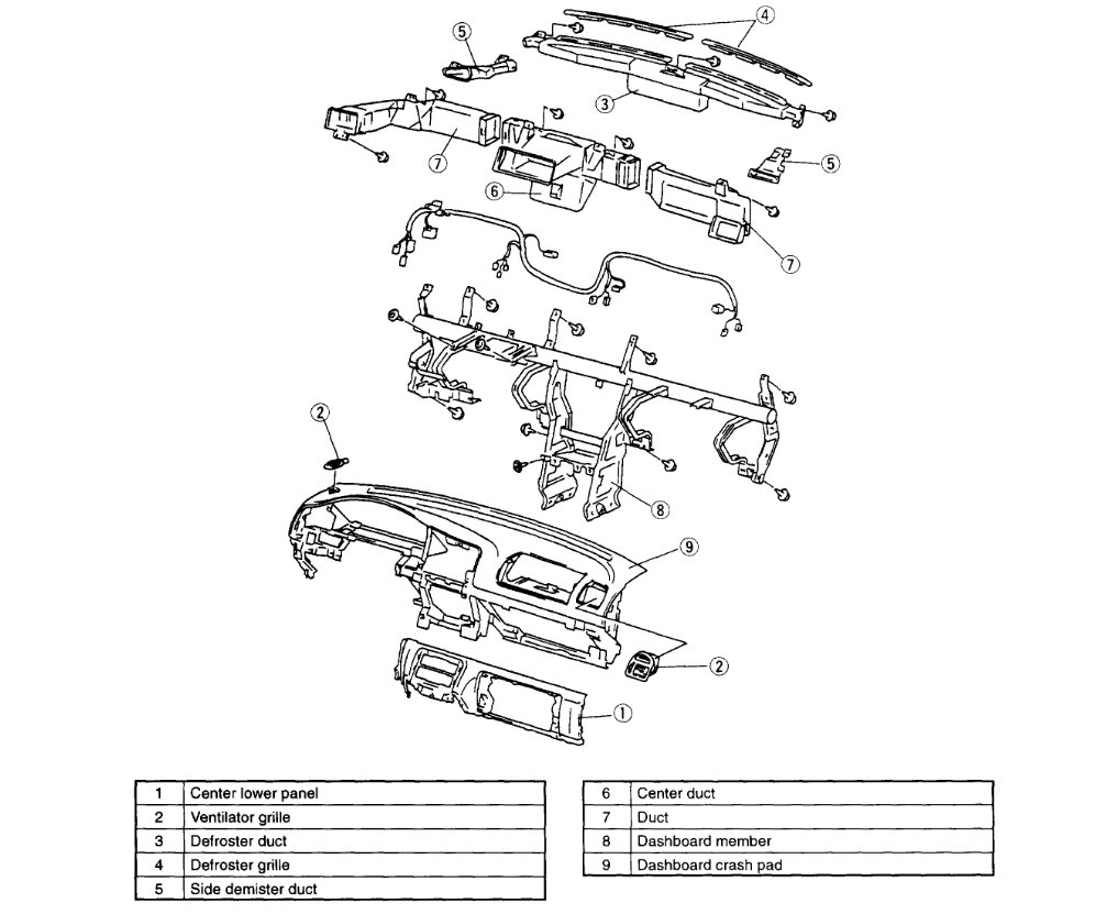

I can't figure out how to access the ECM (how to remove dash parts).
Aug 3, 2022 at 2:49 AM
  • 55,500 POSTS
This dash diagram should help. Check out the diagrams (below). Please let us know if you need anything else to get the problem fixed.

Just installed the ECM from eBay it cranks but doesn't start like before. I primed it a few times and it acts like it want to start but nothing.

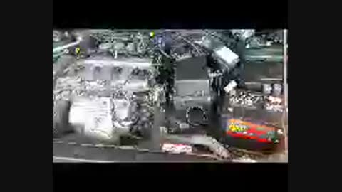

When the engine is cranking over does it sound normal? The engine does not need to run to show codes. Can you please shoot a quick video with your phone so I can hear the engine cranking it may have jumped time.
Aug 4, 2022 at 12:05 PM
JOSE VILLARREAL
  • 18 POSTS
Video of engine cranking attached. It sounds normal. The engine does not show codes even if I disconnect some sensors. Could the new ECM be bad? How about a poorly installed crankcase position sensor?

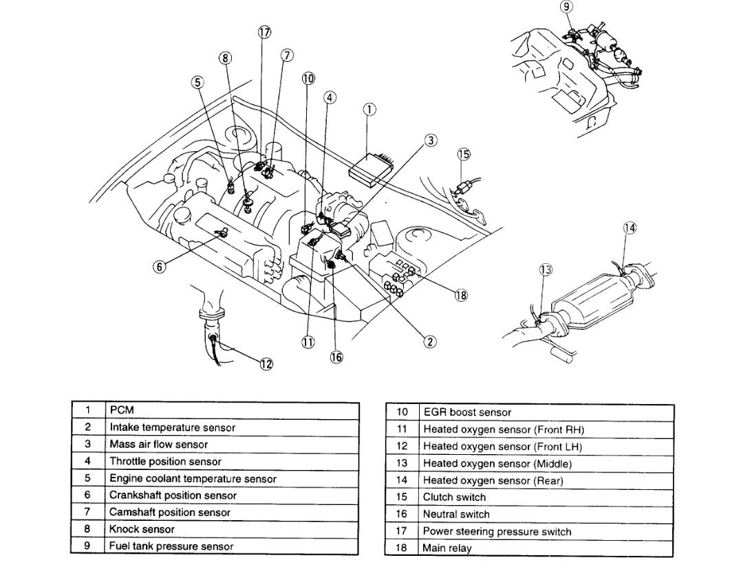

Thanks for the video, did the engine do the same thing with the old ECM? it sounds like the ignition timing is way off. If the engine condition is the same lets install a new crankshaft position sensor. When you prime it and it starts does it run normally? Here is the location of the sensor. let me know please.

I installed a new crank case positions sensor and I wonder if I didn't do it right? The engine tries to start by priming, but it doesn't start. The cranking is the same as with the old ECM.

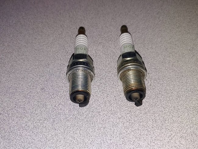

Let's remove the spark plugs to see what they look like please upload a picture of the plugs once removed.
https://www.2carpros.com/articles/how-to-change-spark-plugs
Aug 6, 2022 at 12:36 PM
JOSE VILLARREAL
  • 18 POSTS
The spark plugs were installed with correct gap after the trouble getting the engine started. Like I said before the spark plug cables, coil, injectors, fuel pressure regulator, fuel and air filters, fuel pump, are new and were replaced after the engine would not start. The car has 150,000 miles and when it was running it started right away, no smoke and at high RPMs the engine didn't miss or backfire.

The new ECM shows two codes: 1. P0340 Position sensor A circuit Bank 1 or single sensor. 2. P0102 Mass air volume air flow A circuit low?
I installed a new Camshaft position sensor, but I got no power. How do I trace the cables from the sensor to the ECM?
You mentioned checking the grounds, but I can't find a chart showing the grounds. I hope you guys can help me.
