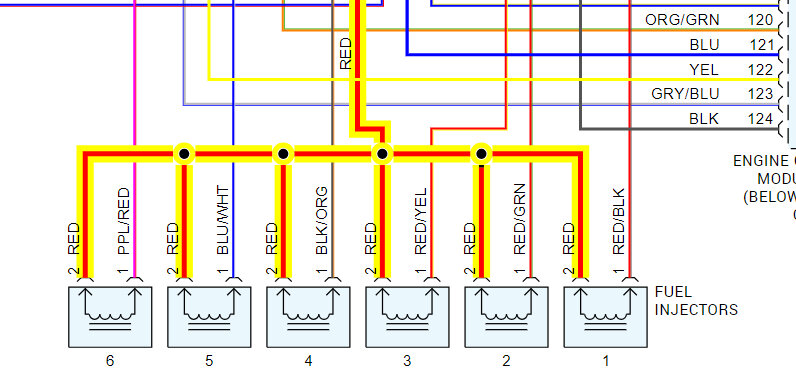

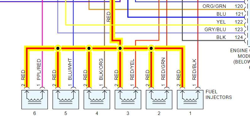

Each fuel injector will have two wires to it. Each injector will have a solid red and then one of a different color. With the key in the run position, check to see if there is power at the red wires.
Let me know the results.
joe
See pic below.

Injectors all have power and are working,car started and ran good then won't start ,seems flooded and sparkplugs are new but maybe fouled plugs trying to start..can you help me??

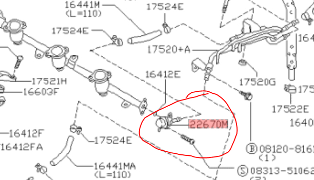

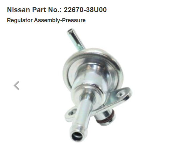

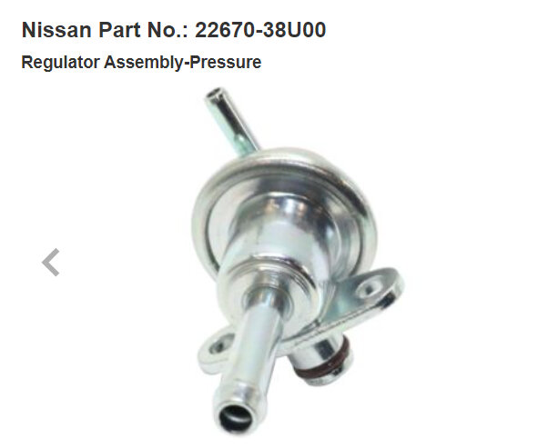

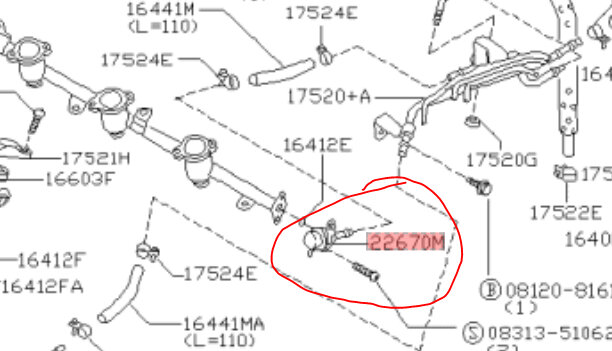

You could check the fuel pressure regulator. It is located on the end of the fuel rail. I found a couple of pics to help locate it.
Also, the first pic provides the OEM part number. The only problem is they are discontinued, so you may have to find an aftermarket one.
Make sure the vacuum hose to it is in good condition. Disconnect it and confirm there is no fuel being drawn into the vacuum hose.
