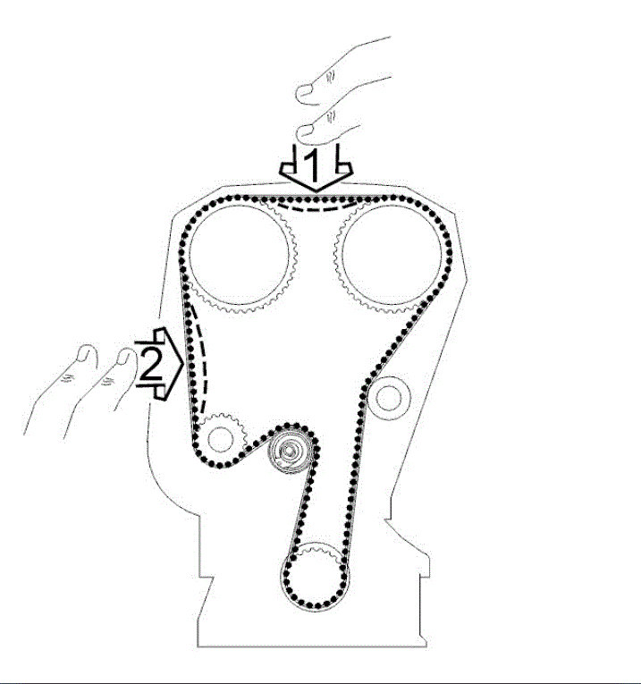

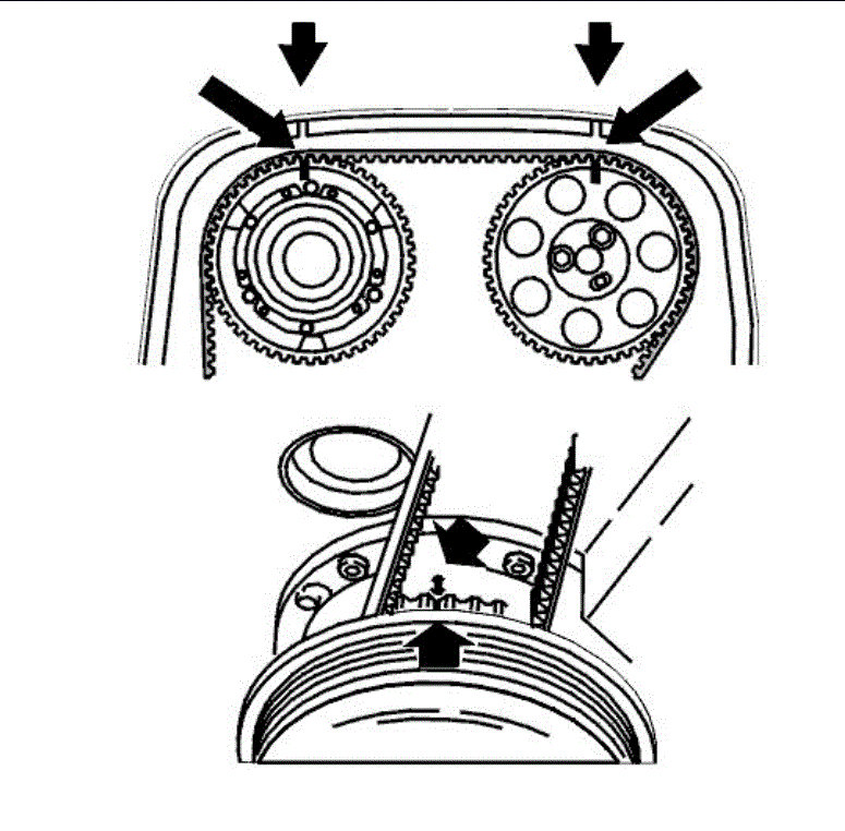

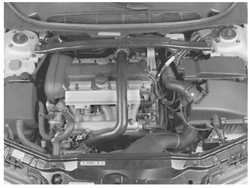

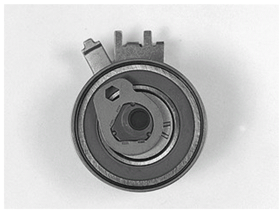

I changed my waterpump a couple days ago, along with the idler, and tensioner. Now my car will not start. The first time i tried it started then on the dash it read no oil pressure stop engine asap so turned it off. The second time i tried, it seemed like there was no chance. I'm not entirely sure what went wrong. I do know I lined up the top markings but I neglected to check the markings down below before putting on my timing belt. What could have caused the no oil pressure warning. I'm fairly new to working on cars and I'm not sure where i should look.
Mar 20, 2020 at 11:38 AM
Couple things. First, you have the T5 engine?

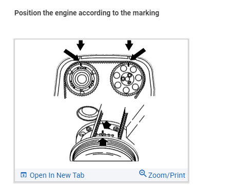

As for what could cause this, we definitely need to pull it down and inspect the timing. When you first pulled it off did you set the timing as shown in this diagram? If not, then we need to start here. This is the first step it tells you on the replacement of it.
Let me know if this is okay and we can move on from there.
Mar 20, 2020 at 11:50 AM
  • 110,248 POSTS
The lower (crankshaft pulley) needs to be on top dead center (TDC) to perform the timing. It sounds like that isn't what was done. If that is the case, it won't start. VInce, this isn't an easy one to do. However, I will provide you the directions for belt replacement. It explains how to remove and install a belt. Make sure you follow the directions. Also, I believe this to be an interference engine. Don't try starting it again until you confirm timing is correct. If the timing is far enough off, it can cause internal damage to the pistons and valves. The attache pics correlate with the directions.

Position the engine according to the marking
pic 2
- Remove the right front wheel
- Remove the nut from the cover in the wing liner
- Install the upper timing belt cover
- Turn the crankshaft clockwise until the markings on the crankshaft and camshaft pulley correspond
- Turn the crankshaft a further 1/4 turn clockwise and then back again until the markings correspond.
The markings are illustrated
- Remove the upper timing belt cover.

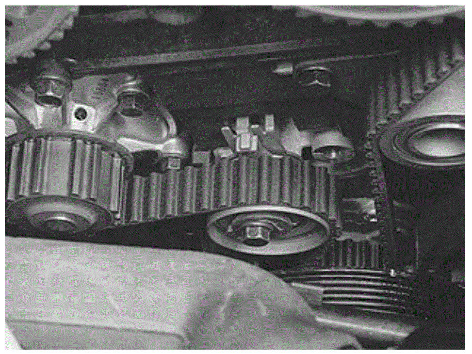

Slacken off the belt tensioner.
Slacken off the centre screw for the belt tensioner slightly.
Hold the centre screw still. Turn the tensioner eccentric clockwise using a 6 mm Allen key to 10 o'clock.
Remove the timing belt from the tension pulley, camshaft pulley and water pump.

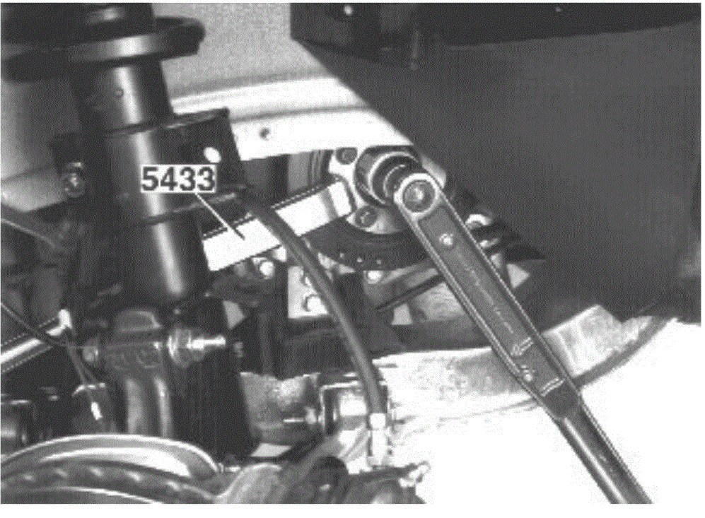

Remove the vibration damper.
Remove the oscillation damper. Use counterhold 999 5433 COUNTERHOLD See: Vehicle > Electrical / Mechanical Repair > 999 5433 Counterhold. Work the oscillation damper loose.

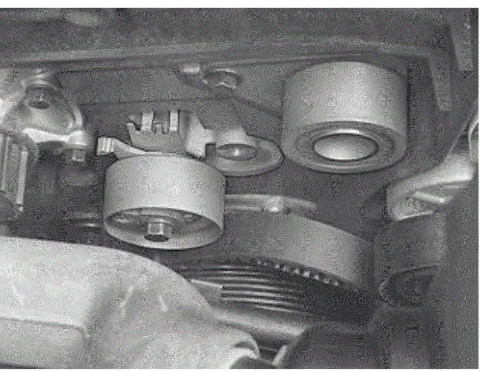

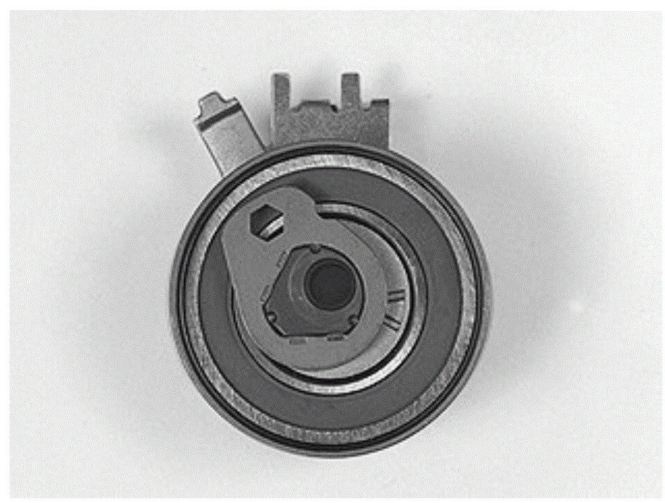

Checking the tensioner pulley and idler pulley
pic 5
Check bearing wear:
- spin the idler pulley and listen for noise.
If replacing with a new idler pulley, tighten to 24 Nm.
- spin the tension pulley and listen for noise.
When replacing, screw the tension pulley into place using the centre screw.
Screw in the centre screw by hand.
Ensure that the tensioner fork is centered over the cylinder block rib.
Ensure that the Allen hole on the eccentric is at "10 o'clock".

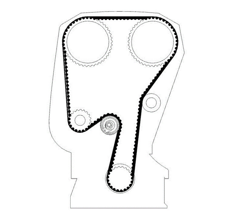

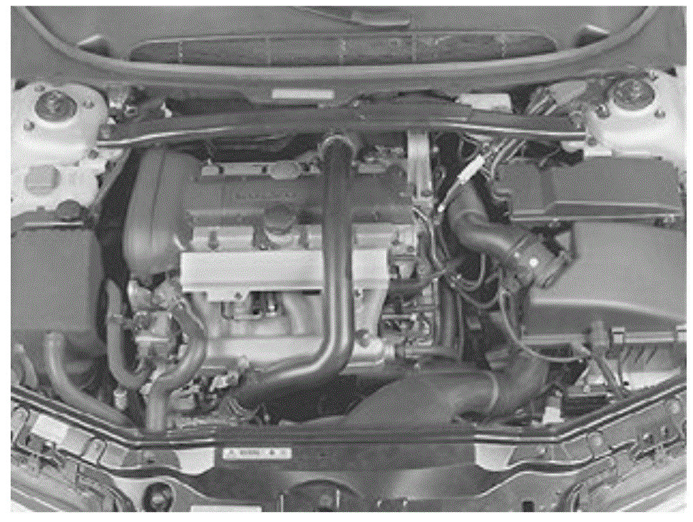

Installing the timing belt
pic 6
Note: For information regarding Variable Valve Timing see: Variable Valve Timing Actuator, Adjustments See: Variable Valve Timing Actuator > Adjustments
Also see Belt Drive, Assembly See: Timing Belt > Removal and Replacement > Belt Drive, Assembly
Install the timing belt over the pulley on the crankshaft.
Install the oscillation damper. Tighten the center nut to 180 Nm. Use counterhold 999 5433 COUNTERHOLD See: Vehicle > Electrical / Mechanical Repair > 999 5433 Counterhold.
Remove the counterhold and install new screws. Tighten the screws to 25 Nm. Angle-tighten 30°
Install the new belt in the following order:
- crankshaft
- the idler pulley
- intake camshaft pulley
- exhaust camshaft pulley
- water pump
- belt tensioner.

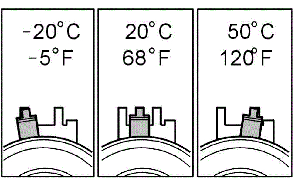

Tighten the timing belt
pic 7

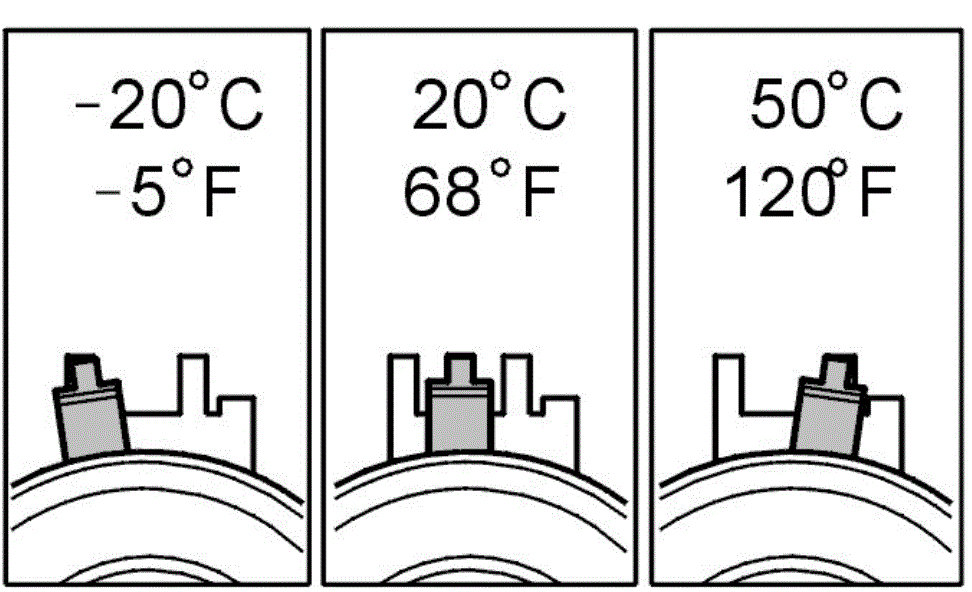

This adjustment is carried out on a cold engine. A suitable temperature is approximately 20°C/68°F.
At higher temperatures, for example with the engine at operating temperature or at higher ambient temperature, the needle is further to the right.
The illustration shows the position of the indicator when aligning the timing belt tensioner at different temperatures.
For engine serial no. up to 3188688
pic 8
Tension the timing belt as follows:
- turn the crankshaft clockwise carefully until the timing belt is tensioned. The belt must be tensioned between the intake camshaft pulley, the idler pulley and the crankshaft
- hold the centre screw on the belt tensioner fixed. Turn the belt tensioner eccentric counter-clockwise until the tensioner indicator passes the marked position.
Then turn the eccentric back so that the indicator reaches the marked position in the centre of the window
- Secure the eccentric and tighten the center screw to 20 Nm.
Check that the indicator is in the correct position.
For engine serial no. from 3188689
pic 9
- hold the centre screw on the belt tensioner fixed. Turn the belt tensioner eccentric clockwise until the tensioner indicator passes the marked position.

pic 10
Checking markings:
- press the belt to check that the indicator on the tensioner moves easily
- install the upper timing belt cover
- turn the crankshaft 2 turns. Check that the markings on the crankshaft and camshaft pulley correspond
- check that the indicator on the belt tensioner is within the marked area.
