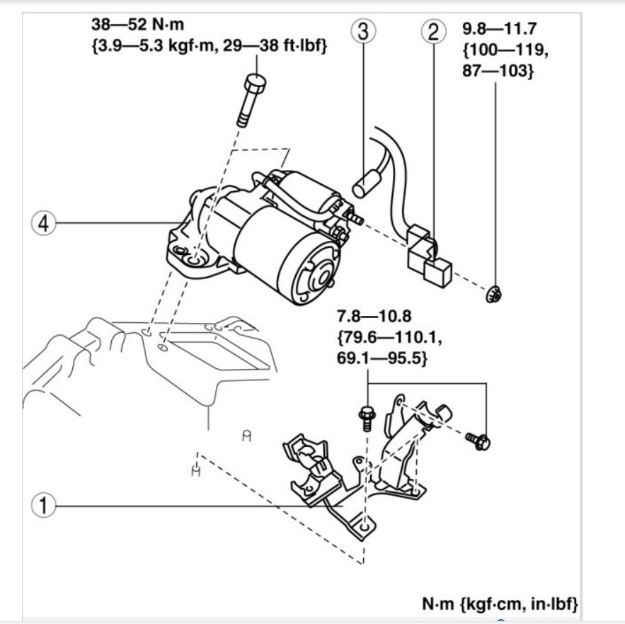

It might be, can you upload images of what you are seeing so I can tell what's going on, so that I can help you fix it. Also, you may have a defective starter. Can I ask what brand you are using? You can confirm the starter being bad if you use a test light on the trigger wire while you have a helper turn the key to the start position. This guide can help as well:

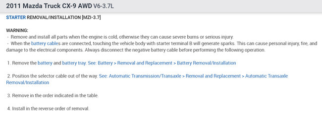

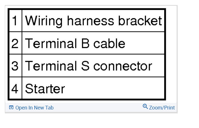

I have included the starter replacement instructions which show the trigger wire you need to test #3. Also do you have a security light flashing? Check out the diagrams (below). Please let us know what happens.
