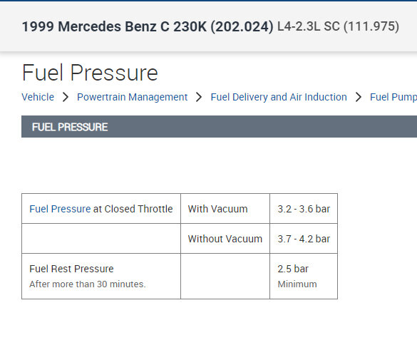

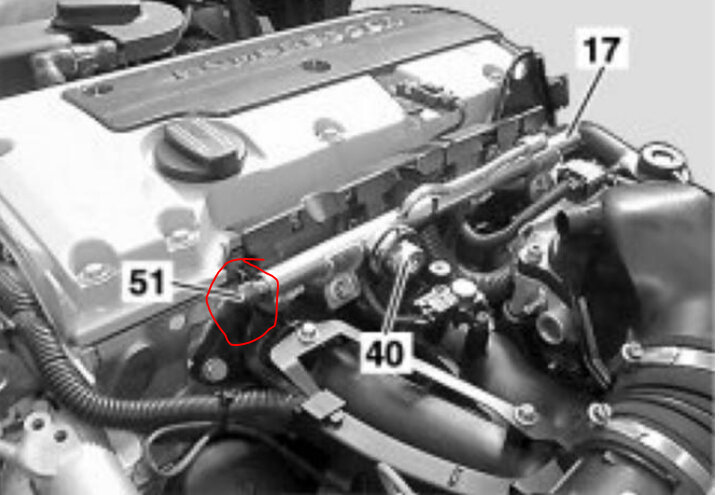

I thought it was the battery, so I bought a new battery but now after running the engine is revving up and down and then slowly begins to shut off and when that happens I pump the gas and it acts as though it’s getting no gas at all and then shuts off.
Feb 23, 2024 at 12:30 PM
  • 110,248 POSTS
Based on your description, it sounds like it is running out of fuel. Have you checked the fuel pressure to see if it is low/weak? If you haven't that is where I recommend starting. Here is a link that explains how, in general, to check fuel pressure:
You will need a fuel pressure gauge for this, but most parts stores will lend one to you.
If you look at pic 1 below, I circled where the fuel pressure gauge will attach. Pic 2 shows the manufacturer's fuel pressure specifications.
Let me know if you are comfortable performing this procedure or if you have other questions.
