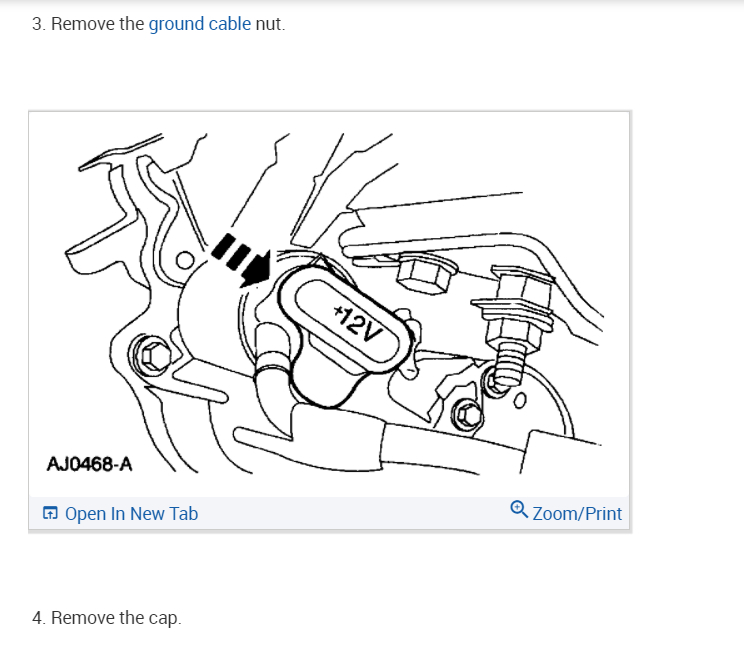

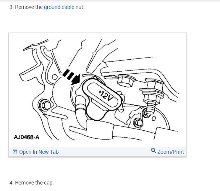

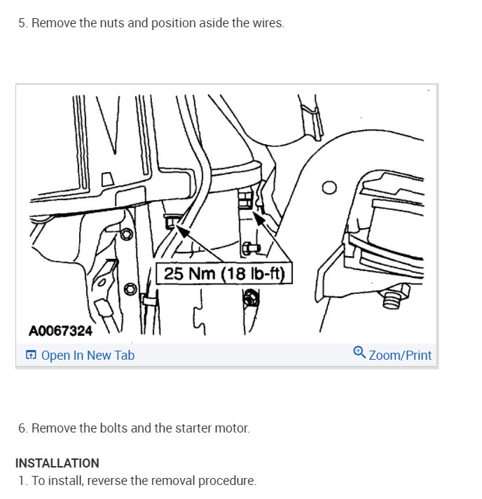

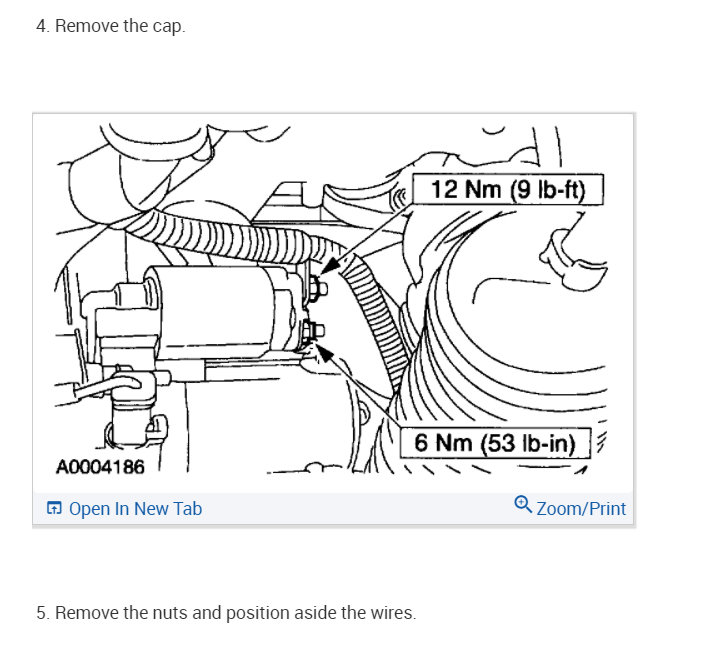

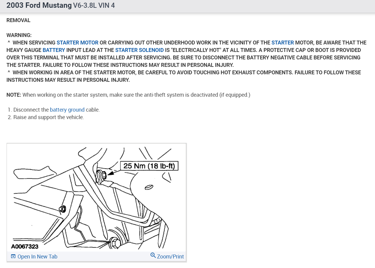

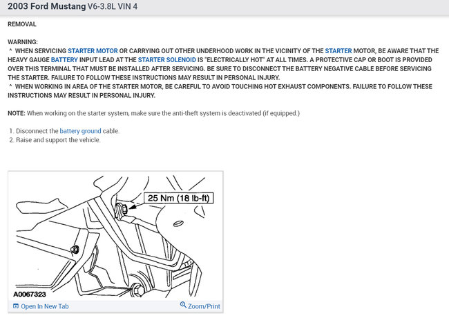

What kind of noise is it making? It sounds like it could be a bad starter, but this guide can help us confirm the issue:
Here is a guide to help you change the starter out with diagrams below to show you how on your car:
