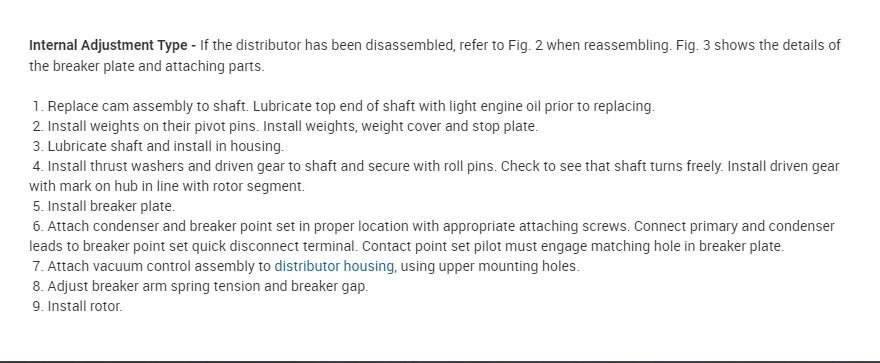

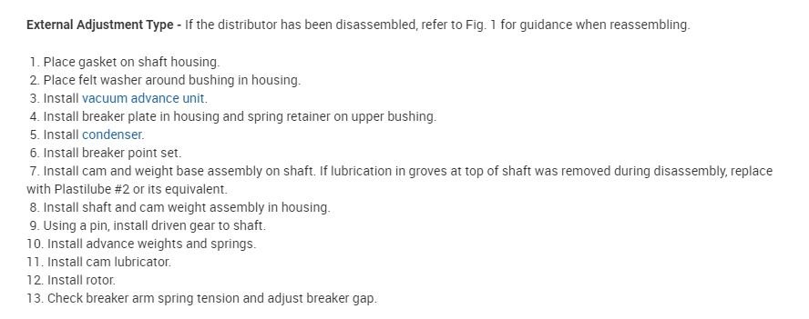

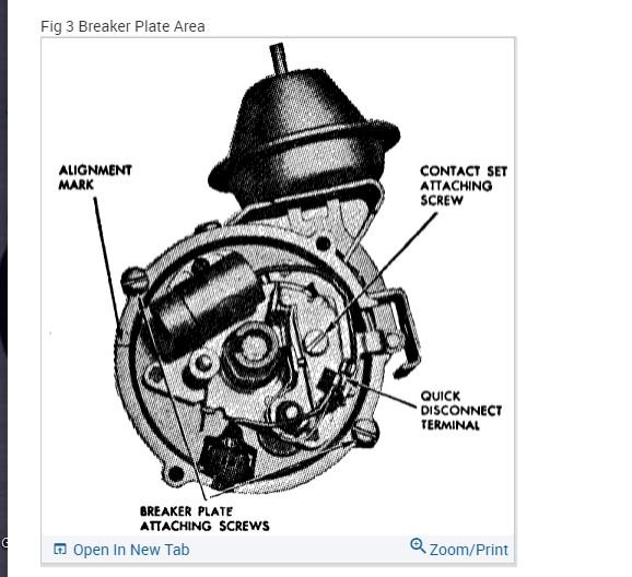

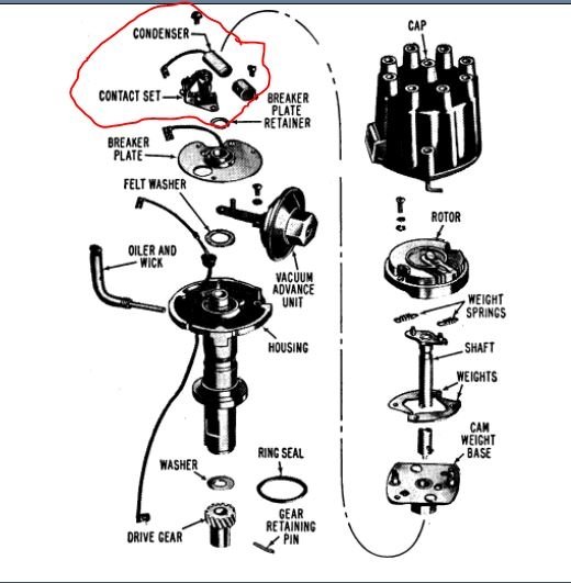

Good afternoon,
I would start by replacing the points and condenser in the distributor. You may have a bad condenser not allowing spark. Most parts stores still carry these parts, and they are cheap.
I attached a picture of the distributor with the pieces you need. The point gap is .018 on the high point of the cam.
