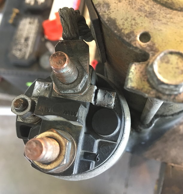

My car will not crank sometimes. When this happens you can try to start it a number of times and it will still not crank. Come back in a few minutes and it will start with no problem. You may go a week without any problems and then problem returns. Engine can be hot or cold from over night and this makes no difference to when problem occurs. My neighbor also has a Buick with the same problem. He replaced the starter (new starter not rebuilt) and still has the problem.
Battery has been replaced and contacts cleaned.
Commutator interrupter switch has been replaced (part of ignition switch, not a easy job to replace).
Security light is working correctly, security key okay.
Dash lights, radio, A/C – heat fan, head lights, etc., work correctly.
Starter has been checked by local auto parts store a few times.
Getting twelve plus volts to starter solenoid.
Connected a Mallory Sonalert to the twelve plus volt starter solenoid wire so that you can hear when car will not crank. so I know I am getting the voltage to the solenoid.

When you do your testing, use the engine block for the ground point for any test equipment. Measure the voltage on the large cable on the starter solenoid. You should find twelve plus volts there all the time, but it will get drawn down to around ten volts during normal cranking. If that drops to zero volts when trying to crank the engine, that cable has a bad connection, but the clue is you will hear the single, rather loud clunk of the starter solenoid. If that voltage drops to zero volts and you do not hear the solenoid, suspect the ground cable has a bad connection. Typically the strands of wire corrode away under the insulation where it is not easy to spot.

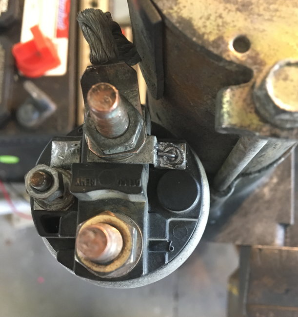

After reading your reply and more investigation into the problem, I think the problem has been resolved. I always have the voltage at the starter solenoid when I try to start the car and the solenoid does not engage. Checked the ground cable with an ohm meter and moved the cable around to check for high resistance, looks ok. Disconnected the battery and then removed the starter solenoid assembly to bench test assembly. Was able to get the loud clunk of the starter solenoid as it engaged the bendix and the starter worked correctly. Suspecting a problem with the solenoid I took a resistance check of the solenoid coil. Resistance looked ok but then I noticed a cold solder connection on the coil wire. See photos of the problem found.
Cold solder connection to right of large bolt to starter.
Cold solder removed to show solenoid coil wire not soldered to terminal. The small coil wire is just bent over the terminal. I’m sure this is the problem as this would cause an open coil wire from time to time. Soldered the connection (forgot to take picture) and checked operation on the bench and then installed the starter assembly in the car. Seeing how the problem was intermittent, it will take a few weeks to prove this was the only problem. This is a problem you would not expect to find, but you never know what you will find with an intermittent electrical problem that happens once or twice a month.

Dandy. I've done similar things with Ford's fender-mounted solenoids to create "bugs" for my students to diagnose. You found what they could find after four weeks of classes.
As a side note, resistance tests are only good to verify you found a problem or to check for a completely broken connection. In high-current circuits like this one, resistance readings aren't that useful. A starter can draw up to 300 amps to get started spinning, and then it will drop to 150 amps or less. The entire system will be rendered ineffective if there is as little as .04 ohms total in the ground cable and starter cable. That is WAY too small to measure, but we can measure the results of that resistance with voltage drop tests. Your meter's leads will have two to five ohms of resistance which adds to the confusion.
Very happy to hear you solved this.
