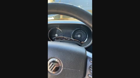

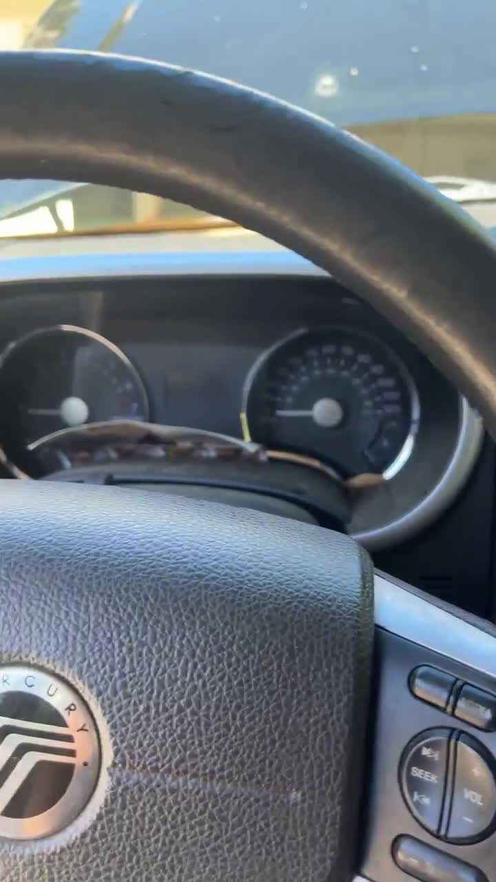

Every time I try to start the car it won’t start. I turn the ignition on, but the instrument cluster won’t power on, but the radio powers on. In need of help. Triple A said is probably my starter which I don’t believe. Can someone help?

When I turn the ignition, I do hear a click, but it doesn’t crank. The instrumental cluster is not powering on. Radio works, Headlights work, Turn Signals work, Windshield wiper works, and A/C works. The battery is brand new which I purchased it like 3 months ago. I tried to jumpstart with another car, and it didn’t work. Even Triple A tried to jump it too. Triple A said it might be my starter which I don’t believe. Thank you for replying.

If there wasn't an issue with the cluster, I may say the same thing, the starter. However, I suspect it has something to do with the PATS system. (Passive anti-theft system). By chance, do you have a spare key you could try?

I think it’s not the anti-theft system if it is, would the red-light blink fast? It’s not blinking but staying red.

If the light is flashing or solid and doesn't turn off, it is likely related. What happens is this. If the light doesn't turn off or flashes, the fuel injectors and, or the starter will become inoperative. If it turns off, it isn't the PATS system. If I understand correctly, in this case, it doesn't turn off.
