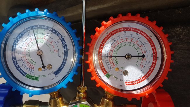

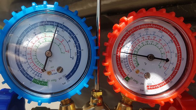

Did my measurement. I will post pictures here. There is a picture with engine off and engine on warm with AC full blast.
Jun 30, 2019 at 3:01 AM
Was the compressor on when the engine was running? The fact the pressures are the same tells me the compressor is no good as it is not building any pressure.
Jun 30, 2019 at 3:04 AM
BDHAMILTON
  • 7 POSTS
Compressor was runing. Seems like the low side went up and high stayed about the same. Is there a beat practices way to conduct the test?
Jun 30, 2019 at 3:10 AM
You have done the test. If the compressor was running and those were the pressures, then the compressor is bad.
You will need to replace the compressor and the dryer, vacuum it down for 30 minutes and then charge.
Jun 30, 2019 at 3:15 AM
