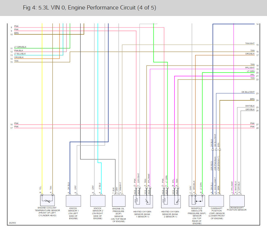

It sounds like you have 3 problems here. first the bank 1 sensor 2 heater circuit oxygen sensor needs to be replaced, the throttle issue is because the PCM is going into limp mode due to a dirty throttle bore and finally the EVAP leak could be the supply line to the purge solenoid. here are three guides to help fix all three problems:

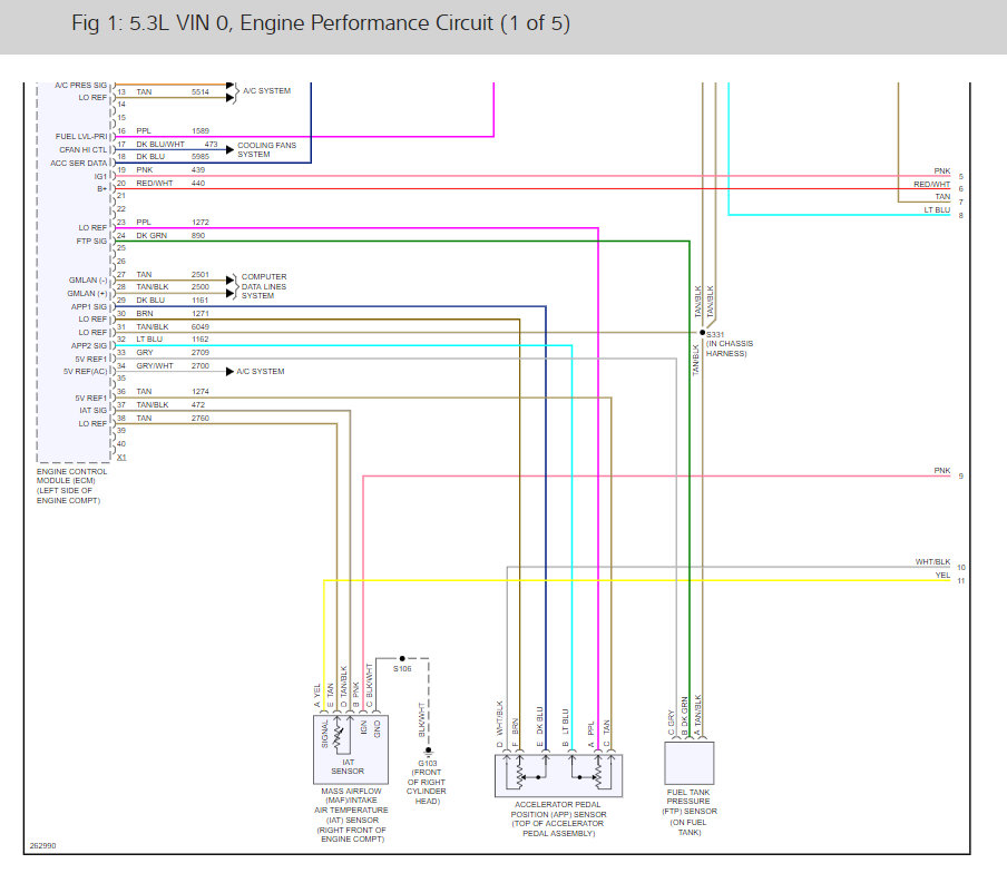

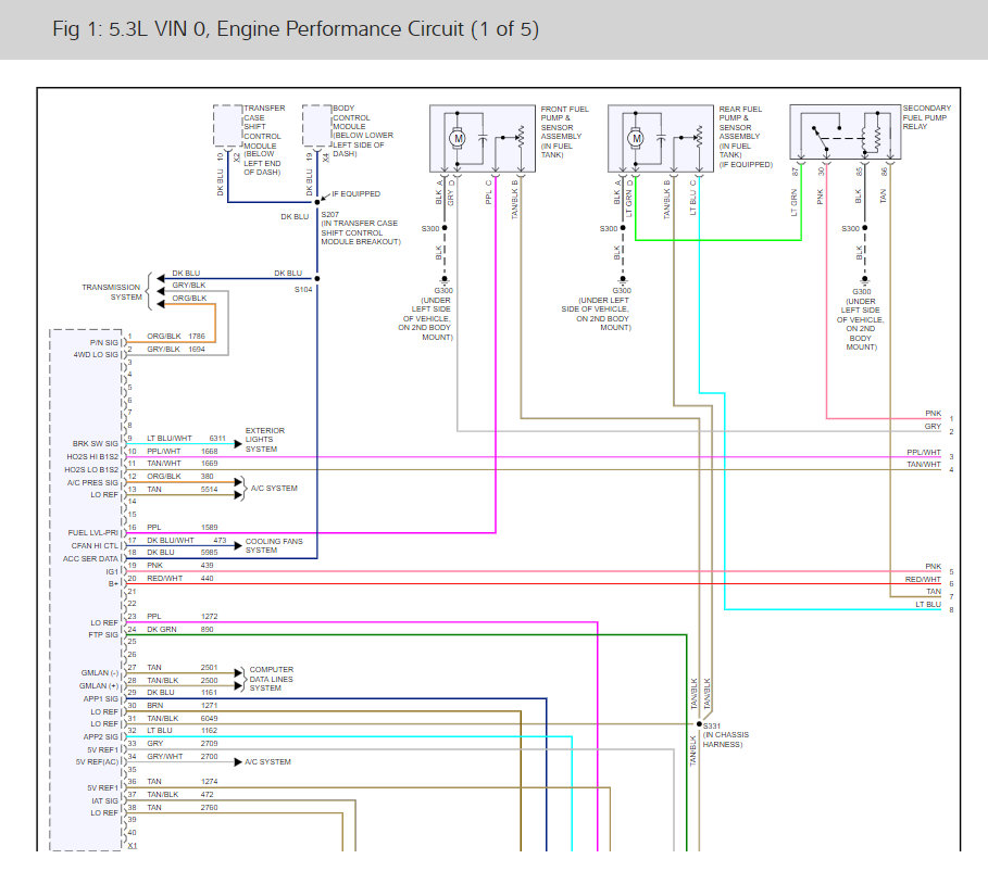

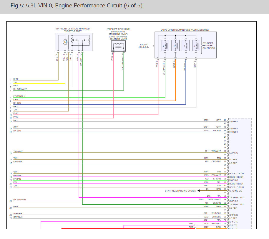

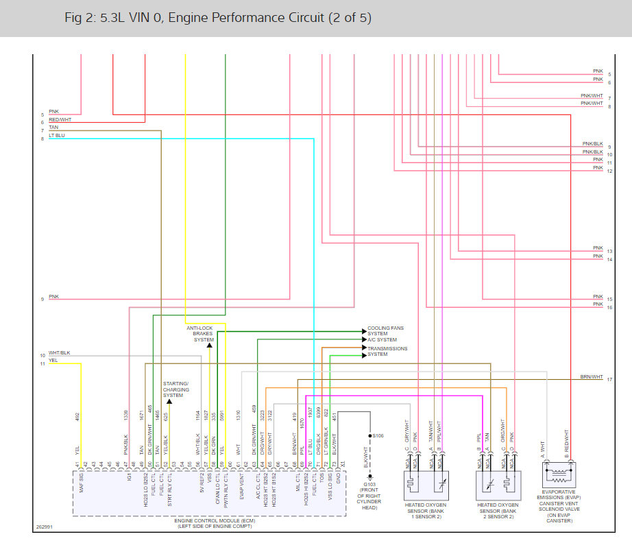

The next step is to check the oxygen wiring. here is a guide and the wiring diagrams so you can see how the system works and which wires to test:
Have you serviced the throttle bore? Check out the diagrams (below). Please run this test and get back to us.

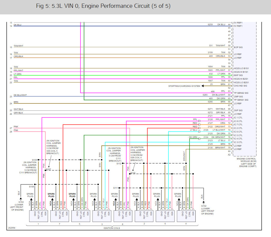

It sounds like you have a fault in the 5V reference circuit so which would cause you to lose power to the accelerator position sensor. If you are having this fault intermittently you may have a short somewhere causing the 5V reference to drop out. The fault you are experiencing seems to be throttle control related.
I would not advise suspecting the PCM at this stage.
