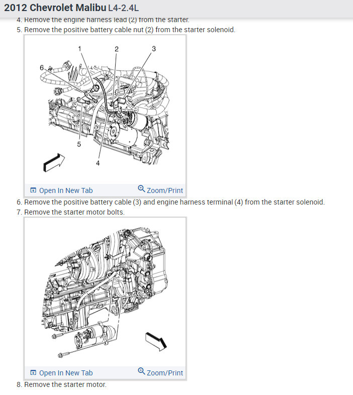

A no start can happen for either lack of spark or lack of fuel or both.

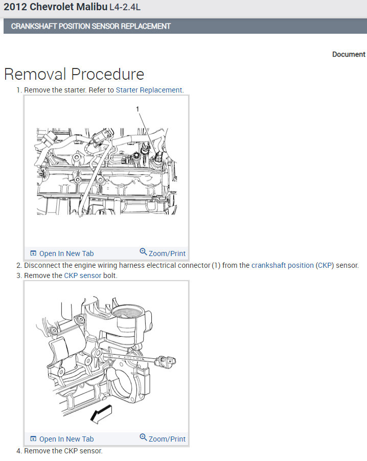

It almost sounds like a faulty crank position sensor.
Many times when the crank sensor goes bad the engine will stall while you are driving and typically cannot be restarted. It will crank but will not start back up.
Is your check engine light on?
If so do you know what are the codes? It could point us to the right direction.
https://youtu.be/vMwTzURWXmk

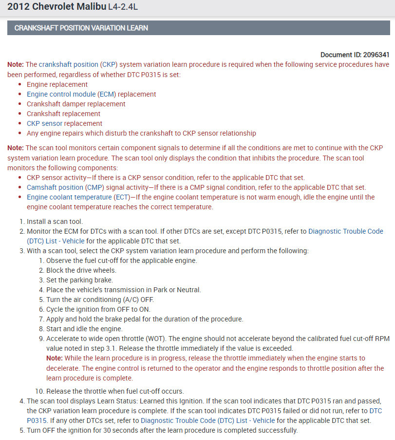

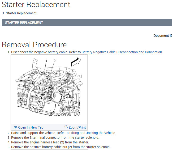

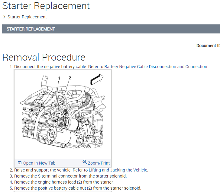

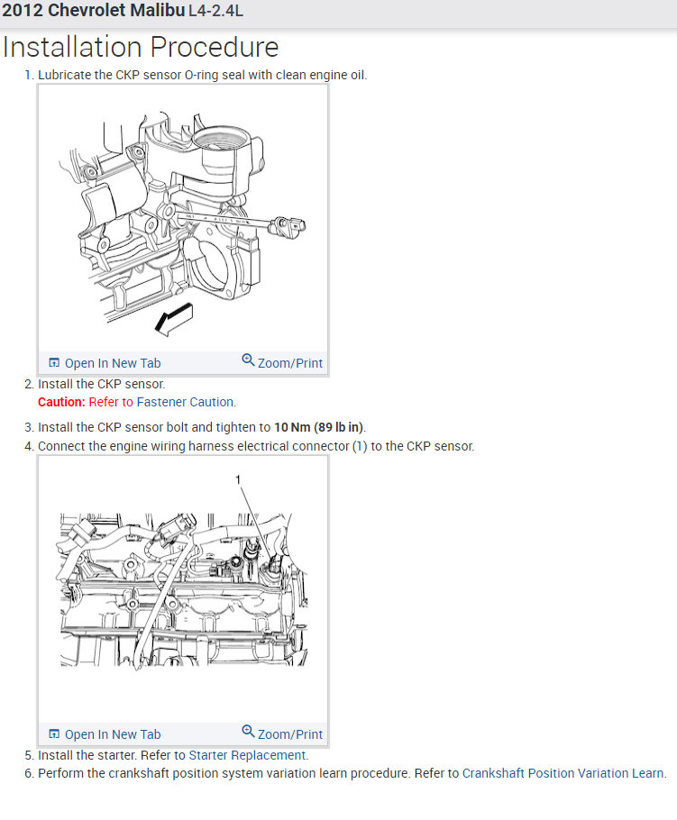

Couple of helpful articles:
I have attached the crank replacement procedure for your reference.
Please let me know if you have any trouble codes.
