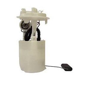

A week or so ago I technically ran the car empty, technically in that gauge still showed 5 miles to empty but due to parking on an incline I suppose it was enough the car could not pull any fuel. Added some diesel maybe a gallon at most and car started perfectly. I stopped to get more fuel and drove home (20-mile trip) without incident or signs anything was wrong. The next morning the car just turned over and over but no start. I checked all fuses first and even replaced the fuel filter that I already had on hand just in case. I've cycled my ignition many times to prime and still no dice. More or less ignorant when it comes to cars, but I can work through most repairs but major engine repairs and the fuel system I've never had to address.

It sounds like you might have a problem with the in-tank pre delivery fuel pump. Running the fuel tank empty most likely damaged the fuel pump.
A quick check is to cycle the ignition and listen for the in-tank fuel pump to energize. A normal pump will emit a light buzzing noise. A damaged pump will either hum load or will not switch on at all.

See below picture how the pump looks like.
