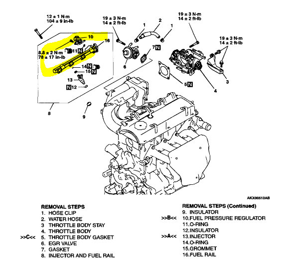

Here's the update on the transmission and car in general. 6 months ago, we replaced my intake manifold with a junkyard part and that went out completely (it broke off entirely where it connects to the throttle body). Thankfully, this happened at my mechanic's when I was getting the brakes done. I had noticed while driving in the mountains that weekend before that it started shifting really strangely, the RPMs would increase upwards at the end of the shift, like the transmission was slipping. So, I thought the transmission had gotten worse. Anyway, we replaced the intake manifold with a brand-new old stock OEM intake manifold, and all my shifting issues went away. It's shifting like a dream now. I haven't had the shift solenoid code again, and I think we found the culprit of the P0442 code (fuel pressure regulator is leaking, which I ordered a new one).
The only remaining issue is the same low idle problems I've fought for like 8 years now. When the mechanic put my car back together, he reset the base idle speed screw to its default position. So early yesterday morning I was sitting at about 400 RPMs, and it was trying to stall out on me. So, I got a Phillips screwdriver and loosened the BISS a few turns and raised the idle about 300 RPMs. This is kind of a hacky way to fix it, but it at least keeps it from stalling out (this is what we had to do six months ago to stop this issue as well). The most recent thing I did to try and fix this was replacing the Engine Coolant Temperature Sensor, but the issue still persists. I've already replaced the IAC and TPS multiple times. I know for sure the TPS is good, I may try replacing the IAC again. Anyway, this just seems to be some design flaw with these cars. I've seen a ton of threads about the low idle problems in the 2001 through 2005 Eclipses, and never seemed to see any actual resolutions added to the threads. It's my theory that it's these low idle stalling issues along with the intake manifold failures that's causing so many of these cars to end up in junkyards. Anyway, as always thanks for your help and take care.

Thanks for the update. I'm glad to hear the transmission wasn't the issue. As far as the low idle, wait until you get the new pressure regulator. That may fix the issue.
The regulator is on the fuel rail. I attached a pic below and highlighted it.
Let me know if that takes care of the low idle issue.
See pic below.
