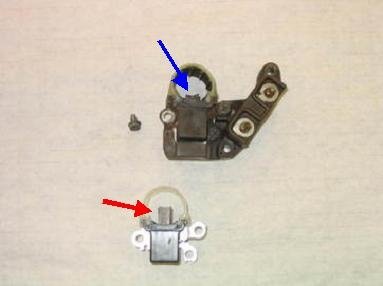

Diodes almost always fail permanently and can be identified during testing. Intermittent problems like you described are typical of worn brushes and those always start out that way and get gradually worse over the next few months. Most people replace the alternator for this problem, but it is possible to replace the brushes. On some Chrysler engines that can be done without even taking the alternator off. The brush assembly costs around 12 bucks.

Yup, what you're describing is exactly what a failing alternator can cause. The most common failure on Chrysler alternators is worn brushes, and those always start out by making intermittent contact. When the problem occurs, it can take a few minutes for the battery's voltage to drop enough for the first computer to act up. You have dozens of computers, and one by one more of them will start to shut down and / or do weird things. The brushes can suddenly start to make contact again making the alternator start working again and recharging the battery. Typically the brushes will wear enough for this to become a permanent failure within the next month or two.
I've included a photo from my web site of the Nippendenso alternator brush assembly. The pretty blue arrow shows the worn brushes. The nifty red arrow shows what they look like on the new assembly.
