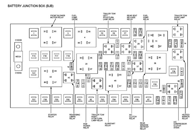

After I take the key out, the engine continues to attempt to crank over?

Okay, so, if I try and start the car the car tries to turn over but doesn't, but even after I take the key out the car wants to continue to try and turn over until I disconnect the battery.

You have a starter relay that needs to be changed. here is the location in the fuse panel under the hood. Check out the diagrams (below). Please let us know if you need anything else to get the problem fixed.
