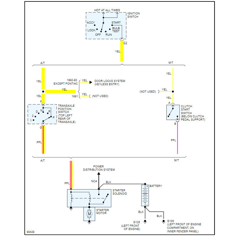

Car tries to start but won't fire up.
Dec 17, 2020 at 6:46 AM
Good evening,
Does the engine turn when you try to start or does it do nothing?
If it cranks over, you need fuel pressure, compression and spark. I attached some guides for you to follow.

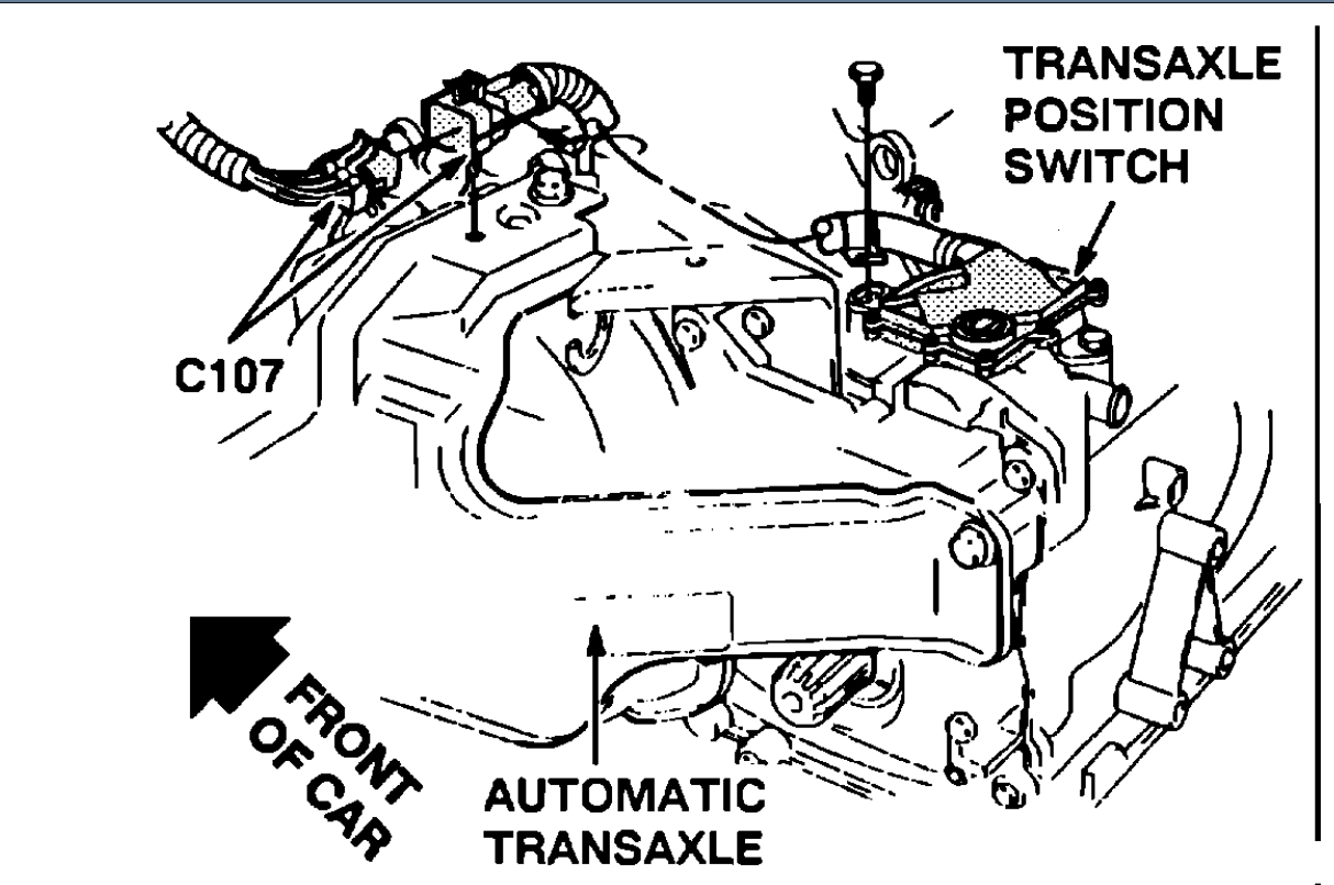

I attached a wiring diagram of the starter system as well.
REMOVAL
1. Disconnect negative battery cable.
2. Disconnect shift linkage.
3. Disconnect electrical connector.
4. Remove mounting bolts.
5. Remove switch assembly.
INSTALLATION
1. Place shift shaft in "Neutral."
2. Align flats of shift shaft with switch.
3. Install mounting bolts, loosely.
4. Insert gage pin in service adjustment hole and rotate switch until pin drops in to a depth of 9.0 mm (9/64").
5. Tighten bolts to 24 N-m (18 lbs.ft.).
