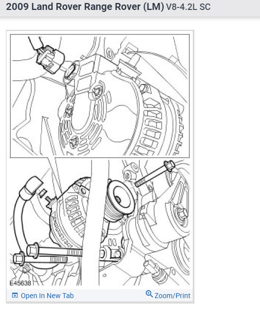

Lost power while driving car shut completely down, battery is excellent, will power up and start when connect battery jumper cable from battery post to hot wire post to under the hood fuse box, will shut down when I disconnect the jumper cables.
May 30, 2022 at 8:49 PM
SQM
  • CERTIFIED EXPERT
  • 6,383 POSTS

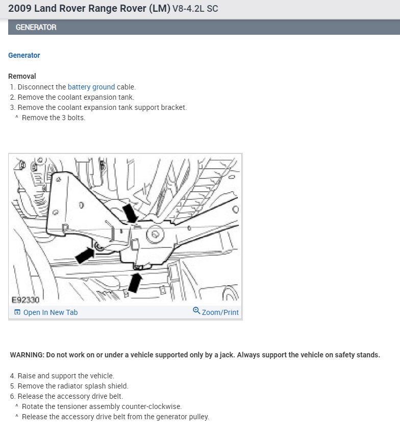

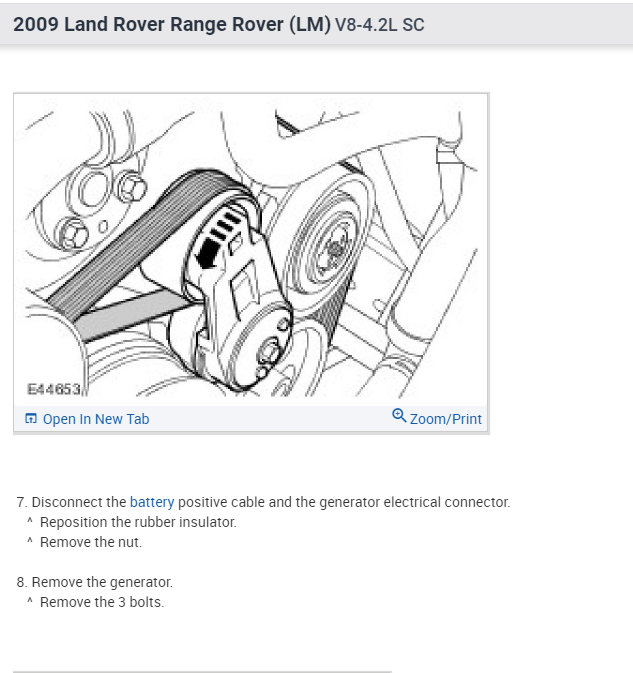

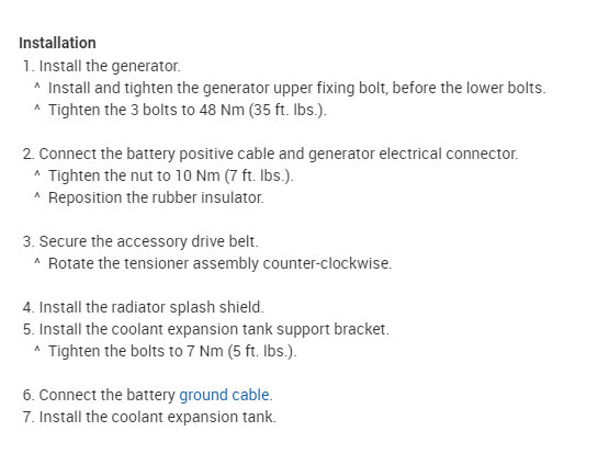

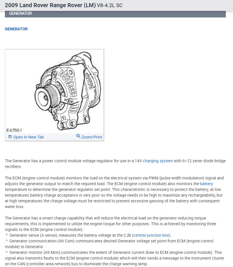

It sounds like the issue could be that the alternator is not providing adequate charge to keep the engine running.
Typically, with a bad alternator the engine can stall, usually when coming to a stop and you won't be able to start it back up. And jump starting will start the engine but will shut down when the jumper cables are disconnected.
https://www.2carpros.com/articles/how-to-replace-an-alternator
I have attached diagrams below for your reference.
Let me know of any questions.

You might want to get the alternator tested. It does sound like a faulty alternator. If the alternator tests out good, then you are looking at wiring issues.
