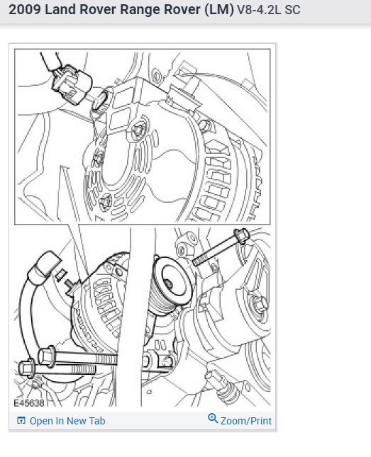

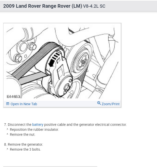

I have attached diagrams below for your reference.
Let me know of any questions.
