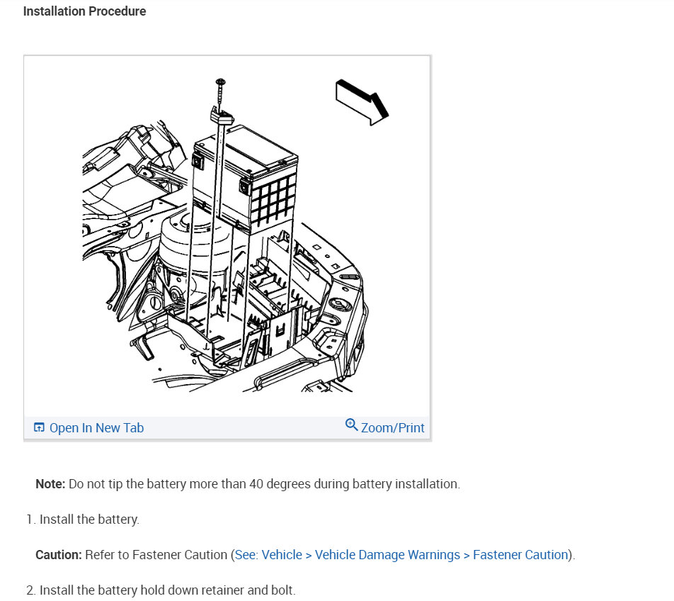

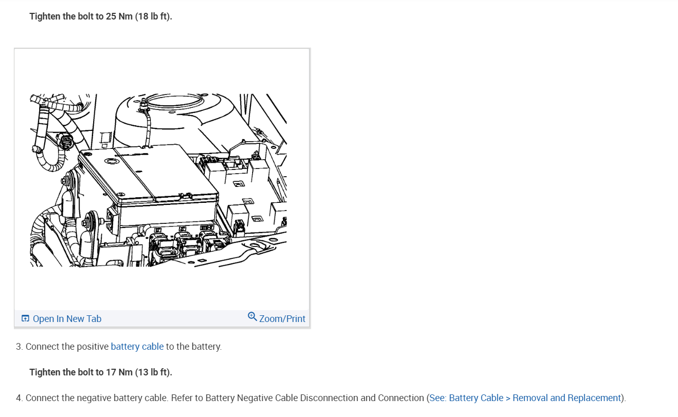

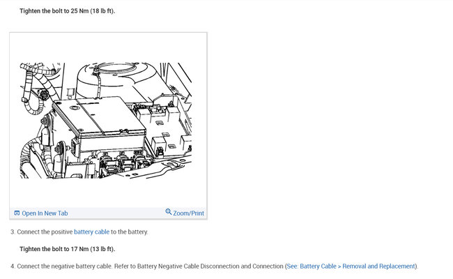

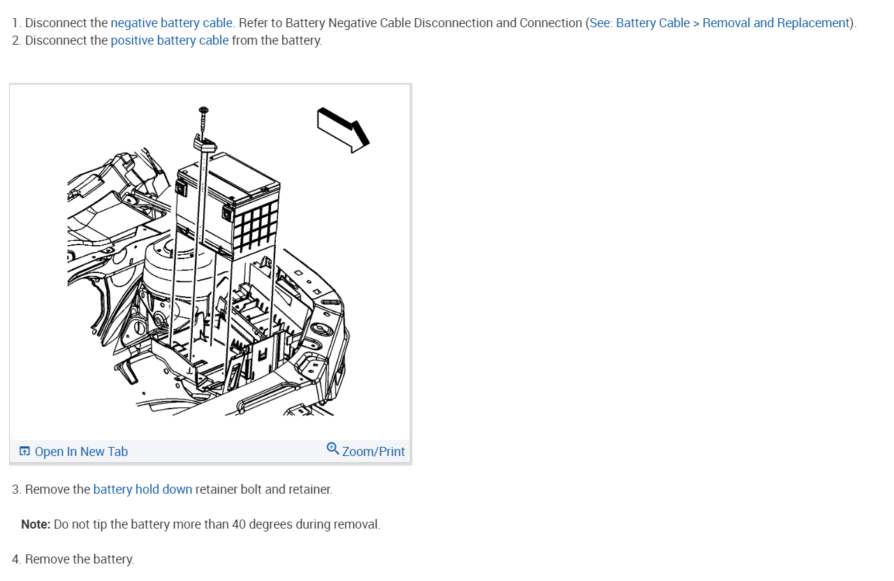

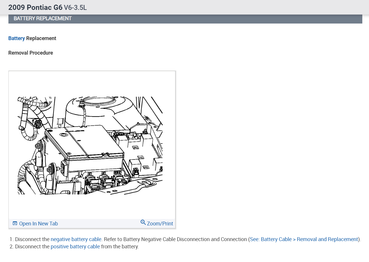

It sounds like the battery is no good but to be sure check this link out to load test the battery without test equipment, I have also included instructions on how to change the battery out just in case you need it.
Check out the images (below). Please let us know if you need anything else to get the problem fixed.
